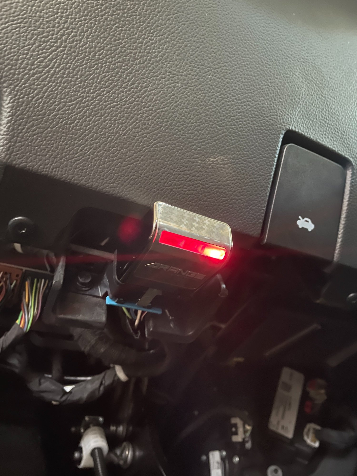

Yeah I know a lot of people go that route but I’ve never been into the tuning thing. Tried the pedal commander only because when it’s unplugged it’s gone. And now trying this to see what difference it makes in how the truck behaves w/o dropping to/from V4 all the time. But again only because when it’s unplugged it’s gone. My mods usually stop shot of altering the computers haha. -

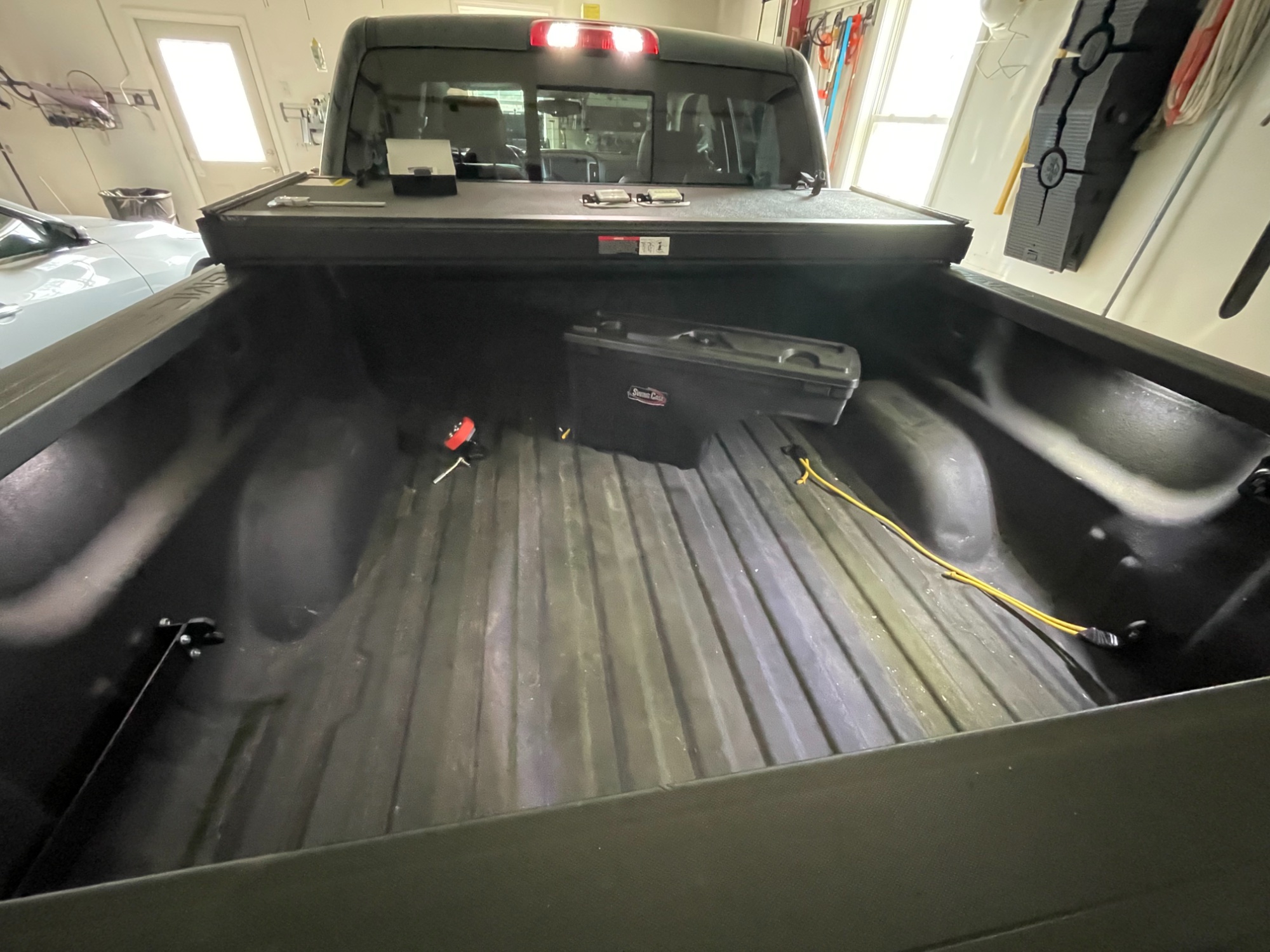

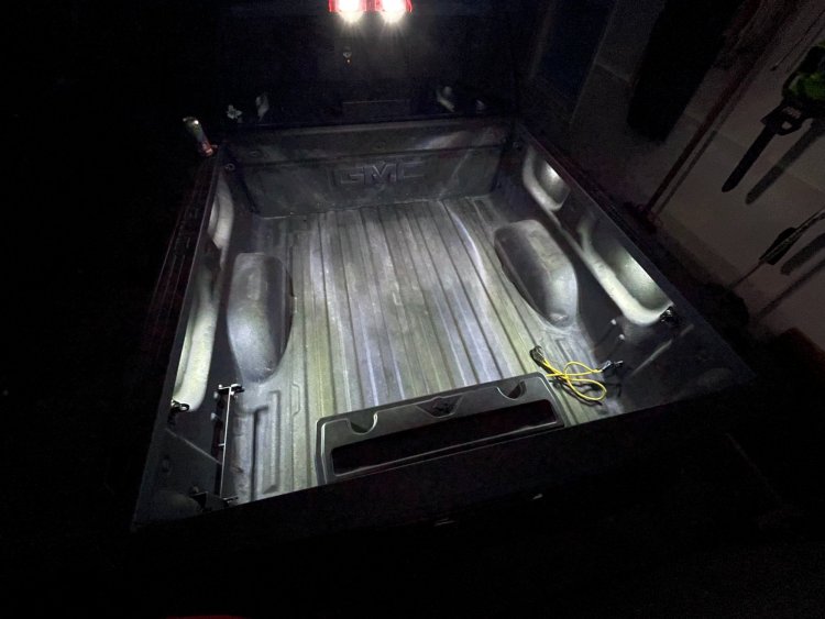

Last 2. First one is just the open bed, 2nd one is under the tonneau. Oh, also don't spill your beer during all of this!!! -

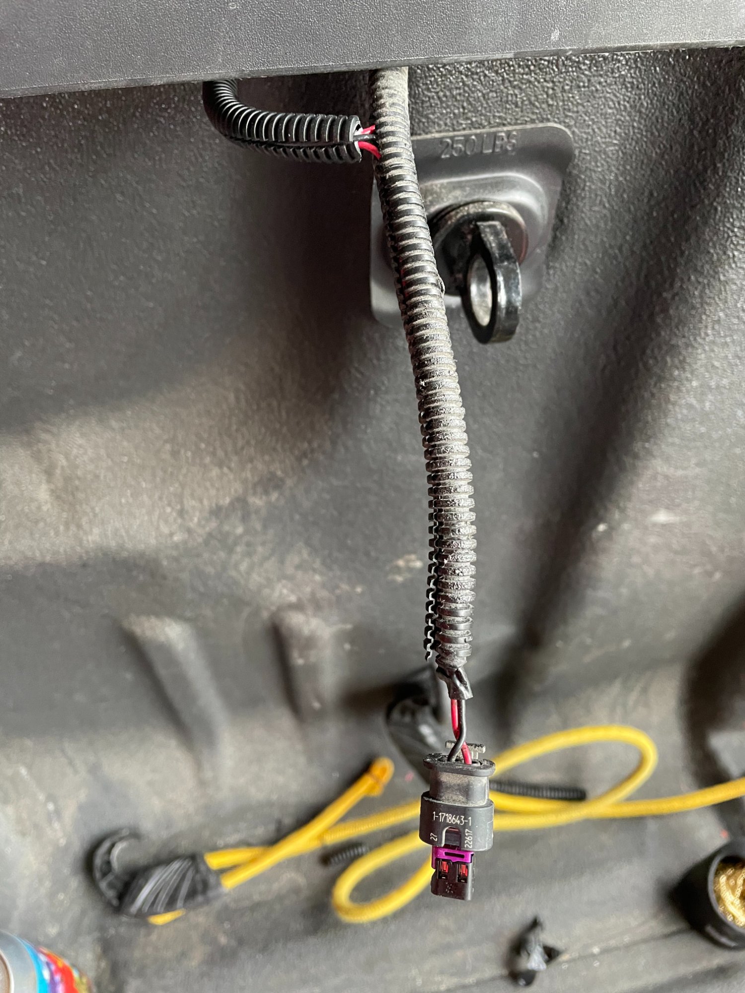

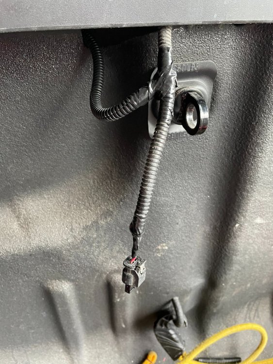

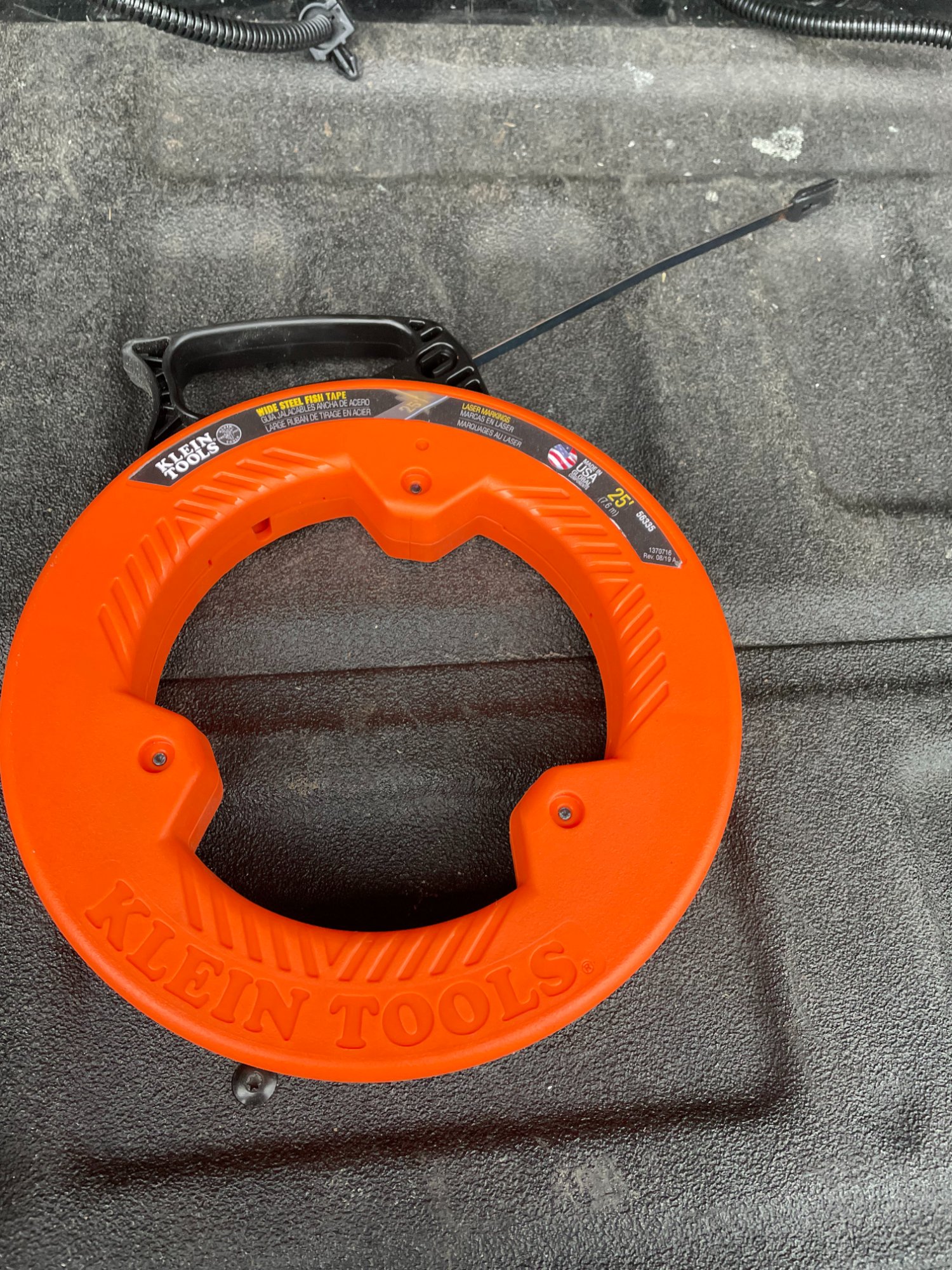

ok so i finally got that harness and got around to adding the 2 OEM LED bed lights to the front end of the bed. (In retrospect i probably could have asked Phil to make the 2 pigtails, but not sure if it would have been worth it to him or me... the whole harness for the bed lighting (OEM) was only $29 and i cut what i needed and it worked out perfectly.). anywhozzle it came out great and i think i AM gonna buy 2 more of the super bright Amazon ones i posted a while back... so i got the harness, an electrical fish tape that i have (key not just for mods like this but if you're a home owner in gen.) now, i soldered the wires, as i prefer that but you could probly use T-taps if you want... its under the bed rails so not really gonna see weather esp if you have a topper or a tonneau. Installed the lights in the flats spots at the front of the bed first, similar to the spot they're in at the back but they dont have raised sections and holes... i used self-tapping screws and it seems fine. a little patience needed getting up under the bed rail. Then i fished the harness thru from the light to the back where i was gonna splice, plugged in the front lights and drilled 1 hole to add one of those plastic harness retainers. pulled the existing circuit out of the wire loom, and the first pair i just cut and soldered them all, wrapped with tape (and in the open end i just put a little silicone... probly overkill tho.) tucked them back into the loom and taped that up, and pushed it back into the bed rail and plugged it back in. on the driver's side i decided to just strip the existing wires and splice in, it was a little cleaner. taped, pushed into the loom and the bed rail and plugged back in, tested and it looks great (these are the old OEM 2-LED at the front currently) -

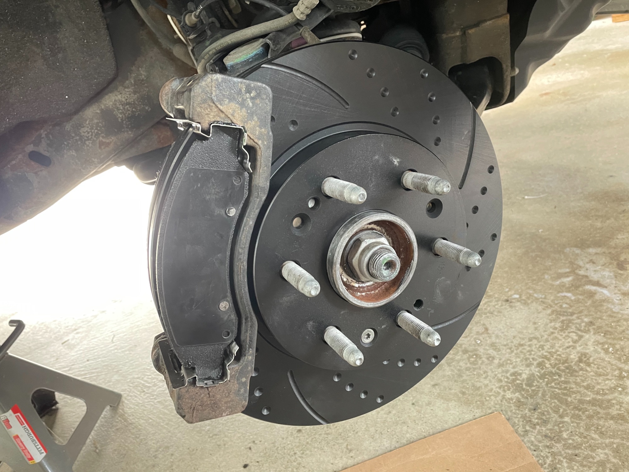

Got three wheels done today, last one tomorrow morning. The caliper bracket bolts on these things are crazy torqued! 170lbs-ft in the front and 148lbs-ft in the back. Not alotta room in there for leverage. Anyways, went with some dimpled and slotted black zinc coated rotors (lifetime guarantee against warping and cracking) and ceramic pads from brakeperformance.com -

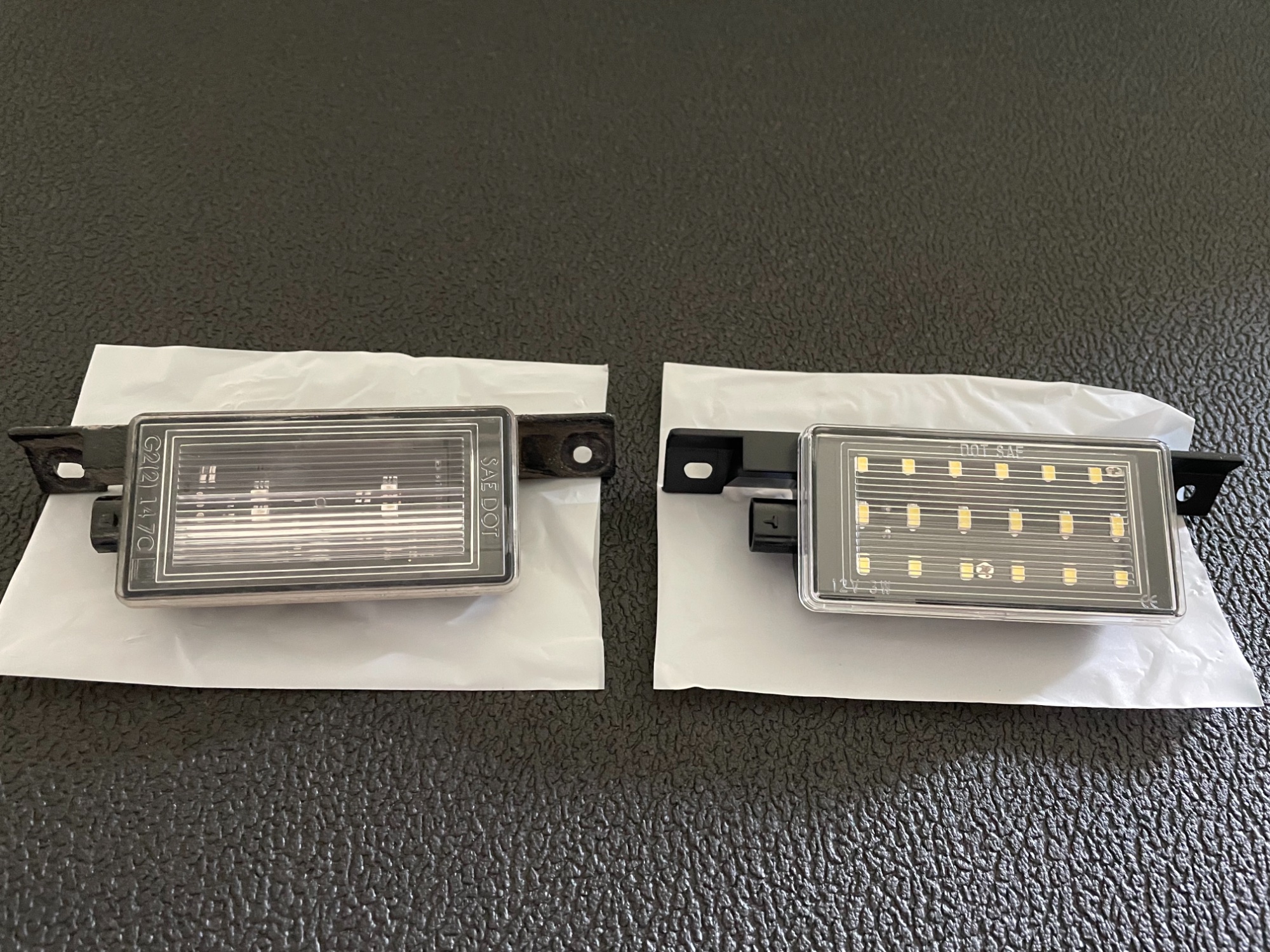

Been lookin at some of the bed light threads. I have the factory ones and they’re LED, but nothing really bright. And I have a swing case which blocks a lot of that light on the drivers side. Found these things on the Amazons and they are an 18 led version of our oem (2 led) ones. Oem are on the left in the pic. Only $20 tho and they got here in a day. NDRUSH LED Truck Bed Light, Clear... https://www.amazon.com/dp/B08MQ8WVWV?ref=ppx_pop_mob_ap_share Tuff to tell in the daylight but this is with the passenger side installed and driver still Oem with the swing case out of the way. WAY brighter. They fit perfectly, both the space, screw holes AND the factory pigtail plugs in and clicks nice and snug. You just reuse the two 7mm screws already in there. My ultimate plan is to get a couple more of these factory plugs and install the oem ones further toward the front and splice them on. But for $20 I may just buy another set of the Amazon ones and ditch the oem altogether. We’ll see how it goes. I’ll do the oem add on first. Finding the factory connectors is gonna be a yotch tho. Might have to buy the whole harness just to get those. -

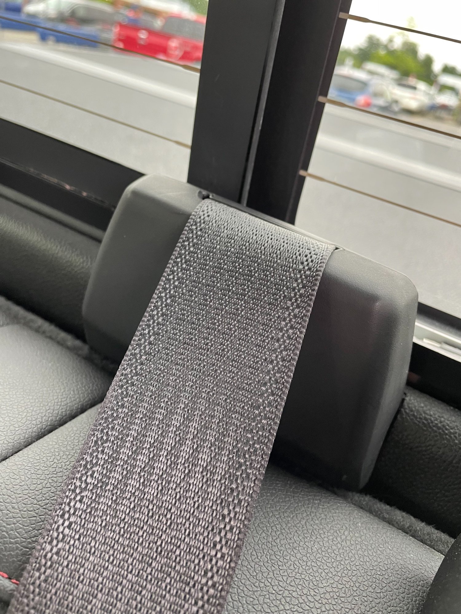

Fought with this stupid thing for the 1000th time after putting the seat up and back down to get something out of the storage bin. Is there anything you guys have done to this “part” to keep it from lifting and splitting EVERY gd time you lift the seat bottom up??? -
