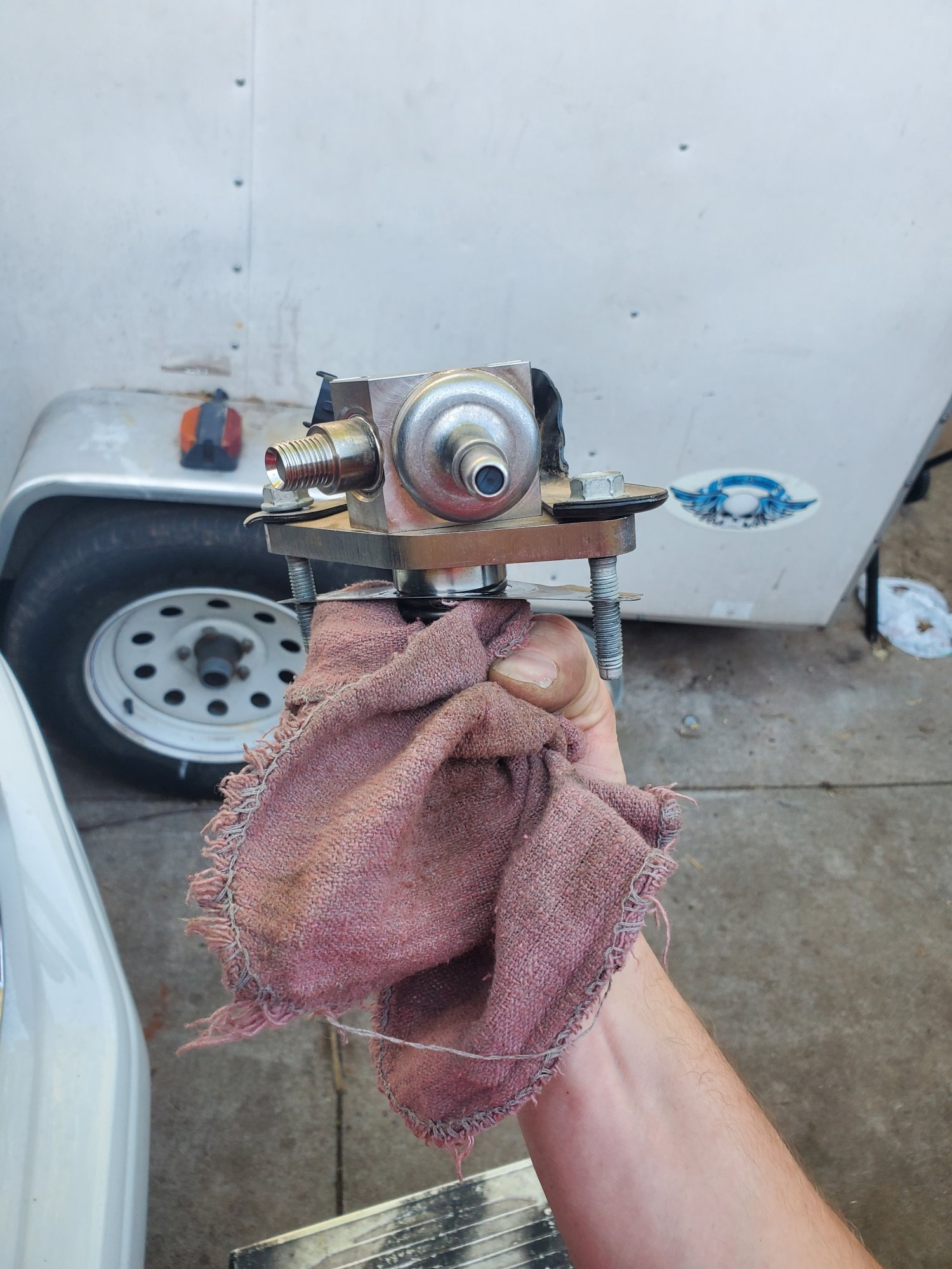

  1. Selling the stock high flow fuel pump and stock injectors off of my 2018 GMC Sierra 5.3 V8. I supercharged the truck and upgraded the fuel pump and injectors. The truck had18,000 miles on it when I removed them. I honestly don't know their worth and did some online searching and I think I would like to sell the fuel pump for 175$ and set of 8 injectors for 300$ if those prices are unreasonable make an offer! I will update this post with part #s shortly and more pictures.

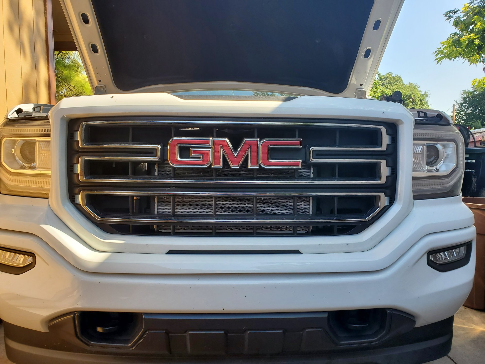

  3. Got the new heat exchanger on. Haven't got to test it because my pump is air locked. I have been trying all day to get it to work to no avail. I have to drive around and let the coolant sink and fill it up and do it all over again until the coolant stops going down. Shouldn't take more than a day or two. Its not perfectly centered but close enough

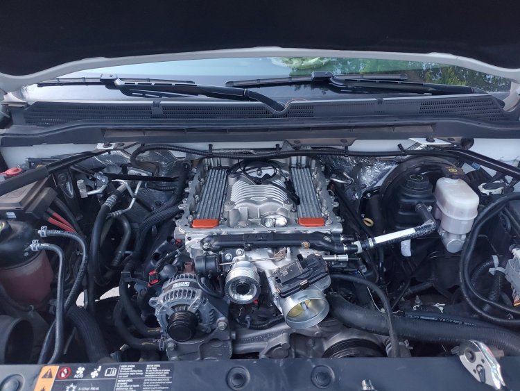

  11. Its alive! Trying to get tune dialed in now! Man does it get hot under the engine bay now!

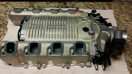

  12. Made progress but wasn't able to finish due to a unforeseen issue no one had ever made me aware of. A metal sleeve on the bottom of the sc had to be grinded down to allow the sc to sit flush on ict adapters. The metal sleeve is ehere the red arrow is pointing.

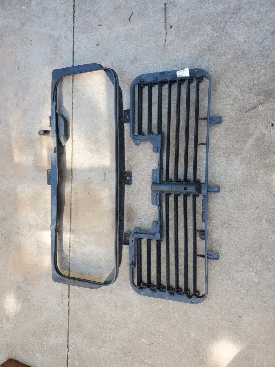

  14. I had no idea that these trucks had active air shutters lol! I had to remove mine for the heat exchanger.

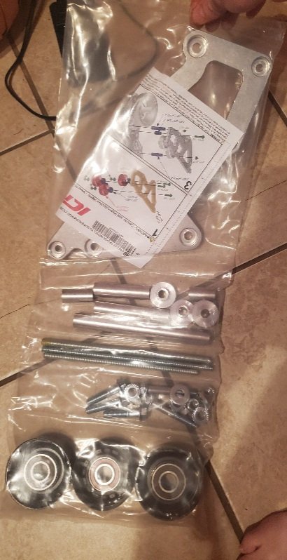

  17. I hope to get some work done this weekend! I will install heat exchanger and IC pump and run all the coolant lines. Im going to wait on mounting the supercharger until I have help that sucker is heavy and can easily bend or crush fuel lines and such.

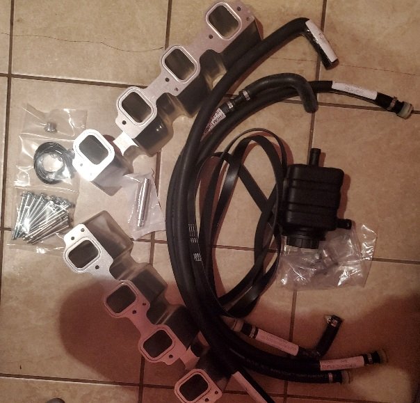

  18. Last round of parts have came in. Gathering parts is finally done. Ict billet tall adapter plates, ADM intercooler truck hose kit and adm supercharger belt. Belt is really long! 98 inches total i believe.

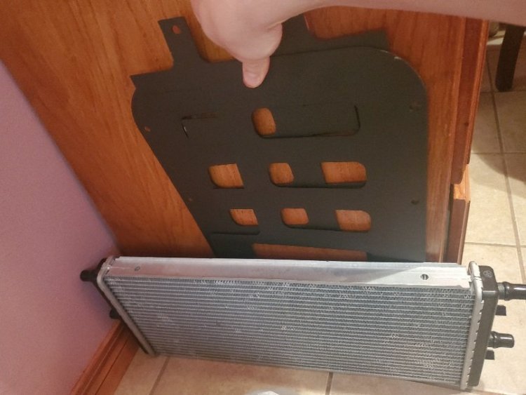

  20. Z06 heat exchanger and mounts are in from ADM! The heat exchanger mounts right behind the grill with the provided mounts. Also received the ICT billet ilder pulleys/bracket. I will install the heat exchanger this weekend and install the IC pump and coolant hoses. Im going to just install everything without providing any power to the pump. Im trying to install all the parts step by step so when it comes time I just install the blower and go!
