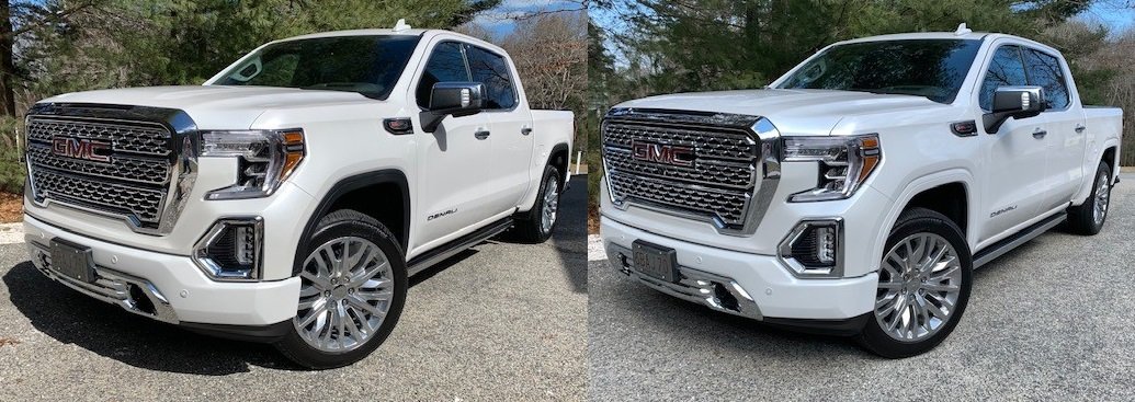

  11. Just added the body color wheel well flares. For anyone wondering, there is no hardware to remove, its all plastic clips. Here is a before and after. I love the look, they differentiate the truck a little from the rest of the Sierras on the road. Only other things I have planned are blacking out the front and back GMC emblems and tinting the front two windows 20% to match the rear. I'd like to add chrome body molding to the doors but don't want to remove the Denali emblems.
  12. I just got them installed and they came out great. It was actually super easy but I broke about 1/4 of the old clips when removing them from the truck. The new ones come set up with all new clips. For anyone wondering, there is no hardware to remove, its all plastic clips. Here is a before and after. I love the look, they differentiate the truck a little from the rest of the Sierras on the road. Only other things I have planned are blacking out the front and back GMC emblems and tinting the front two windows 20% to match the rear. I'd like to add chrome body molding to the doors but don't want to remove the Denali emblems.

  14. Those look great. Definitely clean up and class up the exterior look of the truck. Did you install them yourself? Just curious what the process entails, mine were delivered today and wondering if its worth the $40 to just have the dealer do it.
