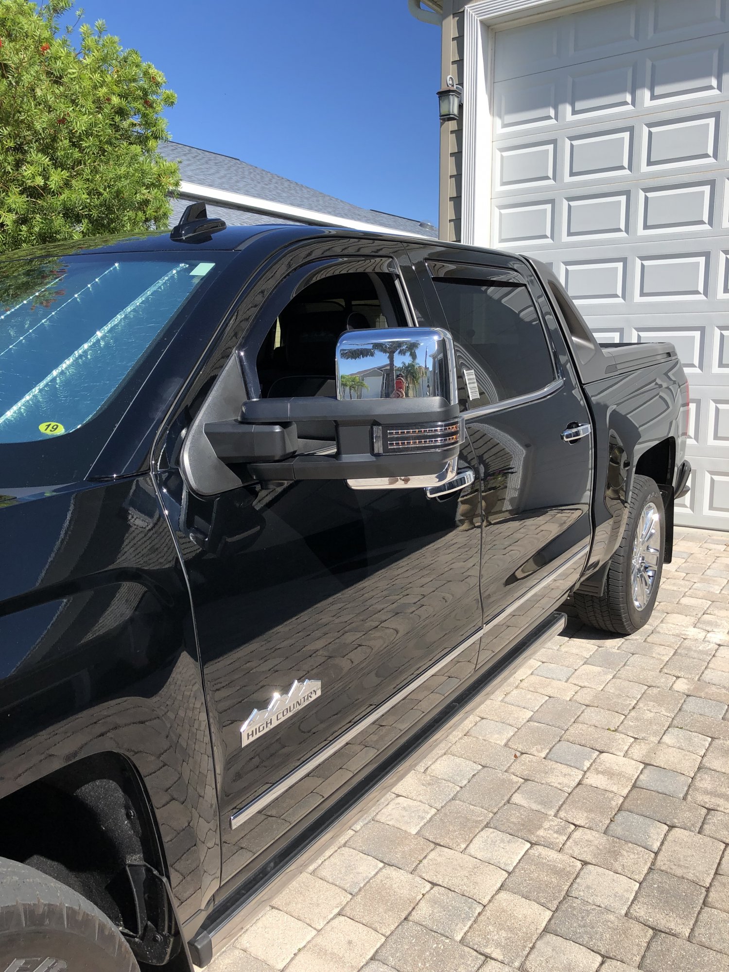

  2. I have a 2017 Silverado High Country with the DL3 mirrors and seat memory. With the help of @Pgamboa I purchased the 1AMPR01786 full function Towing Mirrors. He made me new door harnesses and provided the upgrade needed to turn the towing mirrors into the full functions of the DL3 mirrors. I followed his excellent video and the installation of the new mirrors went off without a hitch. The new towing mirrors have all the functions of the old DL3's but the view is so much better. And now it will be a lot easier for towing my 26' car hauler. Here are some photos of the finished product.

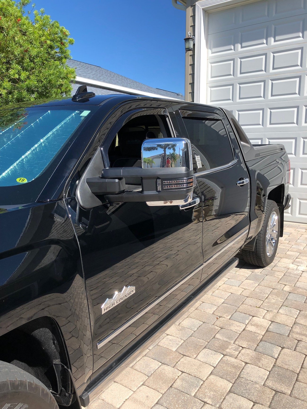

  3. Just did the Tow Mirror Upgrade on my 2017 Silverado High Country today. A couple of weeks ago I got with Phil Gamboa about switching out my DL3 mirrors for towing mirrors. He suggested the 1AMPR01786 for my particular application. I had the DL3 mirrors and seat memory already so all I needed from Phil were his replacement wire harnesses. I did the seat memory mod and the reverse/backup lights per Phil’s instructions as well. His wiring harness was a direct fit so the R&R was very easy. Phil’s excellent video and the instructions for the seat memory and reverse light mod made this a very easy and satisfying project. Here are a few photos of the finished product.
