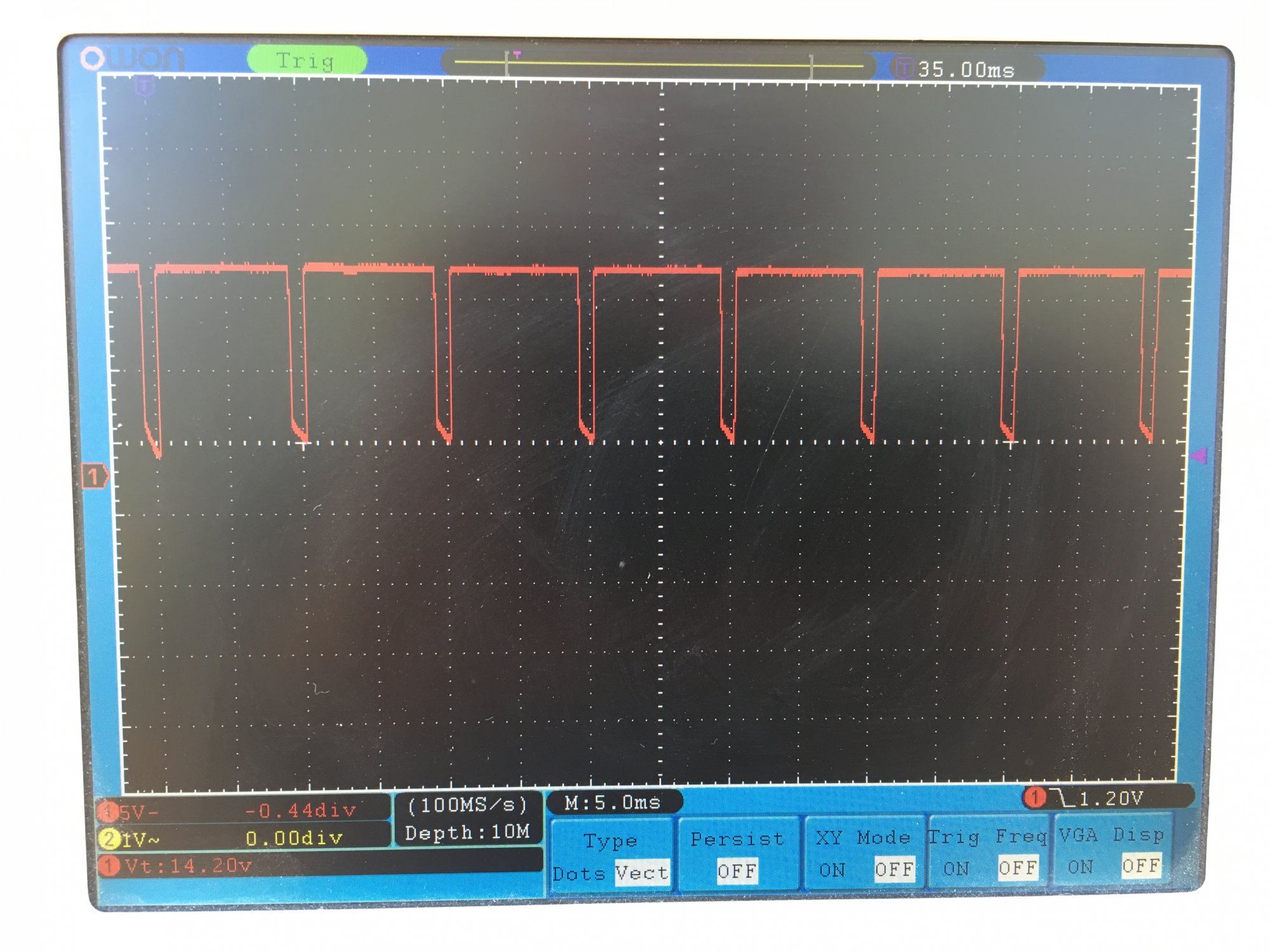

  5. If anybody's interested here's a Before and After electrical comparison when using the ASA -"at the camera" fix to the Trailer light circuit: (A) Before: The oscilloscope is confirming that the Trailer Light Circuit when powered from a late model GM truck 2019 and greater - is using PWM on the Circuit. The Voltage drops from 14.2 V to Zero every 10 milliseconds for a duration of about 1 millisecond (i.e. the voltage is at Zero for 1 millisecond). It is this voltage dropout that is causing the camera to drop the wireless video signal. (B) After: Voltage holding steady at 14.2v w/ some slight jitter but virtually no drop at all. duke3k
