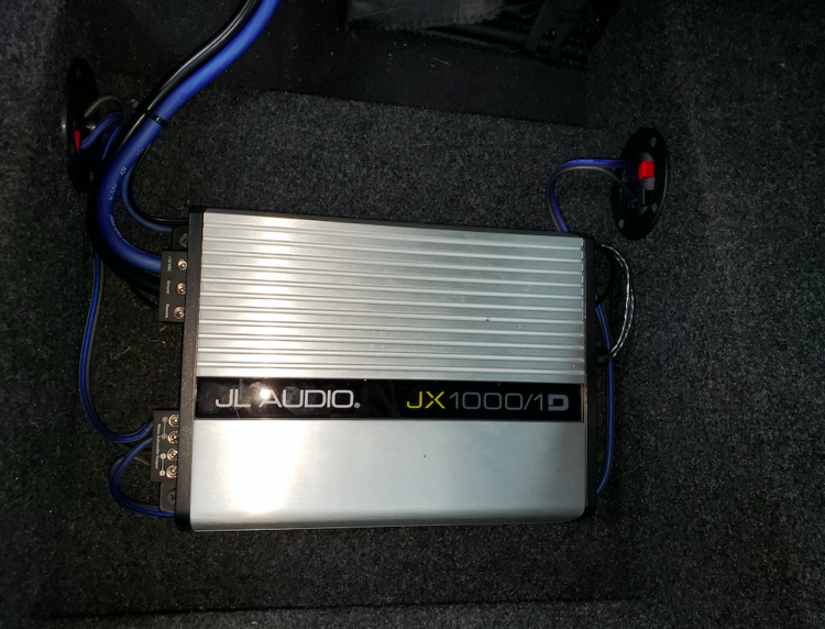

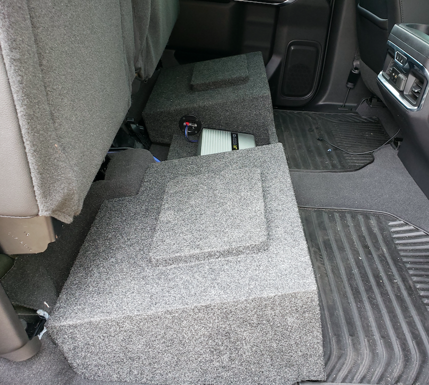

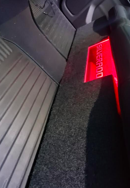

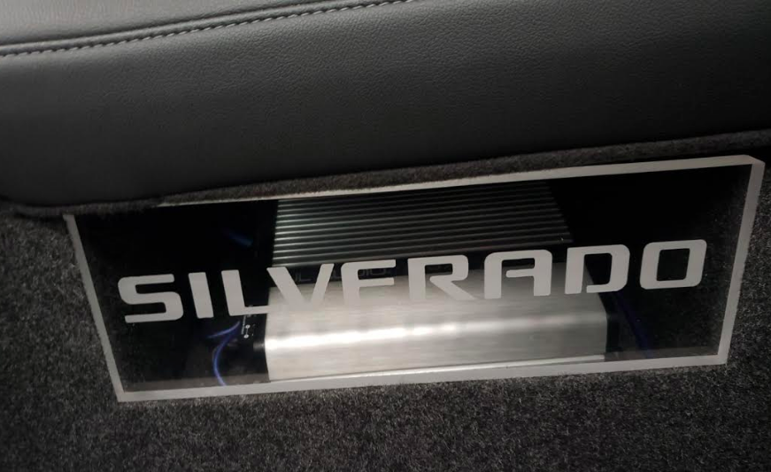

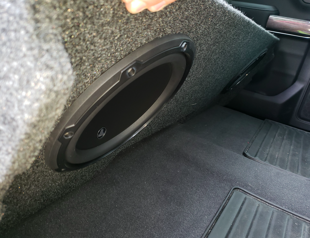

JL Audio System... Ok, I finally got my system installed. I have a 2019 Silverado LTZ Crew Cab with Bose. It hits hard and deep and clean. I did not want to fork out the $1500 for the JL Stealthbox with 2 of their thin 12'' subs. I've always had the W3s and loved their clean deep sound and didn't want to risk being dissappointed with their thin subs. So I did a lot of research and ended up with the following: (PLUS, I saved about $500 overall doing it this way.) I hope this posts helps clarify some challenges/questions. Amp: JL JX-1000 https://www.amazon.com/Audio-Jx500-Mono-Subwoofer-Amplifier/dp/B0081K3M5G/ref=mp_s_a_1_4?keywords=jl+audio+amplifier&qid=1570760485&sprefix=jl+&sr=8-4 Amp Wiring Kit: (high quality stuff) https://nvx.com/xkit42-4-gauge-amplifier-kit-with-2-channel-rca/ Subs: 2 x JL 10w3v3 4 ohm https://www.amazon.com/JL-10W3v3-4-Single-Subwoofer-10W3v3/dp/B00161382E/ref=mp_s_a_1_1?keywords=10w3+subwoofer&qid=1570752122&sr=8-1 Bass Volume Knob: installed up front under the steering column. Allows me to turn the bass all the way down -- just Bose system playing. Or up to desired level. https://www.amazon.com/JL-Audio-RBC1-Remote-Control/dp/B000UVWFPM Box: (very happy with quality of build and fitment in my truck) I did apply some additional caulk inside the box where it looked like some of the cracks were missed) http://subthump.com/Chevrolet-GMC-Custom-Subwoofer-Boxes/Silverado-And-Sierra-Crew-Cab-Custom-Subwoofer-Enclosures-by-Subthump/2019Up-Crew-Cab/2019-New-Body-GM-Crew-Cab-Dual-1012-Downfire-With-Amp-Space-New.html Wiring: https://lljcustoms.com/store?olsPage=products%2F2014-2019-gm-bose-amp-t-harness You'll need to determine if you have the 'noise cancelling' feature. If you do, you'll see a microphone thing on the ceiling above your rear seat. LLJ Customs can provide you a harness bypass plug as part of your T-harness purchase if you do. I did not have that feature so all I used was the T-harness. You'll need to order a Line Output Converter (LOC) with the T-harness from LLJ so that you can get clean signal to your amplifier. I went with the upgraded "active" LOC -- https://www.audiocontrol.com/car-audio/factory-system-upgrade/lc2i/ -- WHICH LLJ will hook up for you as part of the T-harness purchase. NOTE: You'll need to remove the back seat from the back wall in order to run your wires and install the Lc2i. I don't have a picture of it, but my installer used double sided sticky tape to adhere it to the back wall just to the right of some other electronic box that was alread in there. (there's plenty of room on the back wall for it) Here's a good video that is helpful. However when he talks about pushing down on the seat locks, don't do that. I used a long allen wrench to lift up on the hook on top of the locking mechanism which made it much easier. There are 4 10mm bolts on the bottom you'll have to use an extender to reach. Once you get them started, you can remove them by hand. Here are some pics of my install:

There's a video in my post which also provides good info on this topic... Ok, I finally got my system installed. I have a 2019 Silverado Crew Cab with Bose. It hits hard and deep and clean. I did not want to fork out the $1500 for the JL Stealthbox with 2 of their thin 12'' subs. I've always had the W3s and loved their clean deep sound and didn't want to risk being dissappointed with their thin subs. So I did a lot of research and ended up with the following: (PLUS, I saved about $500 overall doing it this way.) I hope this posts helps clarify some challenges/questions. Amp: JL JX-1000 https://www.amazon.com/Audio-Jx500-Mono-Subwoofer-Amplifier/dp/B0081K3M5G/ref=mp_s_a_1_4?keywords=jl+audio+amplifier&qid=1570760485&sprefix=jl+&sr=8-4 Amp Wiring Kit: (high quality stuff) https://nvx.com/xkit42-4-gauge-amplifier-kit-with-2-channel-rca/ Subs: 2 x JL 10w3v3 4 ohm https://www.amazon.com/JL-10W3v3-4-Single-Subwoofer-10W3v3/dp/B00161382E/ref=mp_s_a_1_1?keywords=10w3+subwoofer&qid=1570752122&sr=8-1 Bass Volume Knob: installed up front under the steering column. Allows me to turn the bass all the way down -- just Bose system playing. Or up to desired level. https://www.amazon.com/JL-Audio-RBC1-Remote-Control/dp/B000UVWFPM Box: (very happy with quality of build and fitment in my truck) I did apply some additional caulk inside the box where it looked like some of the cracks were missed) http://subthump.com/Chevrolet-GMC-Custom-Subwoofer-Boxes/Silverado-And-Sierra-Crew-Cab-Custom-Subwoofer-Enclosures-by-Subthump/2019Up-Crew-Cab/2019-New-Body-GM-Crew-Cab-Dual-1012-Downfire-With-Amp-Space-New.html Wiring: https://lljcustoms.com/store?olsPage=products%2F2014-2019-gm-bose-amp-t-harness You'll need to determine if you have the 'noise cancelling' feature. If you do, you'll see a microphone thing on the ceiling above your rear seat. LLJ Customs can provide you a harness bypass plug as part of your T-harness purchase if you do. I did not have that feature so all I used was the T-harness. You'll need to order a Line Output Converter (LOC) with the T-harness from LLJ so that you can get clean signal to your amplifier. I went with the upgraded "active" LOC -- https://www.audiocontrol.com/car-audio/factory-system-upgrade/lc2i/ -- WHICH LLJ will hook up for you as part of the T-harness purchase. NOTE: You'll need to remove the back seat from the back wall in order to run your wires and install the Lc2i. I don't have a picture of it, but my installer used double sided sticky tape to adhere it to the back wall just to the right of some other electronic box that was alread in there. (there's plenty of room on the back wall for it) Here's a good video that is helpful. However when he talks about pushing down on the seat locks, don't do that. I used a long allen wrench to lift up on the hook on top of the locking mechanism which made it much easier. There are 4 10mm bolts on the bottom you'll have to use an extender to reach. Once you get them started, you can remove them by hand. Here are some pics of my install: -
