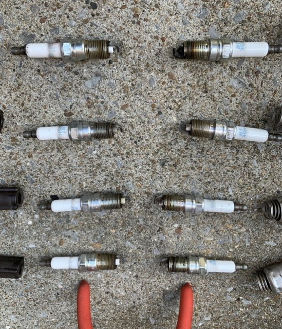

Checking back in on this thread. The Yukon XL is at 155k miles now, and I have been using a Range AFM Disabler. I haven’t fouled up any cylinders like before, although #7’s spark plug again looks a bit older/dirtier than the others, even though they were all replaced. The electrical haywire issue still happens randomly, but if I remove the battery cables and clean the terminals (which do not in any way appear to be dirty or loose), it goes away for a few thousand miles. Just weird. The thing I like about this Yukon XL is that it has the heavy duty towing package, rated for 8k lbs. That comes in handy. But I’m also getting sick of dealing with issues. It blew a heater core hose last year and stranded my wife on the highway. Second time it has stranded her on the side of the road.

Well, the Yukon finally threw a code. P0307, misfire in cylinder 7. I bought new plugs and wires and some AC Delco upper engine cleaner. Shot each cylinder full of that stuff and took my youngest to his soccer game. Came back and finished swapping plugs. No more rough idle, no power lag. That cylinder 7 plug was fouled beyond belief. Bought a Range AFM disabler. Hoping our plugs last longer and we don’t consume as much oil.
Well I checked the terminals. Everything was snug, and they didn’t look dirty at all, but I got my terminal brush out and cleaned them again really well. Hooked everything back up, and drove it around a bit. The battery is now showing just over 14V instead of just under. And no acceleration lag. I do still have the slightly lumpy idle though. Maybe it’s time to check spark plugs. It’s VERY irregular, though. Doesn’t feel like I’m missing spark in a cylinder.
