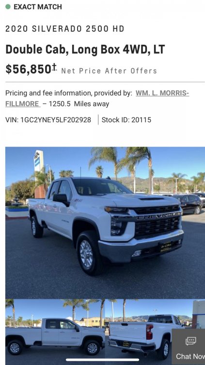

  5. Oregon, California, Pennsylvania. Not sure who’s open during this lockdown, but those are the trucks locations. Dealer and VIN noted in the screen shots. Also, I don’t remember you specifying 2500 or 3500. These are 2500’s.
  6. There’s 4 of them nationwide and 1 in transit according to the Chevy inventory on their website. 3 white and 1 Cajun Red. The one in transit is Red Hot Red.
