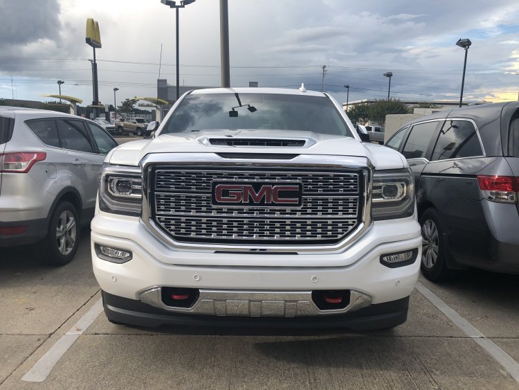

  1. They body shop that did the work ordered them all through a local GMC dealer. All in it was not cheap. I'm not sure how the OP got it all for $800. Hood and all the parts and 3 stage paint and everything was around $2k. I got lucky on it b/c the hood was damaged anyway so I just paid the difference of replacing the stock hood with the HD.

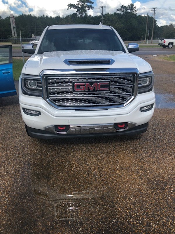

  4. I did this swap as well. Before After

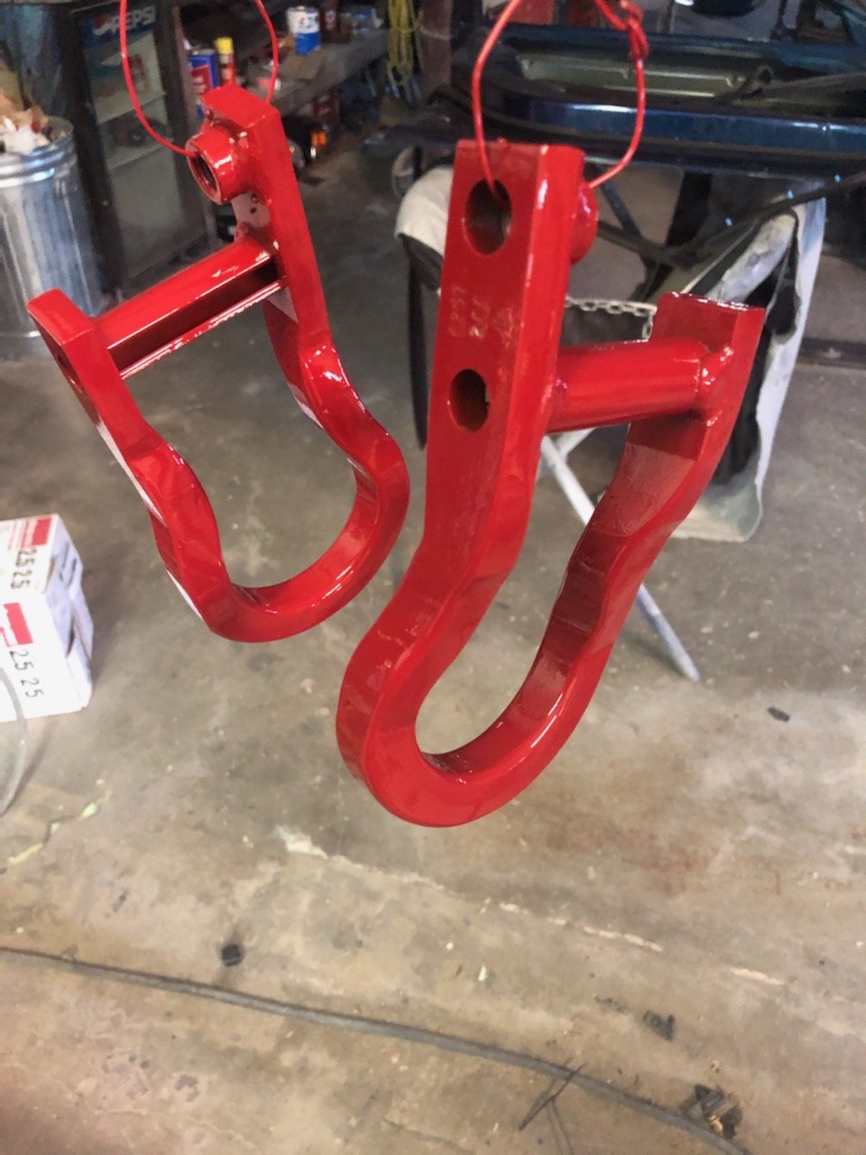

  5. Powder coated the tow hooks and did an HD hood.

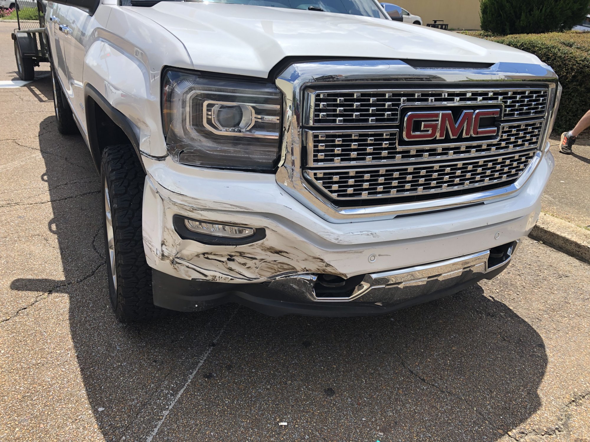

  6. Someone smashed into my truck so it's been down a while. Took the opportunity to do a few mods while it was repaired.
