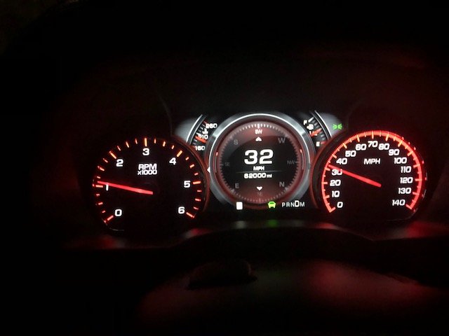

  9. That looks clean. Can you get us a shot of it with the screen on and displaying something?
  10. Thanks. If I put the truck in tow/haul mode it swaps out the battery/charging gauge for the trans temp gage on the screen in the dash. I got the harness replaced today that had the sensor in it. Temps were reading 150ish on the way home. Definitely higher than it was before. My friend is the tech at the dealer I took it too. He confirmed the old sensor was done.

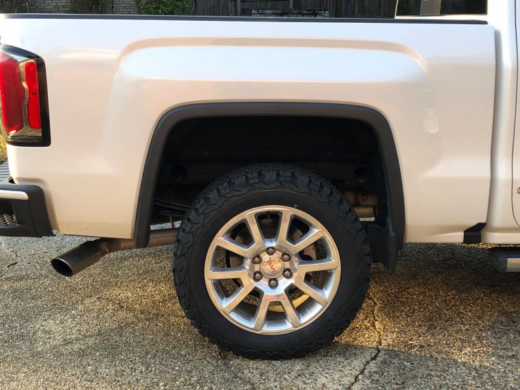

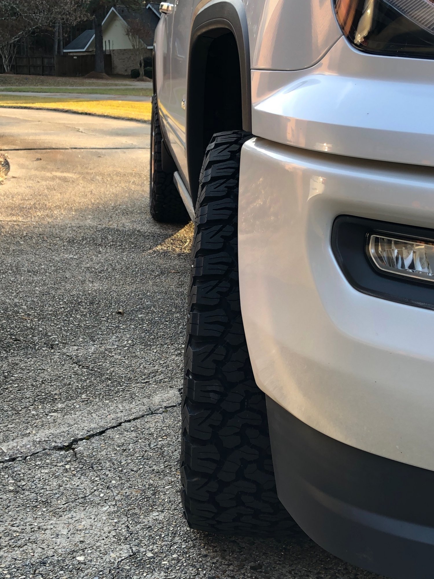

  20. Got the KO2's mounted. The ride much better than with the worn out Hankook ATM tires that were on there.
