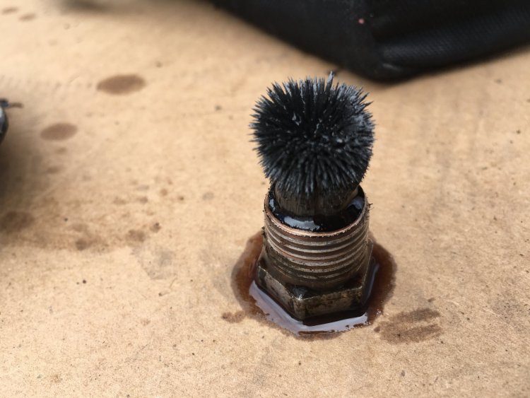

  4. Switched over to Amsoil today. Motor, front and rear diff, transfer case. Glad I did the transfer case too, even though this is "normal". 45k in
