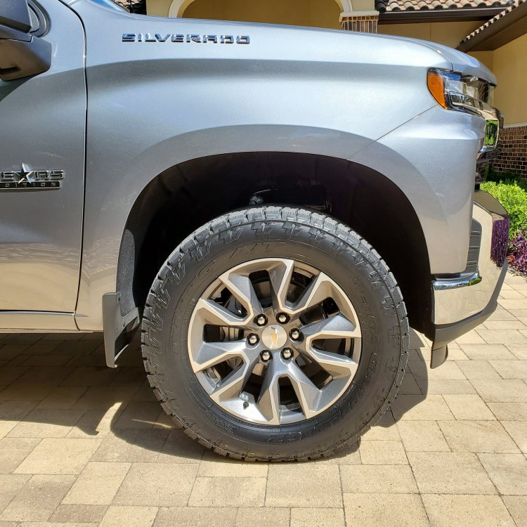

  2. I've got 295 60 20 Nitto Terra Grappler on stock rims with a 2 inch level and they fit and ride perfectly. IMO 35s look better with at least a 3 or 4 inch lift. With the leveling kit the 34s look nice and don't look like they're stuffed in there. But either way they'll look better than factory tires.
  3. 295 60 20 Nitto Terra Grappler G2 with 2 inch Rough Country level kit. No rubbing and rides nice. I had the old Terra grapplers on my old truck and they lasted forever. Nitto makes a solid tire.

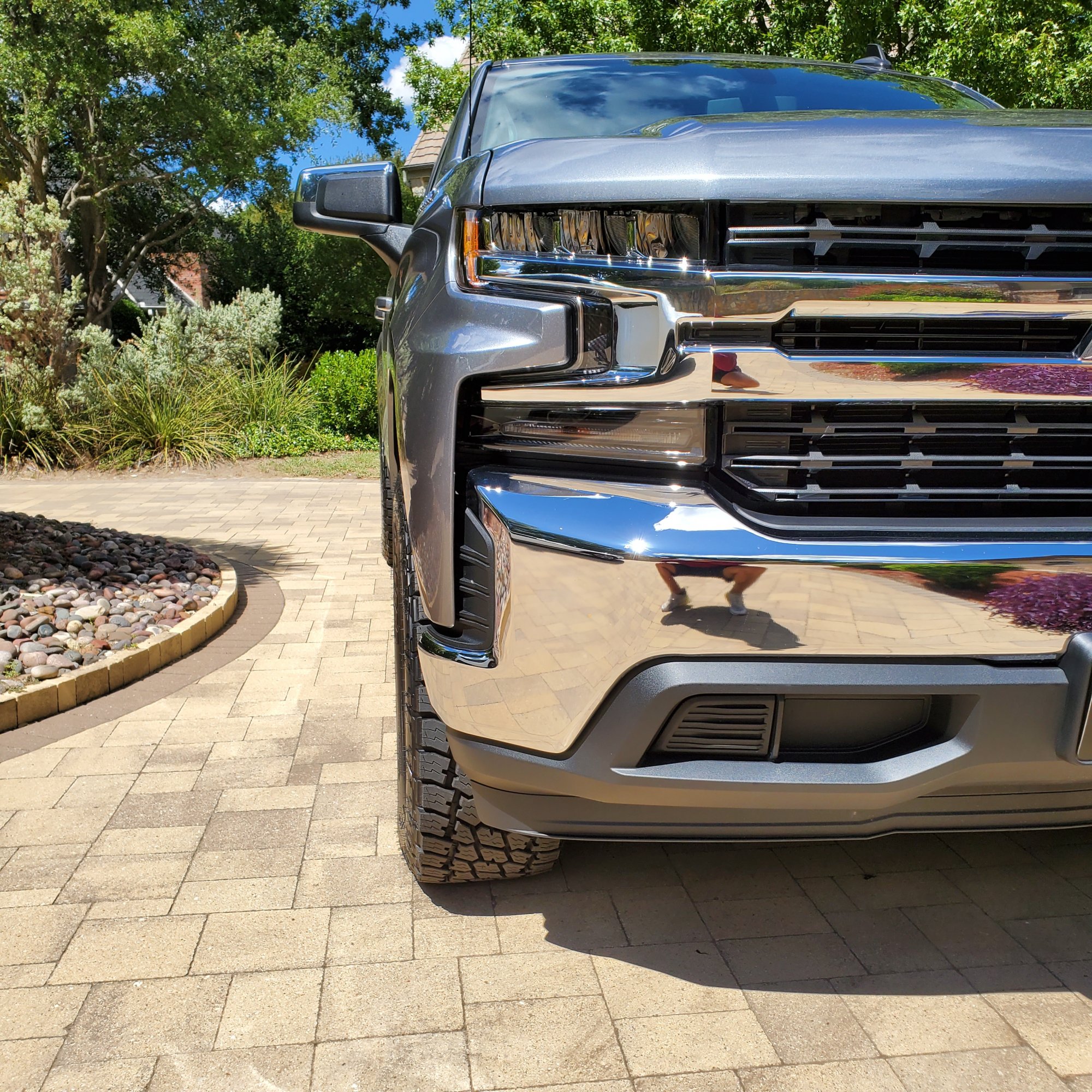

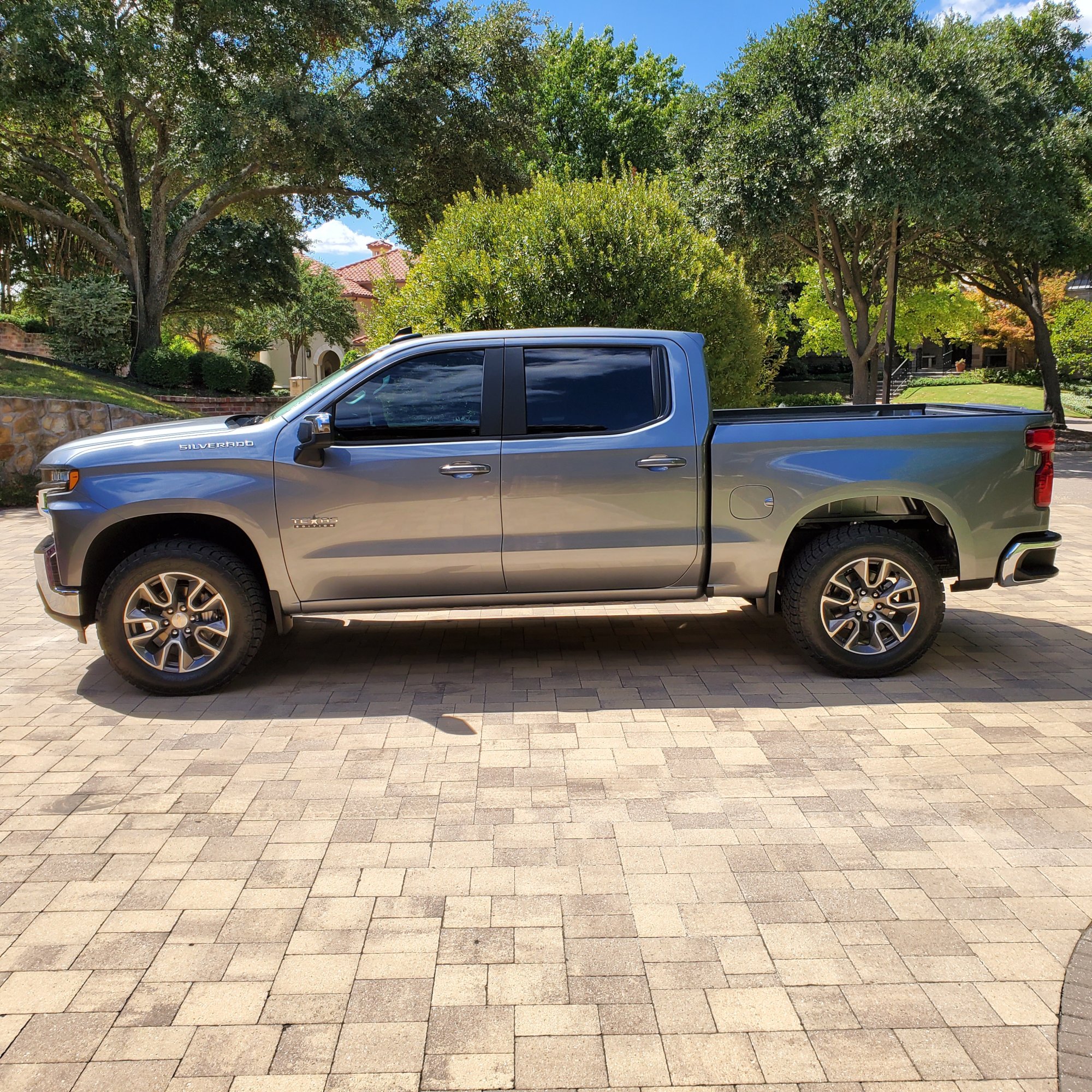

  5. You can fit 33's without a leveling kit with plenty of room. The stock wheels that came on my truck were 275 60 20 which is a 33. With the leveling kit you can go with a wider 33 or taller than 33. I have the 2 inch Rough Country level which is a bottom spacer with 295 60 20 Nitto Terra Grappler G2 and it rides nice. I don't know if a top or bottom spacer is supposed to be better but so far I like the bottom spacer on my truck.
  6. It's all good. No issues. Rides like factory. No rubbing. Tires do not stick out.
  7. I have a rough country 2in level on my 2 wheel drive LT 5.3 l and it looks good but from what I've seen and read online I think it takes less than 2 inches for trail bosses. If you look on the wheel and tire thread there are people who have done less than 2 inches leveling. There's a picture of my truck with the 2 inch level and Nitto Terra Grappler G2 295 60-20 tires.
  8. 2in Rough Country front level. 295/60/20 Nitto Terra Grappler G2 on stock wheels. No rub.
