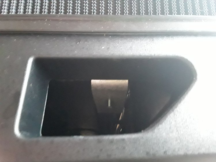

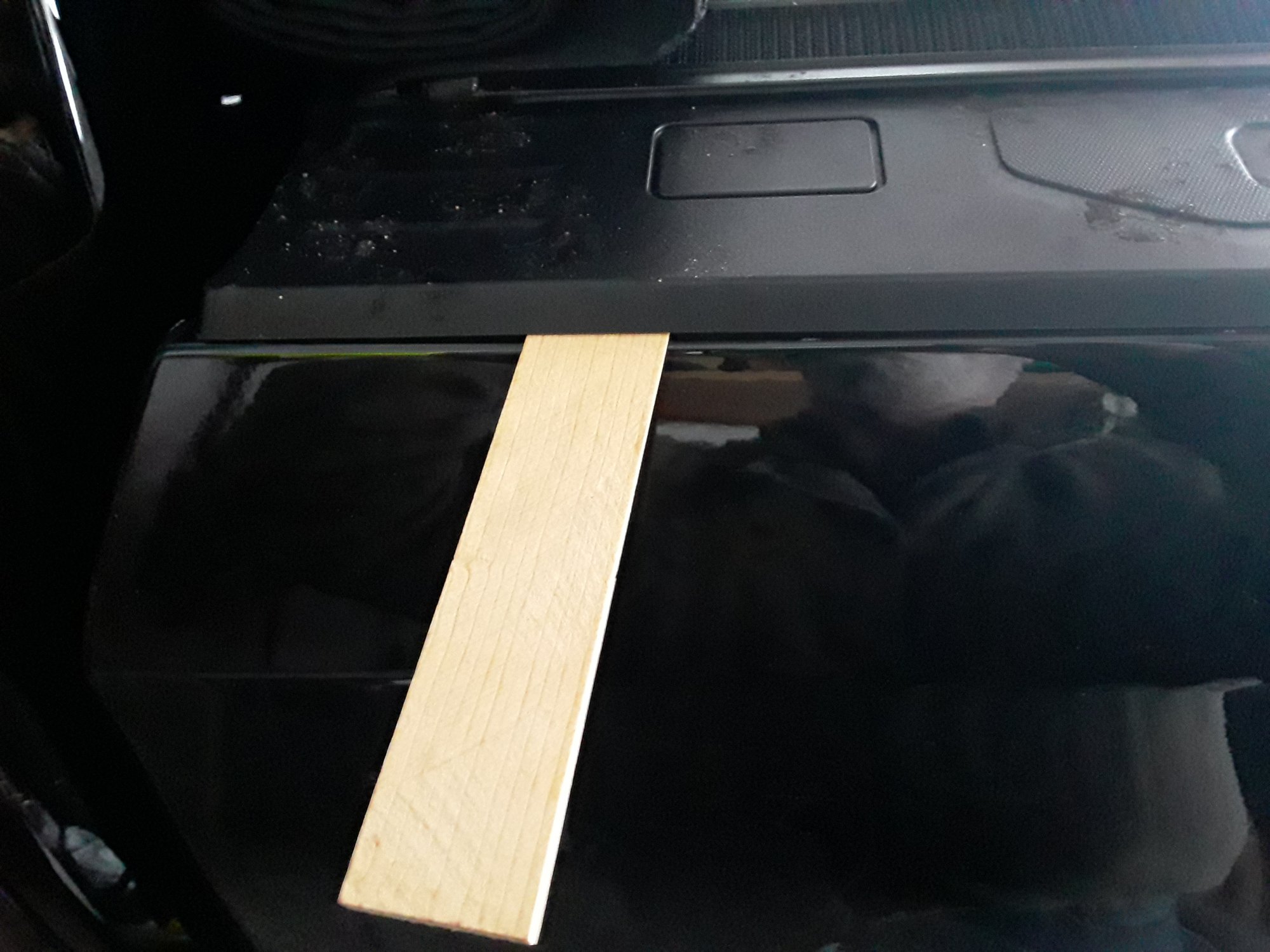

  4. To expose front stake pocket you need to pry up the bed cap just enough to get half the clamp in. I used a wood shim . Pry up slowly and you'll see the plastic clips that hold it down. With a narrow screwdriver or pick release the clip

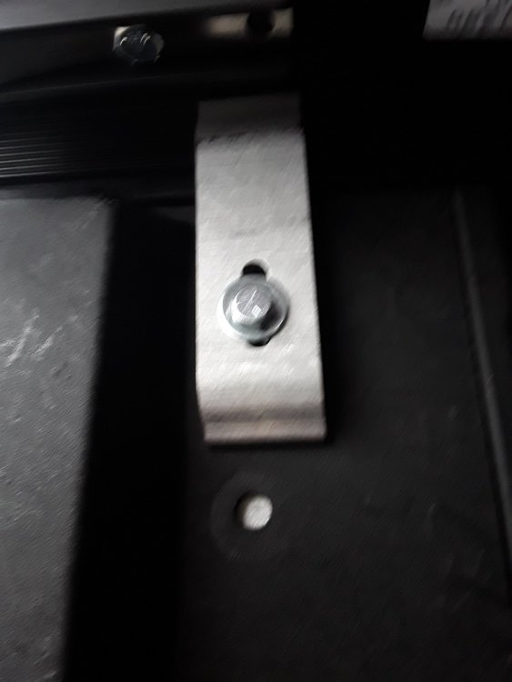

  5. Will send pictures later. All I did was take apart the clamps, set the rail on the on the bed cap. I held it in place with duck tape. Take half the clamp and place it where it needs to be to hold the rail. Mark where the hole needs to be , I used a 3/8 inch bit. Place one half of the clamp down the bed stake hole and bolt the other half to it . Slide the clamp up to the rail and tighten . It will make sense when you see the pictures. As I stated before I'm trying to post picture more than one at a time

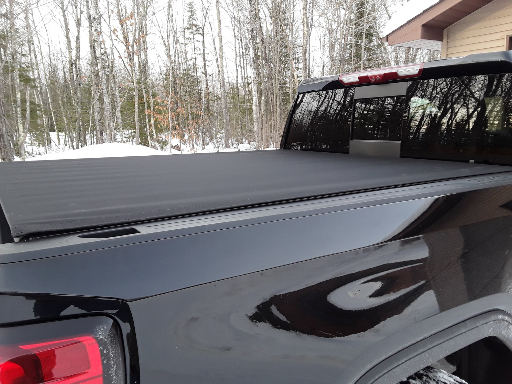

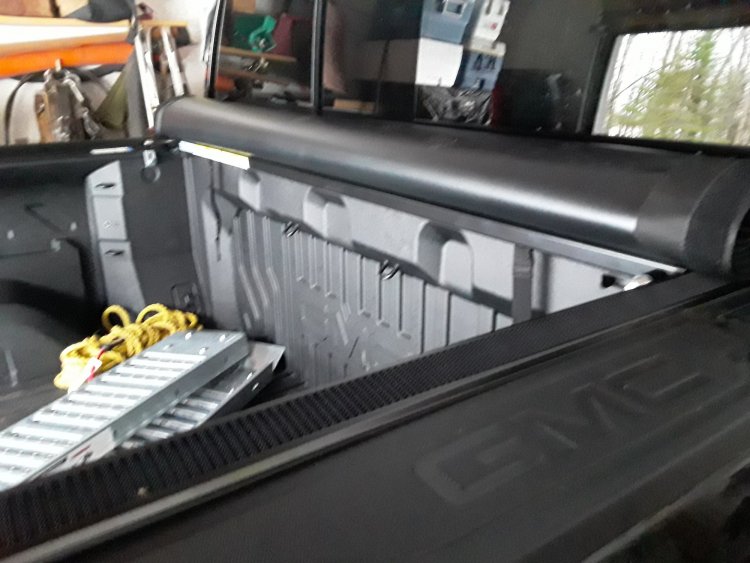

  6. Just installed a tuxedo pro x15 bed cover . Will send more pictures when I figure out how to send more than one at a time. But what I did is drill a 3/8 inch hole in the side of bed below to stake bin and put half the clamp inside the stake hole and the other on the bed side. For the front I lifted the bed cap so I had access to the front bed stake and did the same thing. Seems to work just fine
  7. Looks great, is it hard to find the square holes for the j hooks ? Thanks for the pictures
