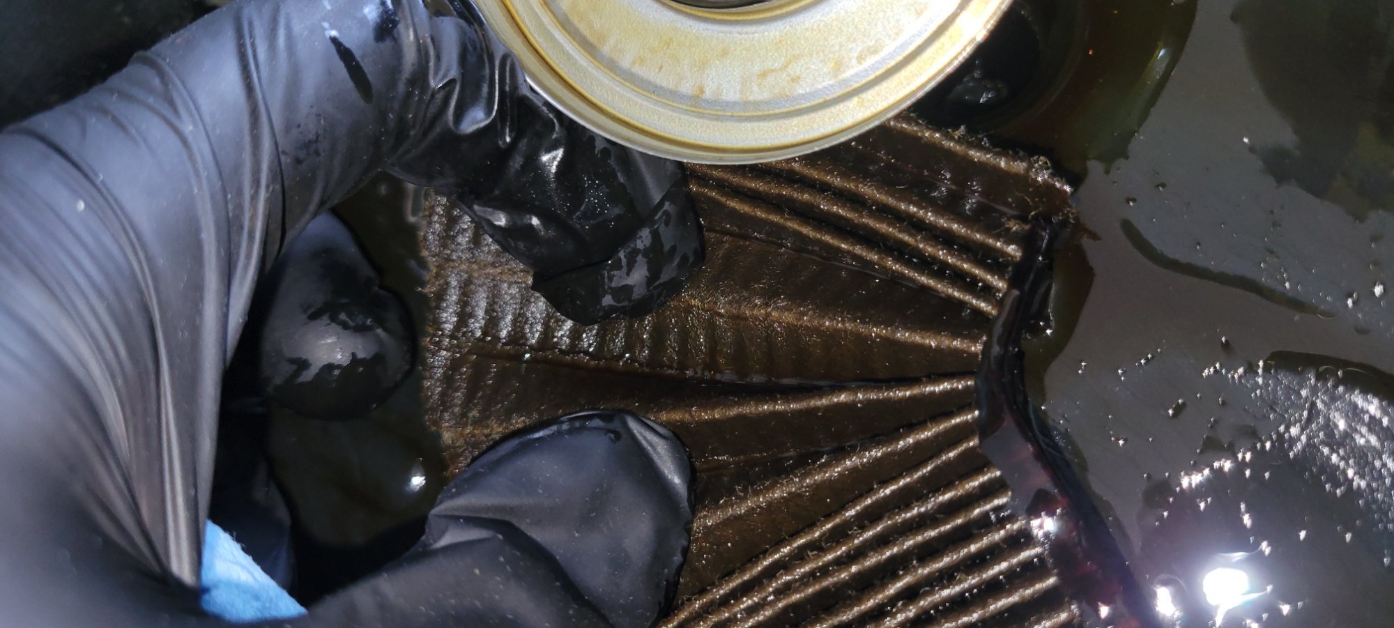

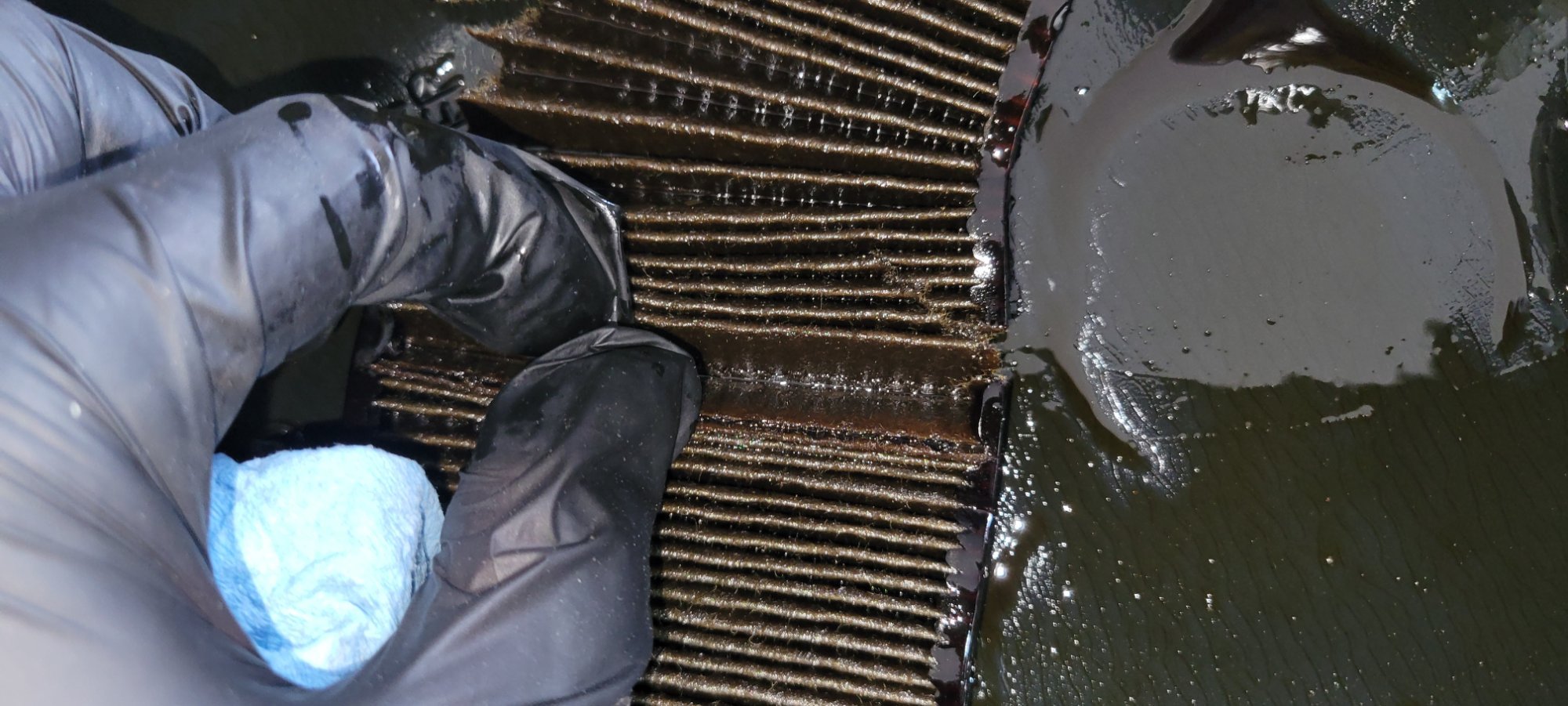

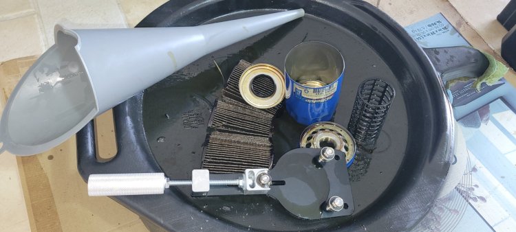

Last November 2025 I ended up having to have the camshaft and lifters replaced in my 2019 Yukon 5.3 liter with only 88,000 miles. If I remember correct it was the #5 exhaust lifter that failed. It didn't seem like it was collapsed and from what I remember the roller bearings were OK, but the metal on the roller and the corresponding camshaft lobe were spalled/cracked (I went to the dealership to confirm failure once they had the cylinder heads off). I only heard the typical "tap tap tap" when returning from shopping and stopped driving - although I drove it to the dealer about 20 minutes away rather than having it towed, maybe that was a mistake. This was not a failure that was driven on repeatedly like I occasionally see when inspecting warranty claims. Anyway, to the tune of $8,800 they replaced the camshaft and lifters, spark plugs, and the oil pump as per my request. I'm currently over 95,000 miles as of today. I did my first oil change at 5,000 miles after the replacement - maybe that was a bit too late and I should have done it earlier. I cut open the oil filter and found a couple of small metallic shavings/chips within the filter. I went back to the dealership to inquire and I was told that was "probably" normal. I was told that every filter probably has metal in it....nobody ever cuts them open apparently but me. I didn't bring them to filter nor did I take any pictures, nor did I check to see if the metallic particles were magnetic or not. Oops. I hope everything is OK, but I just have to say that my confidence after such a failure is severely diminished. I'm currently sitting at about 95,000 miles, and Friday two-days ago when returning home from work I believe I heard a bit of pinging/detonation when traveling in the 45-60 mph range, if I ever-so-slightly gave it a bit of throttle input without having the transmission drop down into a lower gear. When I got home, I added two bottles of GumOut fuel injection cleaner. I had just filled up earlier in the day at Sam's Club. What do you think? I had hopes to keep this vehicle for at least 10-years but I feel as though my camshaft and lifter failure occurred VERY early. I inspect warranty claims on a daily basis and find that most of these lifter-related failures occur after 140,000 miles and beyond. I purchased my 2019 Yukon at Carmax in December 2019 with 34,000 miles on it - yes, that was a lot of miles for the first year, but it was a Hertz rental registered in Missouri. I would have assumed they did their oil changes on time. I found no signs of sludge or varnish. However I drove the vehicle over 50,000 miles without an issue at that point between December 2019 and November 2025. I was also hoping that the dealership would have been a lot better with communicating with me throughout the rebuild. I left them a lengthy note describing extra add-ons that I wanted them to do, and I was hoping they would have communicated with me on the condition of the camshaft bearings, etcetera. After 3-weeks I got a call that it was ready for me to pick up, and at that point I asked about the add-ons that I left on the one-page printed note. They said, "what things?" Figures...they had to go back in an replace some of the extra things that I had asked about like the TPMS sensors (Over $400 for 2 sensors, ripoff!), oil cooler hoses, coolant hoses, etcetera. I was hoping to have received a discount since everything was already torn down obviously, but of course no one elected to look at my note? We pay top dollar for minimum effort apparently. GMC dealership too, not some rinky-****** backyard mechanic shop! By the way, the only modification I have installed is an oil catch can. I have had that installed since November 2023. I also installed a new OEM water pump last month for peace of mind considering that we'll be headed on a 2,000+ mile round trip road trip in about a week and a half. I'm a bit nervous to say the least.

Last Friday I changed the oil at 79,832, and this is the second fill that I used 5w30 vs 0w20. This fill I used 7-quarts Kirkland Signature full-synthetic with AC Delco PF63 filter and 1-quart Marvel Mystery Oil. I have a catch-can installed. I feel as though quite a bit of oil accumulates in the catch can, but throughout the last oil-change interval of 5,361 miles, I never had to add any oil. The oil in my catch-can is not milky, it is pretty much oil consistency, very little water vapor or condensation. Not long ago I began keeping a record of what I pulled from the catch can since upgrading to a newer version with a ball-valve drain at the bottom. 78,403 miles - Collected 118ml 78,920 - Collected 40ml 79,832 - Collected 60ml 80,179 miles - Collected 20ml (After one ~300 mile road trip since oil change) Yet still, dipstick read full, no obvious contamination found within the oil filter either.
