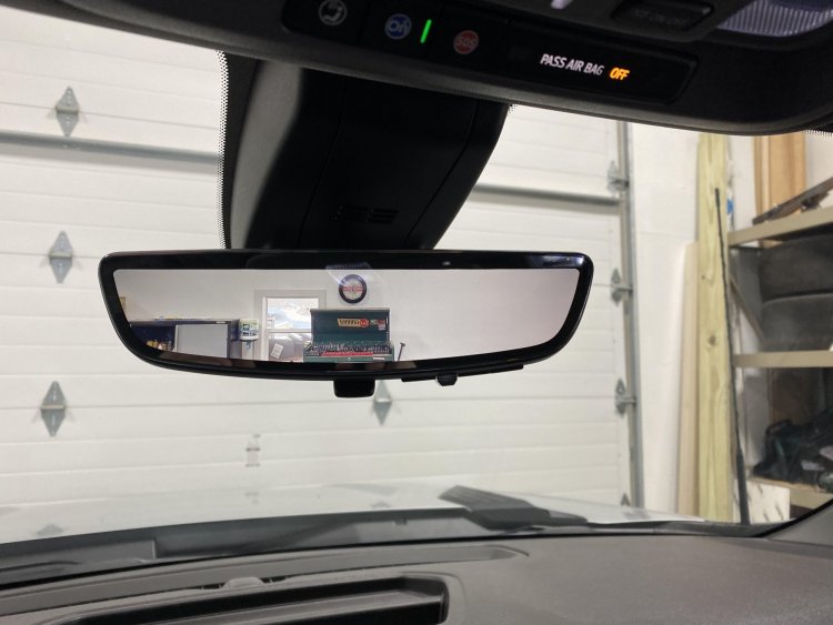

  8. The only termination point is under the dash. Switch 5 is prewired for a strobe light in the roof, and the other end is in the spoiler. You could pull that wire out of the harness and cut it and then use it for what you want.

  13. From what I can tell in the picture, it looks like the right plug, and may work. The biggest issue I can see without spending the money on it, is the resolution. From what I have found, the backup camera in the tailgate is like 720 or 1080 resolution, whereas the rear view mirror camera is around 4k resolution.
  14. I have some more pictures, but trying to figure how to upload them. I exceeded the my max size with the first three pictures.
