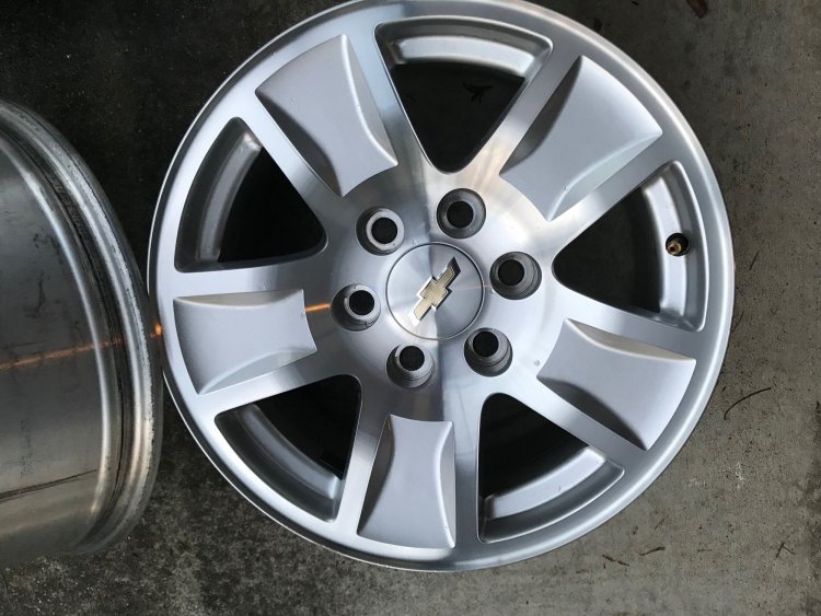

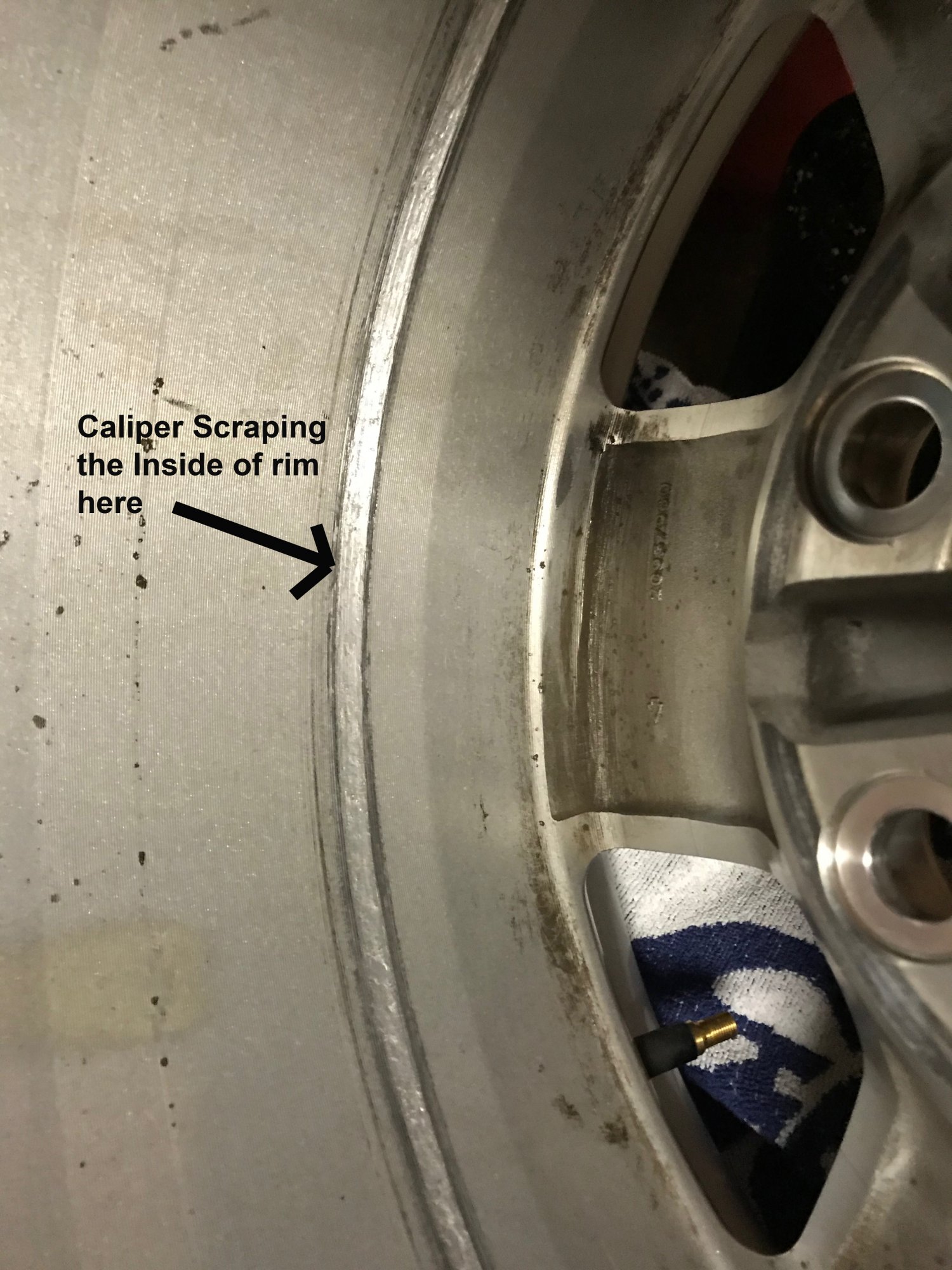

Well... I learned the hard way on the rims fitment issue. I have a 2019 Silverado Work Truck. I assumed that 17" rims from an older Silverado would be a good replacement for the 17" steel rims that came on my work truck. I bought a set of OEM rims off of Craigslist and had my tires mounted on them only to find out that the DIAMETER of the rims was too small and the calipers scraped the Inside diameter. Check out the photos. The part number of the rims that I tried is 20937960. I have a set for sale now if anyone wants them! I wish there was a list which showed me which part numbers would fit.
