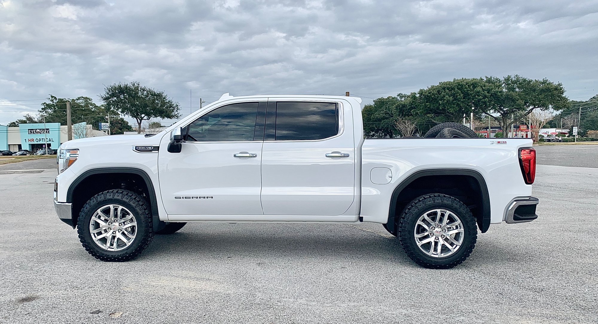

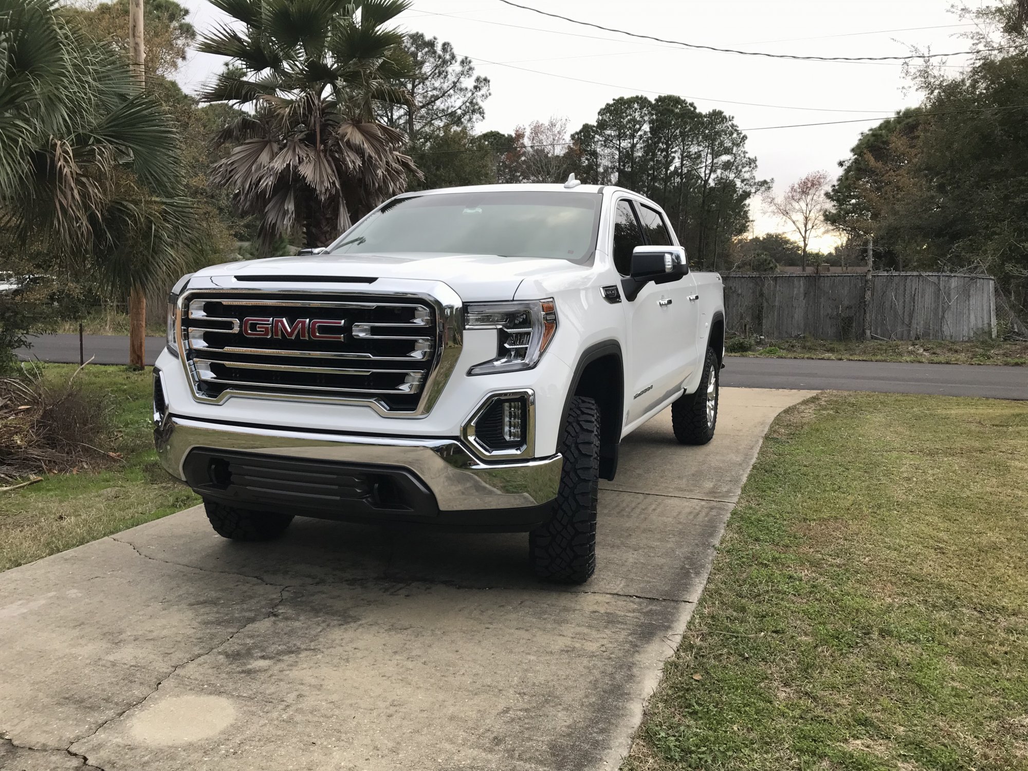

  8. This is my first post and just want to say that this has been a great platform for any questions I’ve ever had about my GM vehicles. I did did an enormous amount of research before deciding on the Ready Lift +2 SST (part #: 69-3920) I saw a ton of people looking for pictures of set-ups, so I wanted to share mine to hopefully help someone out. This truck came with the factory installed 2” lift (same as AT4) got the above level installed which added 2” in the front and 1” in the rear. There is still 1” of rake to the truck which isn’t too noticeable. Installed 275/65/20 Duratracs and the stock rims. You CANNOT go wider on the stock tires, as it sits now there is only about 1/4” clearance at the UCA. Truck looks/feels great & no rubs lock to lock with zero trimming. No change to factory ride. Hope this helps y’all out! -JH
