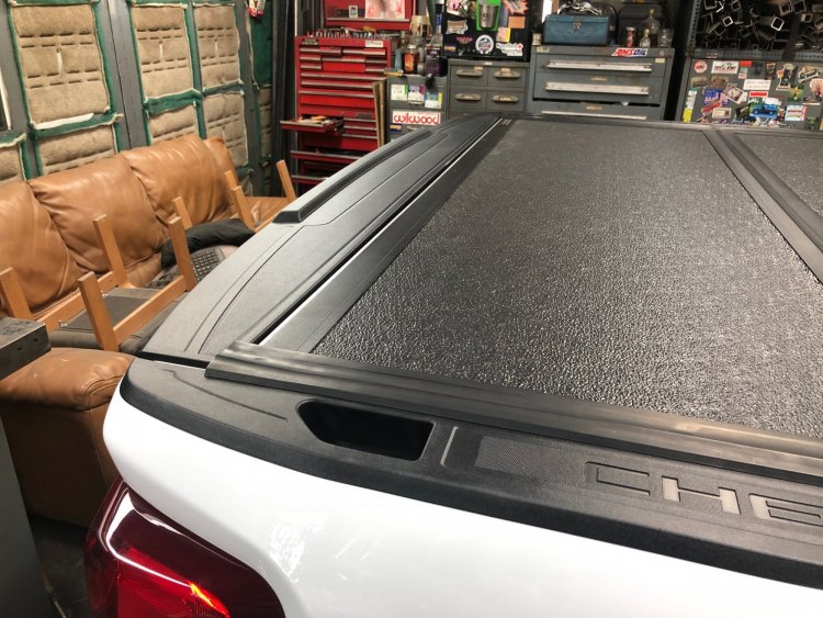

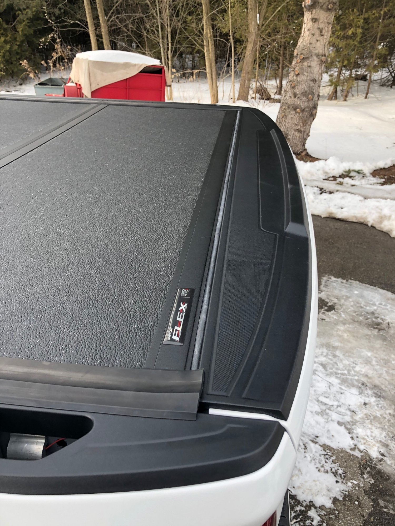

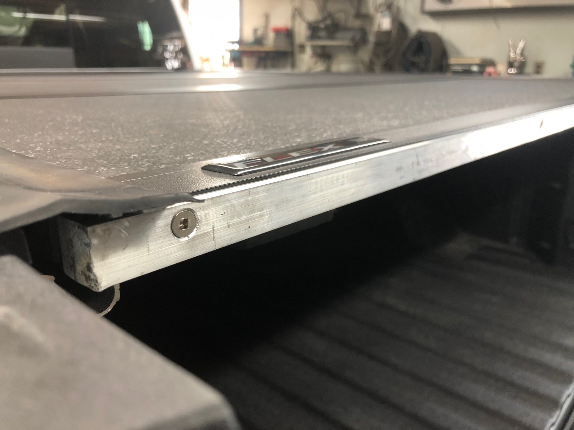

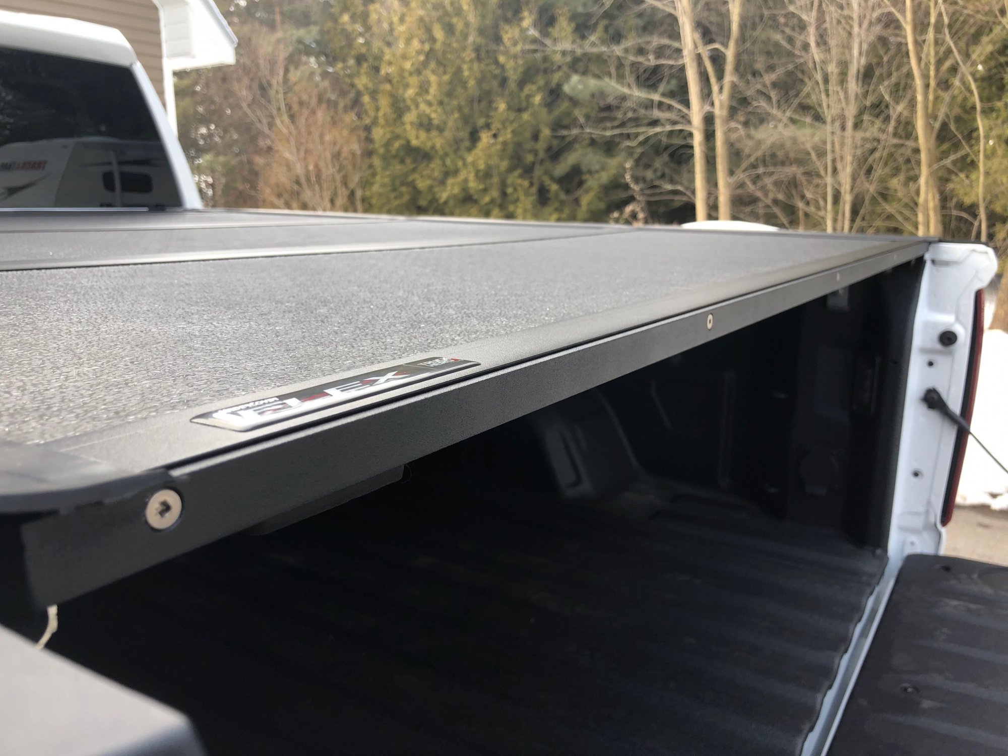

  3. OK, here a few more pics. As mentioned above, they do fit as is, but the issue is the seal wanting to sit ON TOP of the tailgate. This is fine if the tonneau cover is closed AFTER the tailgate is closed, but if you try and close the tailgate without the tonneau cover open, the seal gets crushed. My fix was to remove this seal and install a 3/4 piece of aluminum with a new seal so that it gets compressed by the tailgate. It works awesome and worth the couple hours of work. I powder coated the aluminum to match the cover, and was able to source the seal from Amazon for $20.

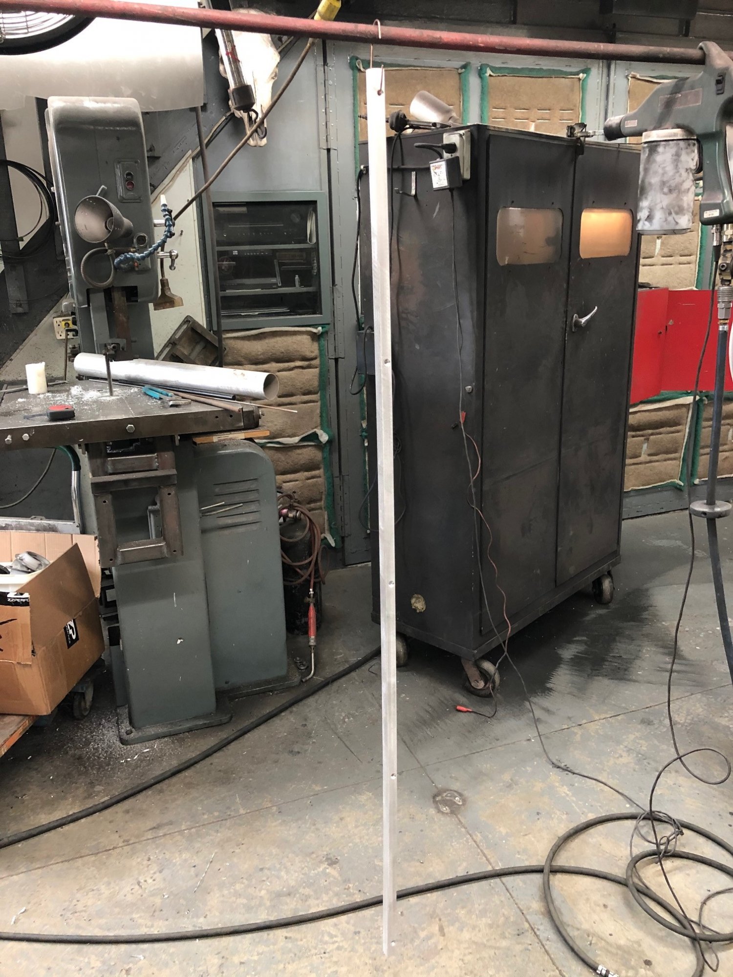

  6. Well, I guess the answer is they do fit, kinda! They do fit perfectly as is, but to make it perfect the rear seal needs to be modified. The second picture shows a small gap and apiece of 3/4 X 3/4 aluminum I installed on the rear edge of the cover. Now that I know it's perfect, I will powder coat the aluminum to match the cover and install the new seal. Doing this allows the power tailgate to work properly. Hopefully this post will answer any questions for anyone wanting to know if the older covers fit.
