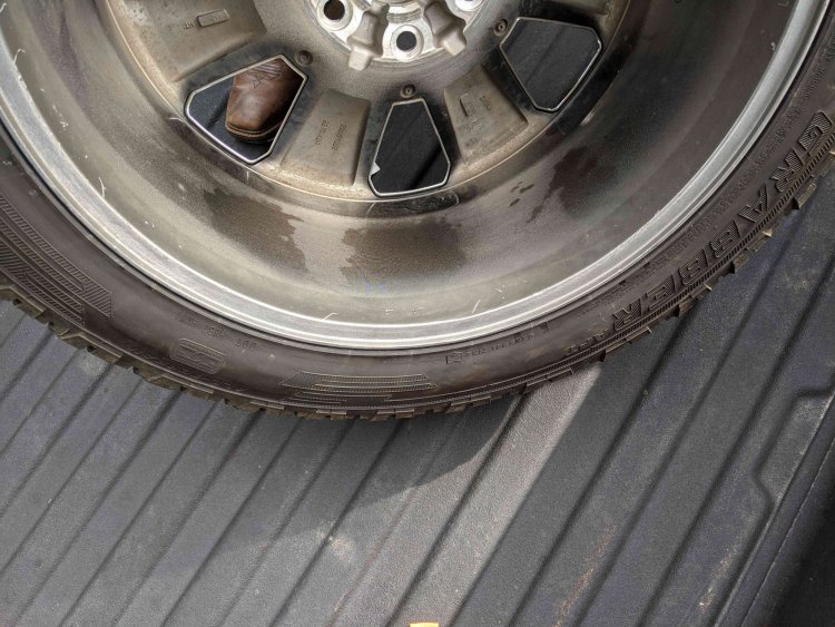

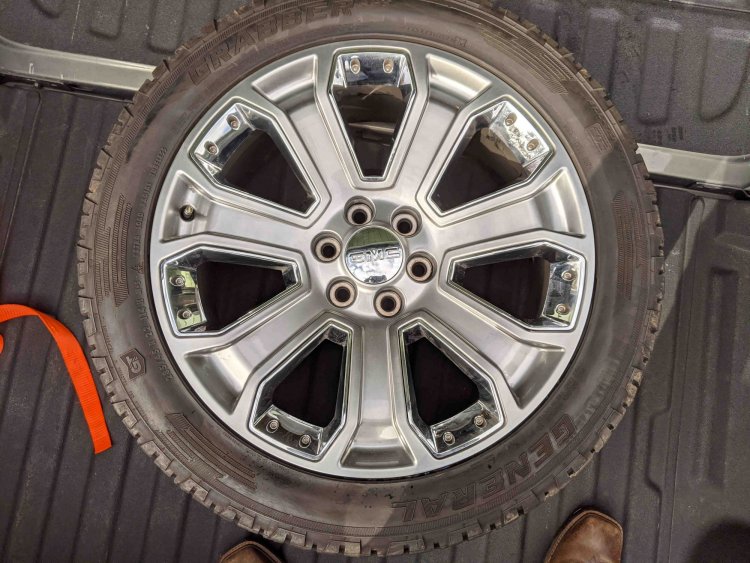

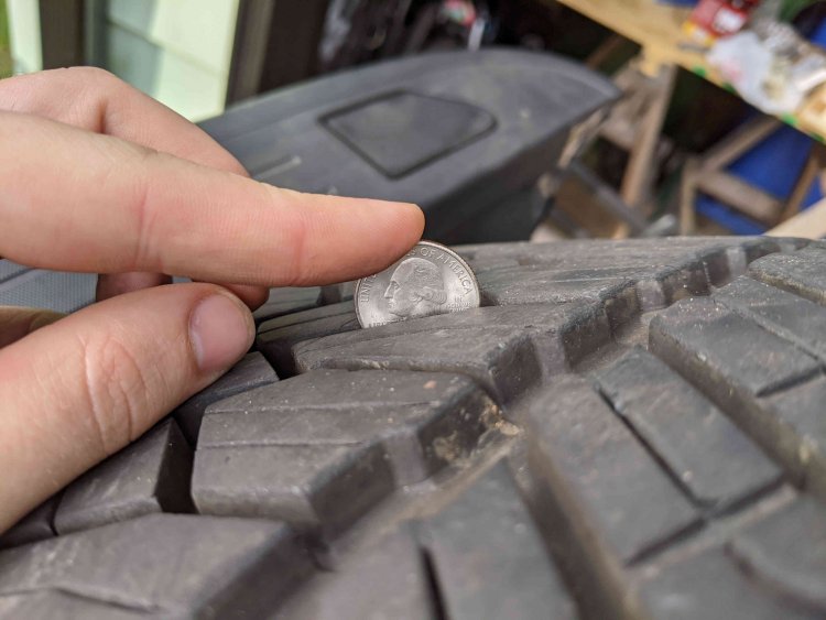

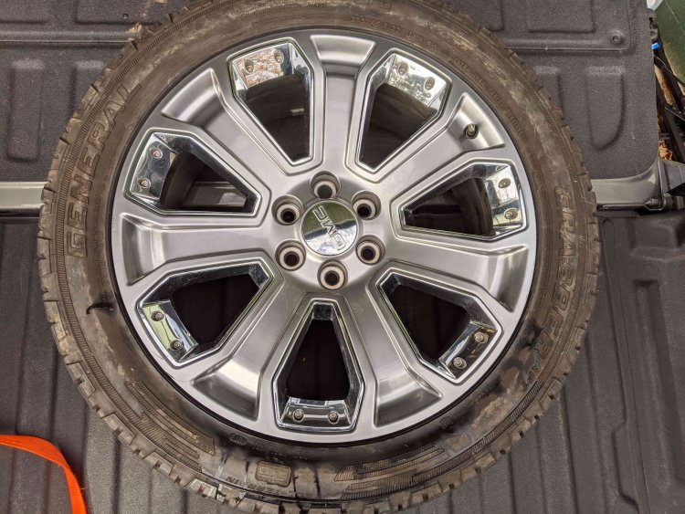

  9. 4 2017 GMC Sierra Denali take-offs with General Grabber APT All-terrain tires. Tires have ~10k miles on them, plenty of tread left as can be seen in the pictures. These tires are fantastic, I miss them already, they are surprisingly quiet for how aggressive they are. Diameter: 22" Width: 9" Offset: 31mm Backspacing: 6.22" Tire size: 285/45/22 TPMS Sensors: Not included, swap your own in. Lug Nuts: Included One of the wheels was bent on the back-side on a pothole a couple months ago. It was professionally repaired by Real Wheel in Black Mountain (would highly recommend them). I've since put ~500 miles on the wheel/tire without any issue. Repair is even difficult to spot unless you know where it happened on the rim. Normal amount of wheel weights on the Rim. $1,400 OBO Willing to meet within ~100 miles of Asheville, NC or can meet in Raleigh, NC.
