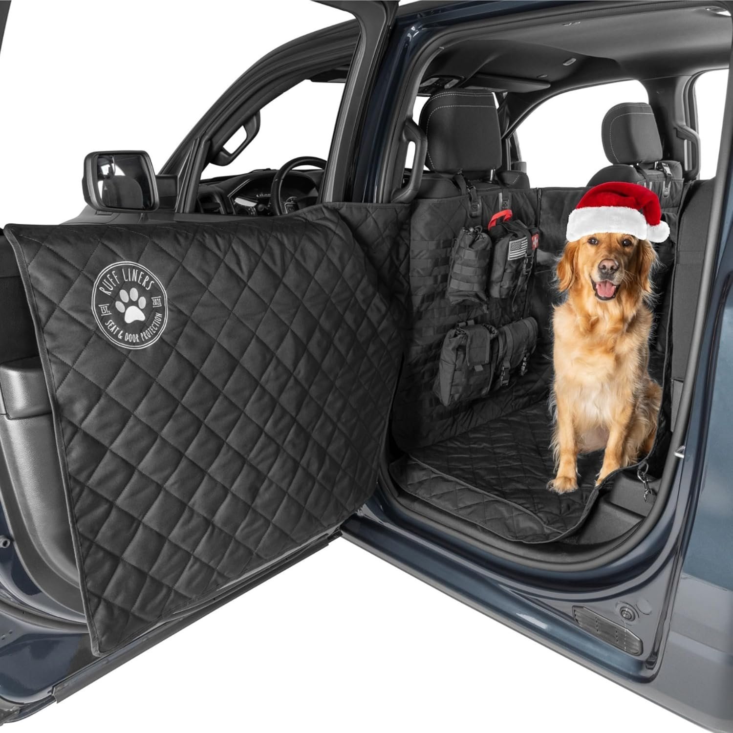

It has plastic trim pieces that insert into the window channel then the door covers velcro to the plastic pieces. The bottom is a hard deck so the part that overhangs is rigid. I have 2 84lb Aussies. No problems. The deck is split into 3 sections sealed inside the fabric. So it folds up into a square when not in use. Has a carry bag it all fits in to. -
