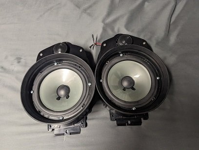

  7. I put the jl c2 650 components in the door where the 6x9s were previously. I extended the wire connected to the stock 6x9 to the jl crossover and then ran wires from the crossover to the tweeter and 6.5" speakers. In the end, I ended up going from a 7 speaker bose system to a 10 speakers in my truck.

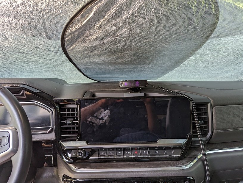

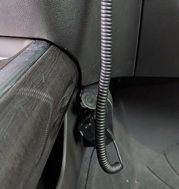

  13. Quick update. Got all the speakers installed, installed another set of USBs to power my ambient lighting, installed 2 12v sockets, and made a mount for my radar detector (won't mount it to the windshield because I got it tinted with ceramic tint). Just took out the rear seat today to see if there is room to build an amp rack and mount my 2 amps to it. Has anyone built an amp rack to go behind the rear seat back? Any tips or suggestions? Toying with the idea of mounting the hd module under the front passenger seat. The only hold up with my sound upgrade is the LLJ harness (still waiting for it, 3 months now) it's only a month past the initial promise date for shipping. I wish pac or metra would hurry up and start making stuff (harnesses) for our trucks. I just bought a pac harness for my brothers F150 and made my own loopback harness ($60 bucks all in for the harness) including the speedwire and tesa tape. Only took about an 2 hours to solder everything together and tape up.
