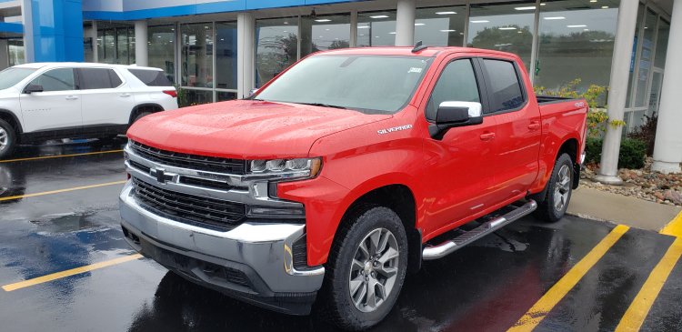

    2019 Chevy Silverado Crew 4Wh New Body Style, Pro Trailer Pkg

  1. Yes a 2019 Chevy Silverado crew 4W with Pro Trailering Package New Body Style
