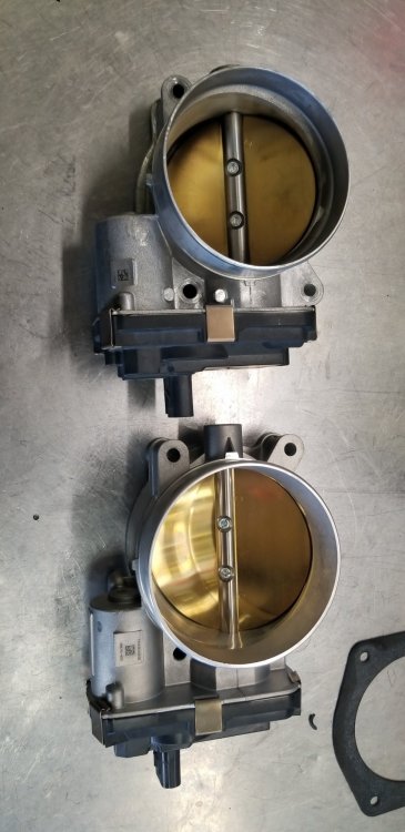

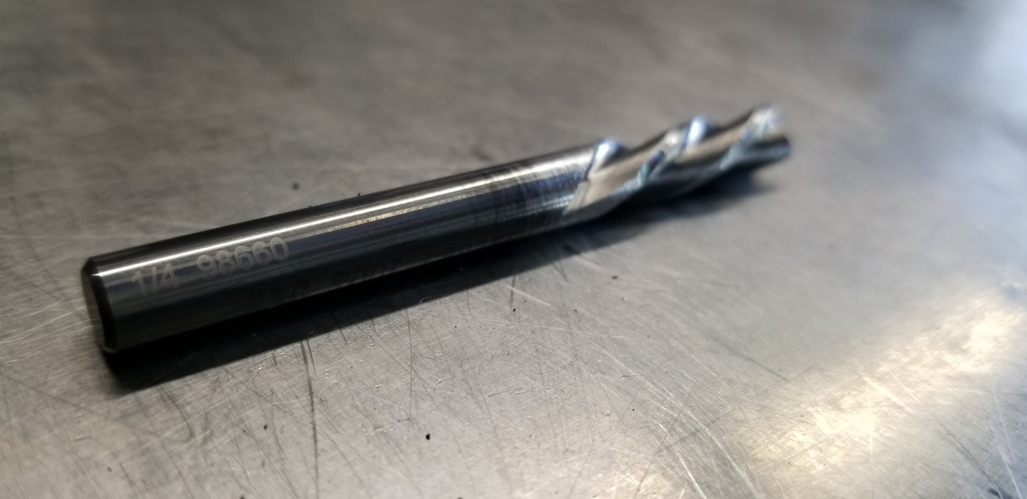

  1. I'll have to upload to youtube since I can only do 9.1mb here

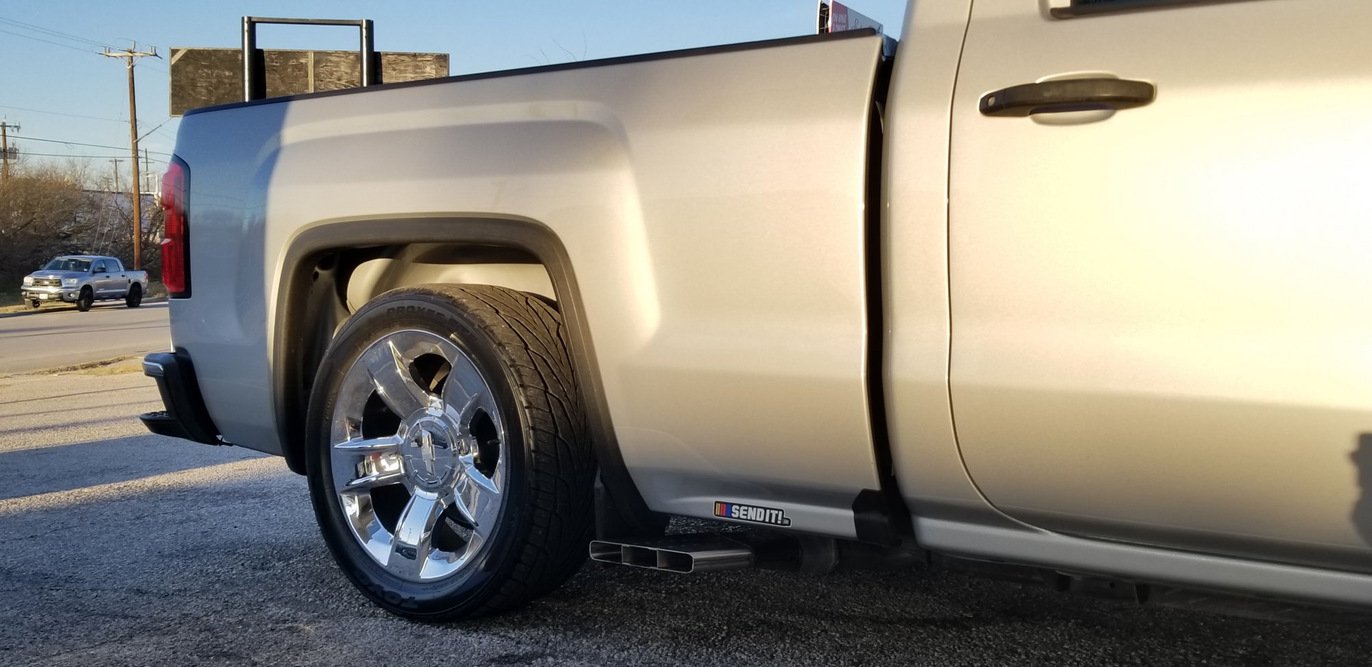

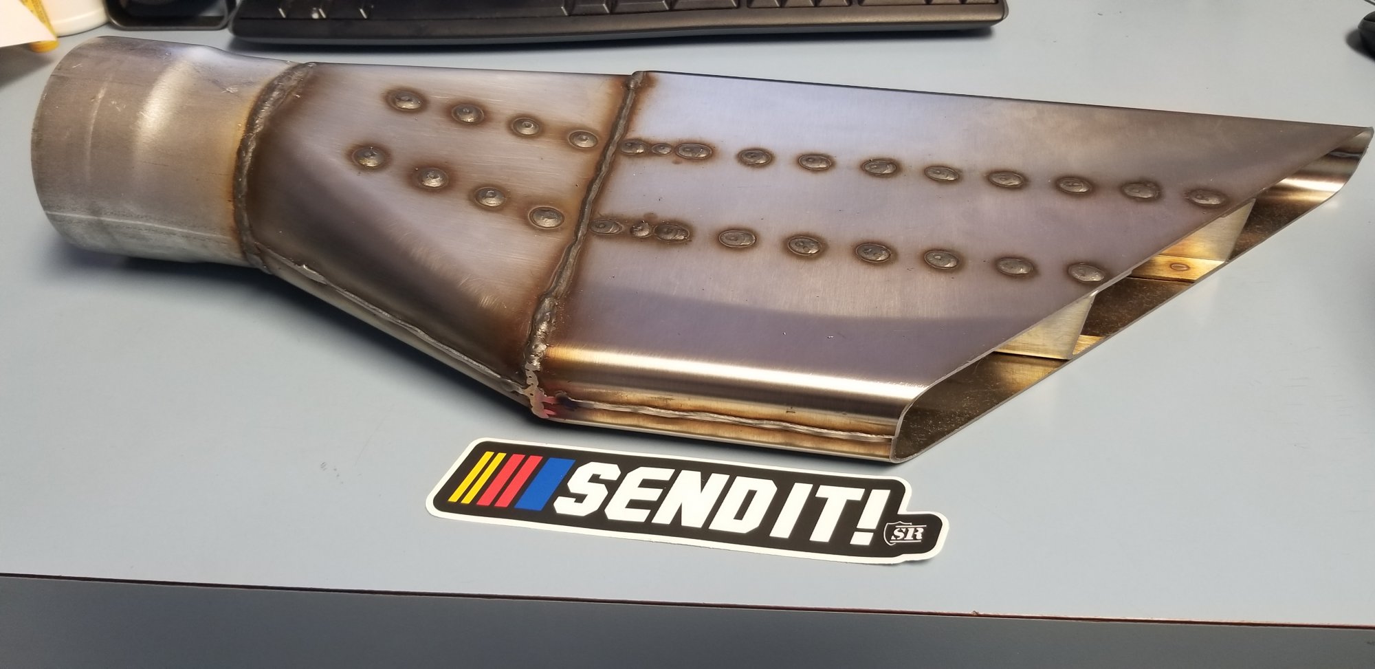

  2. TSP headers and y pipe with stock resonator (as a muffler) and the boom tube tip. Absolutely love this setup and hopefully soon can learn to weld a stainless 3.5" or 4" setup.

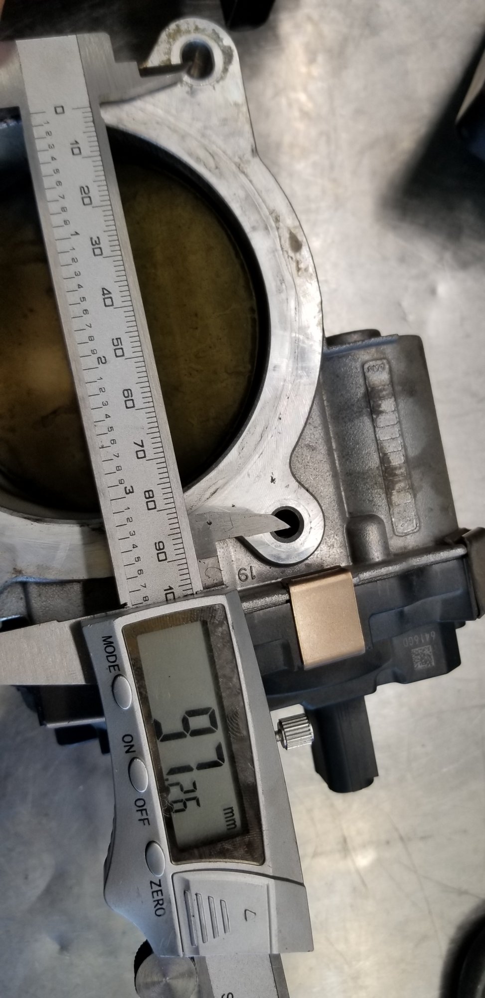

  3. L83 TB bolt holes about 97mm apart L86 TB bolt holes about 104mm apart This is the MAC bit my tool guy had on his truck and worked effortlessly. PN#98660 1/4 diameter.
  4. From what I've seen the bore is way to small for the lt5 to match to the l83 or even l86. Lt1 as well will need alot of material to be removed to match. I have all 3 TBs (lt5,l86,l83) and not sure if the l83 and l86 are same bolt pattern
