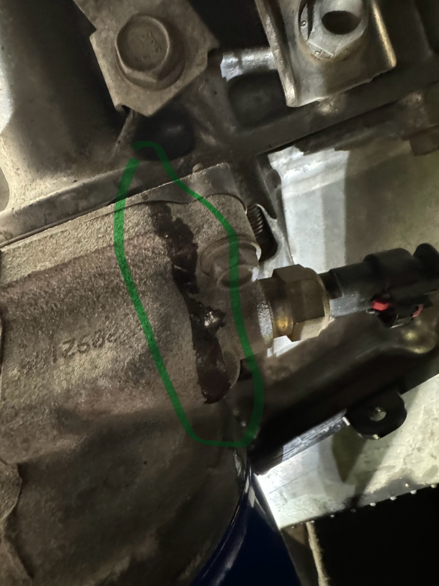

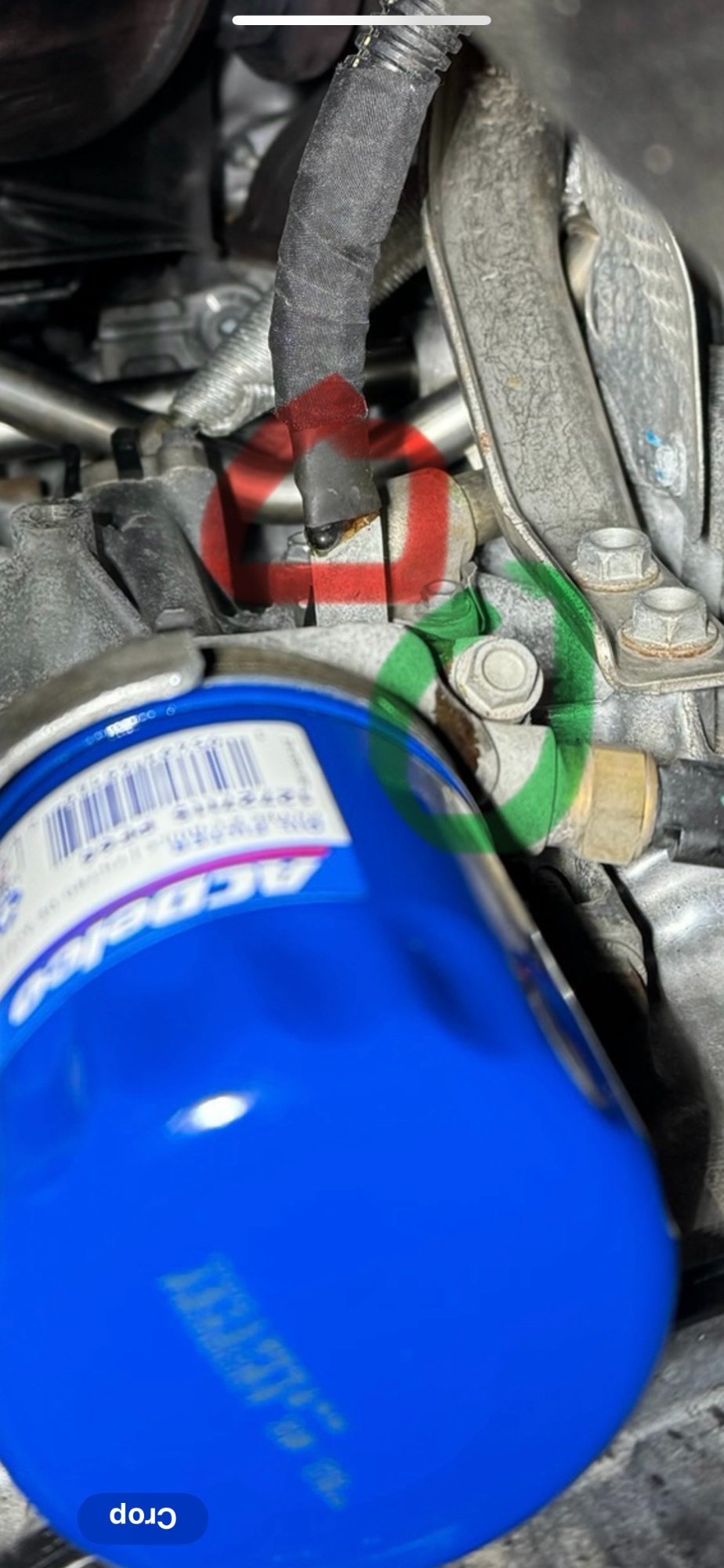

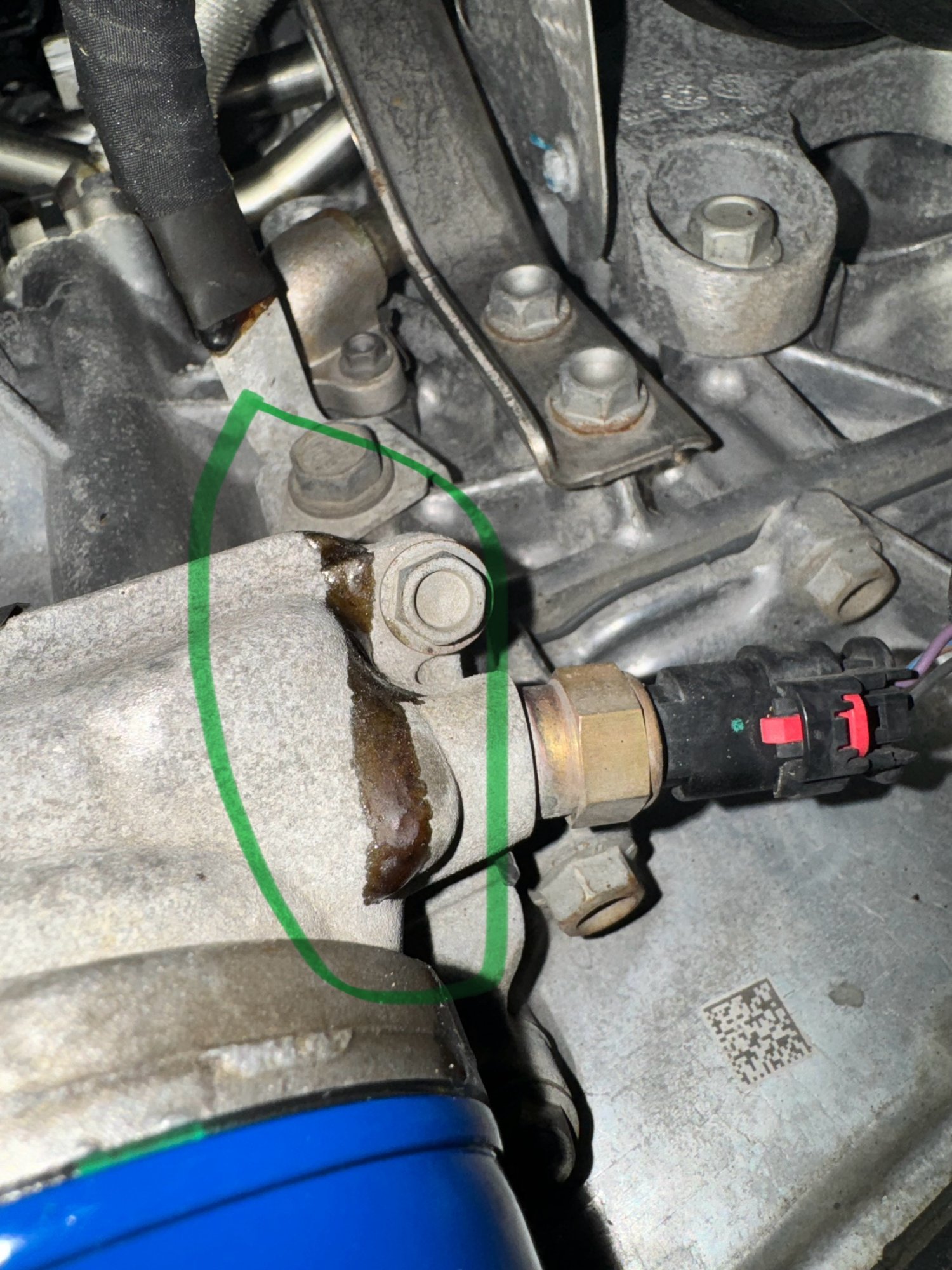

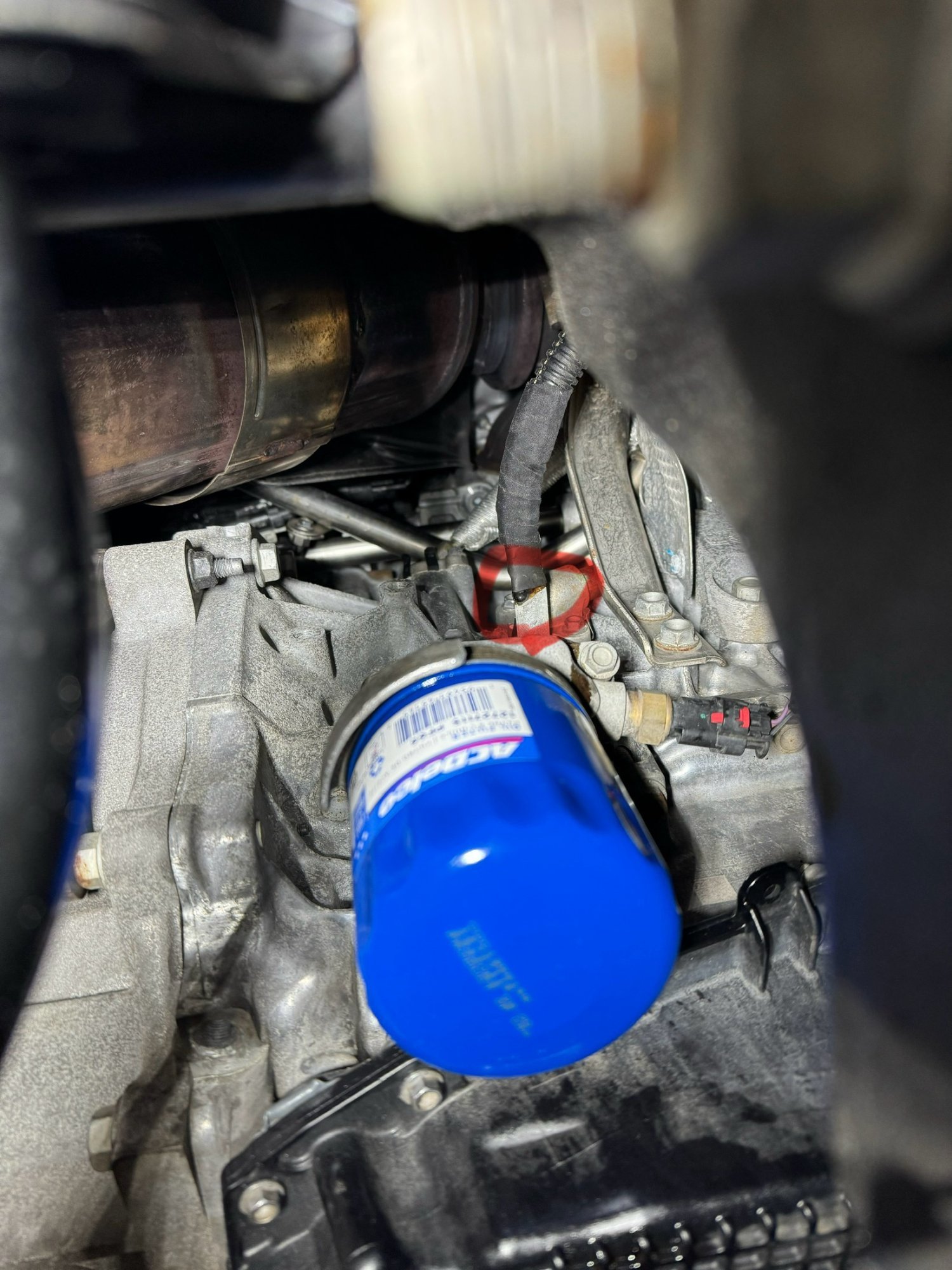

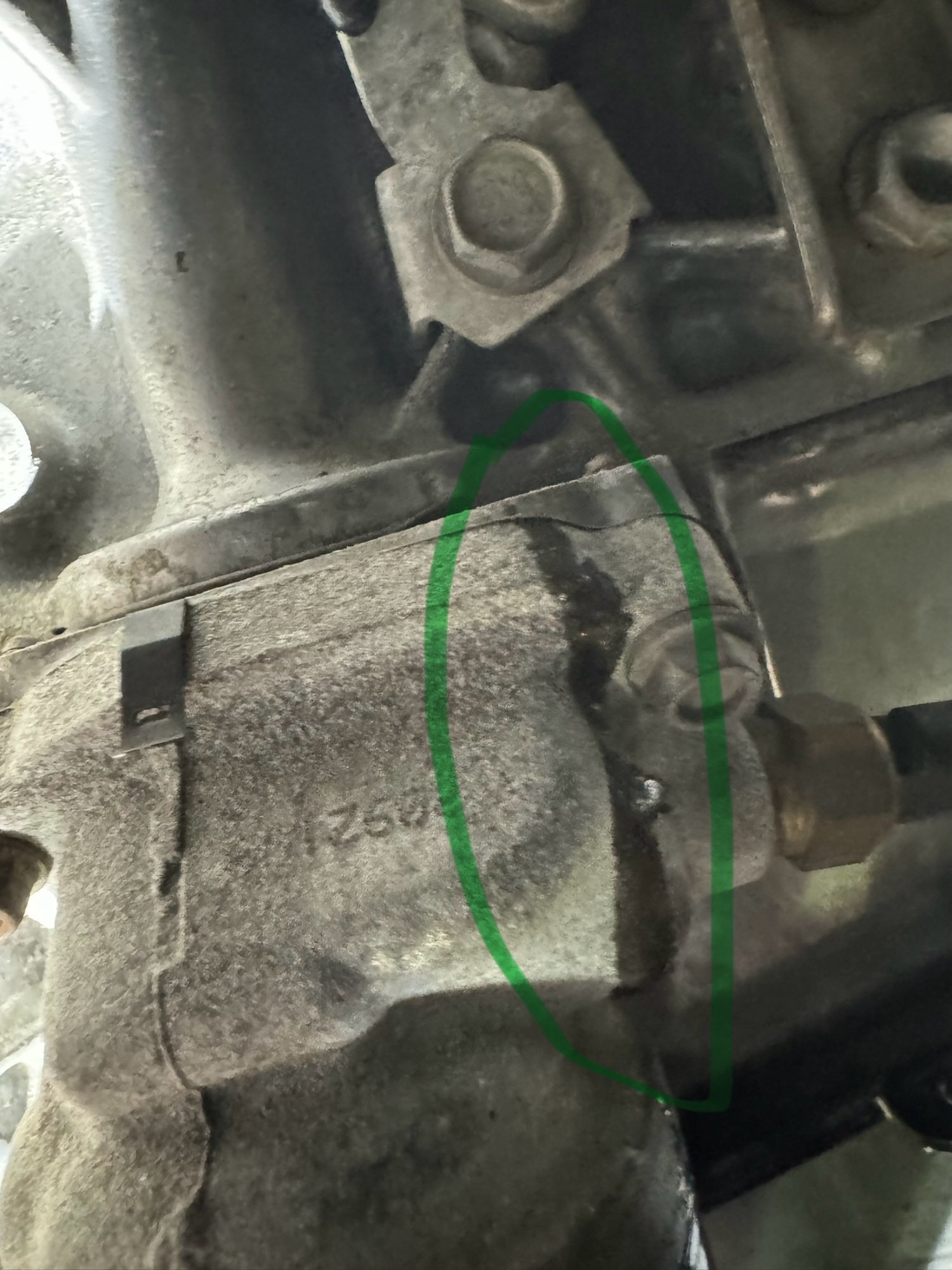

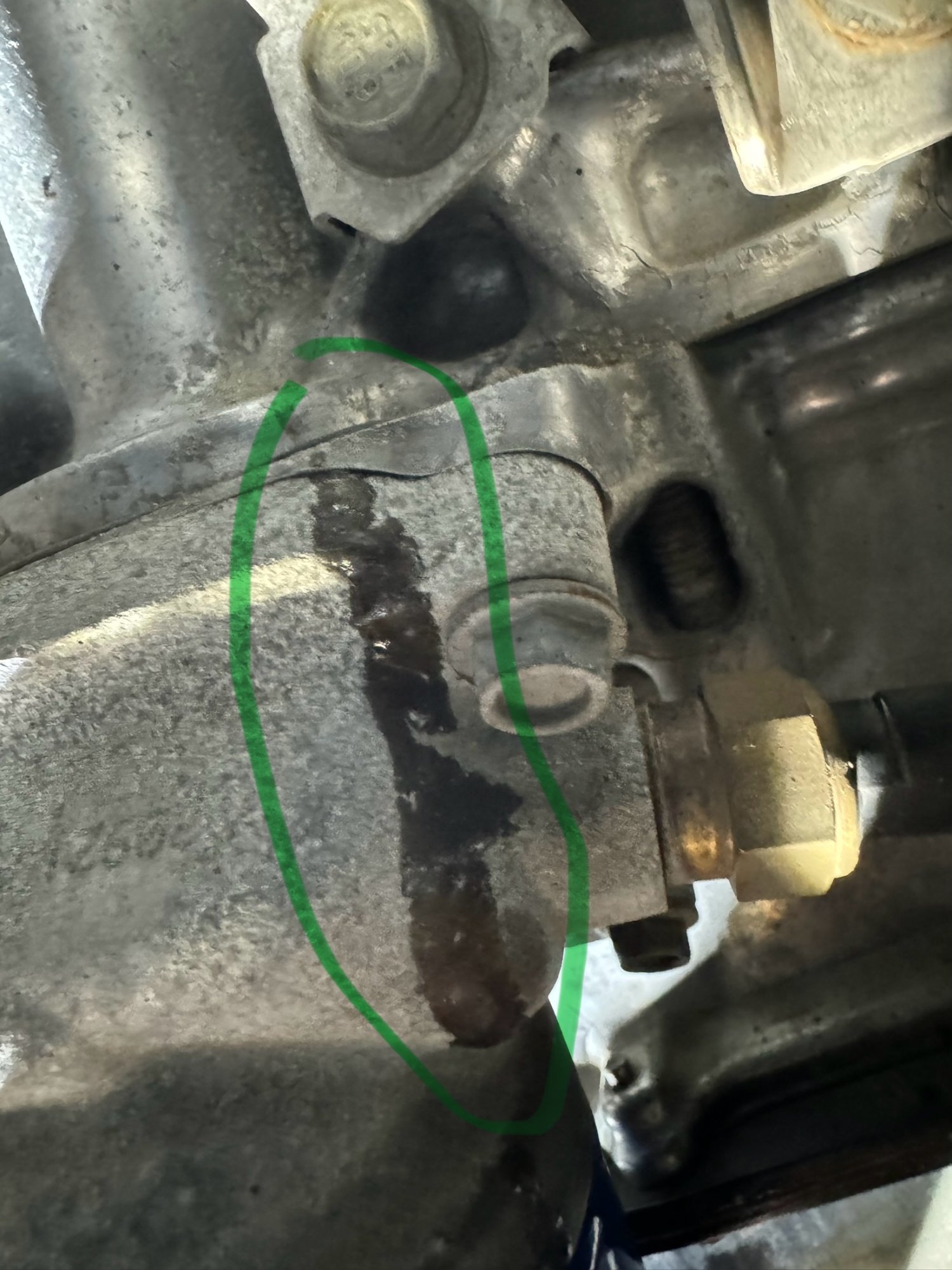

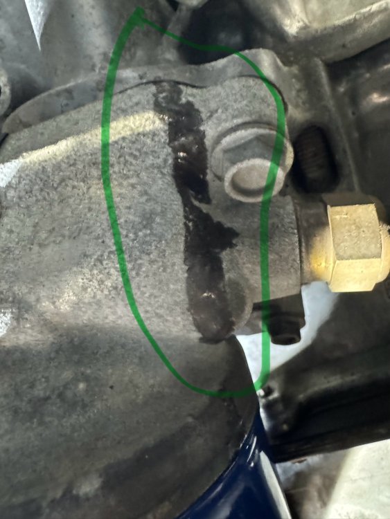

  15. Thank you so much Gangly!!! I took more pics for a better pic but it is very narrow... it does not feel like a "leak" but some kind of rubber-like coating material..... It feels very similar to the hardened polymer material in red above. That in red might have dropped to in green when my truck was built? I don't know why it is there... Again, otherwise, no other leak signs... weird. I appreciate your expertise.
  16. Hi, I found an old already-dried leak from the black hose (pic 1) above the oil filter when I changed the engine oil today. Looks like it dropped somewhat (pic 2) before being completely dried. I have not noticed any drops in my garage. Again, this leak must be old because it is very hard and all (in red & green color marks) dried when I touch it. What is it? Should I go to the dealer to check it? Mine is a 2022 1500 LTD LT 2.7T. Thanks. The top of the pics is towards the front of the truck and the bottom is towards the rear.
