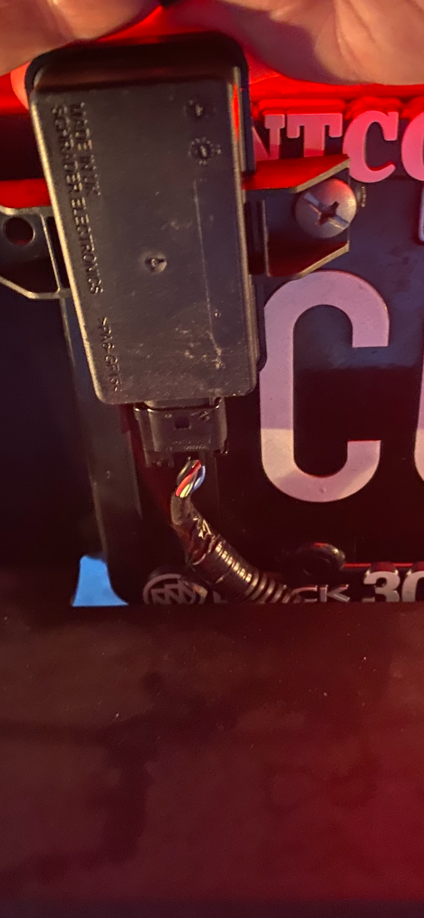

I moved what I believed to be the antenna. There are two that clip on a m0unting plate behind the license plate on one bracket. The smaller one I believe is for the keyless remote & the larger one is for the sensors. I just disconnected it from the bracket and used one of my tag bolts to connect outside the tag temporarily. There was enough slack to do so. I can take a photo latter today and post if you would like. -

I traded my 2020 3500 GMC for a 2021, it was no different as far as the signal went. i just went on a long trip. before i went I moved the antenna to the outside of the license plate to see if that helped. It did. I have a tri axle Toy Hauler and before moving the antenna i was constantly getting messages for loss of signal on the rear wheels & also the center axle. I now will get a message for the rear wheels abut once an hour which is much more tolerable. -

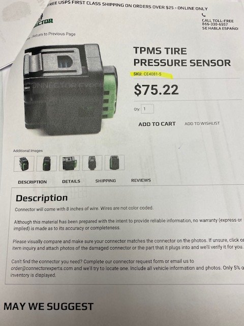

I've posted these before. I know they are expensive but they are available .I have spoken to connector experts. We use them in our body shop all the time. I don't have the electrical knowledge to know how to wire it correctly so there is not an issue or I would have done so by now. If anyone is successful please post the instructions ! Andy -

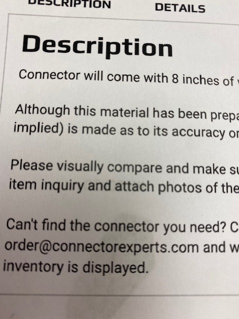

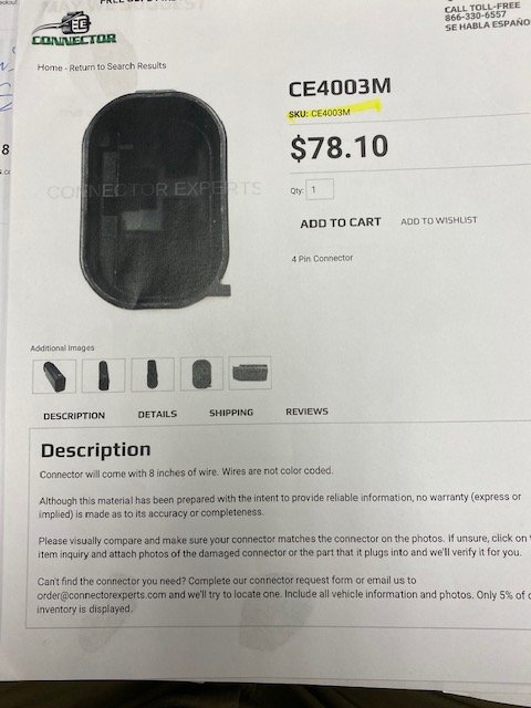

The lower photo part number CE4003M is the female end. I verified this with connector experts through a phone call. Both ends are pinned and Have 8" of wire. I just have no electrical background and do not know how making up an extension harness would effect the operation. That is why I am hesitant to buy the connectors and run an extension wire to the trailer to mount the antenna there myself. -
Trailer TPMS sensors loose signal
Andrew Best replied to Andrew Best's topic in Troubleshooting, Warranty & Recalls
Found this today when diving into this again after three weeks of conversations with GM going nowhere. I believe these are the male and female connectors needed from Connector Experts (866-330-6557). We use them all the time in our body shop. If anyone has been successful in extending their range please let me know. -
