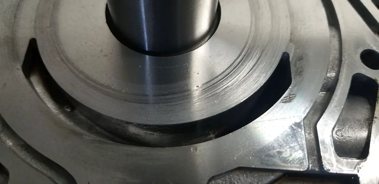

Got the truck back yesterday. $4,500 Shop describes the problem coming from the fact that the stock converter has lugs that are welded on the outside of the housing instead of it being stamped or machined. This welding causes internal warping which leads to the failure. I had them take photos of the internal damage so that I have the documentation for possibly being able to recover costs with a class action law suit. They haven't sent me the photos yet, but I saw them on the owners phone. Magnet looked like donut with so much metal on it. He also had a picture of the scaring and the burnt clutch plates. As soon as I receive those I'll add them to this post. -
