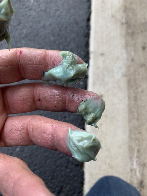

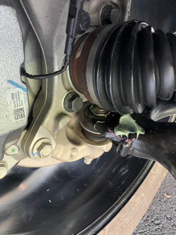

  3. I posted on another thread about my cv axles leaking. I have the Eibach pro lift kit which is as adjustable front strut, coil springs and rear shocks. It’s probably just over 2inches of lift. The dealership installed it and maybe a month later I had green grease all over the inside of the front wheels and control arms. The dealer is ordering new front axles currently back ordered. I asked about getting the trail boss cv axles he didn’t think there was a difference in length. There was also glue around the cv boot on both sides they may have been torn and repaired. I’m not sure this is how it comes from the factory.
  4. The cv axles angles don’t look bad . I have the the wheels turned all the way to one side so I can take pics and clean up. The other side also had some of the glue but a small amount. The GM level kit comes with new cv axles possible longer . I might get a quote for those or new axle boots. I don’t want a patch job on a new truck. I was trying to find a part number for the trail boss cv axles.
