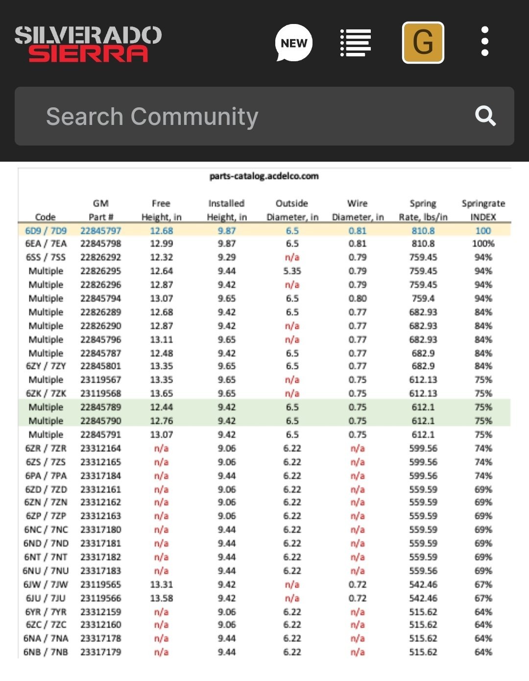

TireTech, a member from another forum compiled the chart I attached. It turns out he too has the same spring rate as my truck, which is 810lbs.. the highest you can get due to a snow plow prep package. Knowing that I'm running that ridiculous spring, I'm going to give a lighter oem spring a shot. He went for the 612 lb springs. I think I may go for 515lb springs. Or try a KYB strut with spring assembly for a 2015 Tahoe RWD. Just waiting to hear back from them on spring rates. My truck is a good guinea pig for the light spring, I'll eventually post when I get to try them out.
Just a quick reply on my phone here. No offense taken at all to any of that, all valid points. You are correct in saying off road suspension is really not being utilized. I guess my issues is, the regular cab short box trucks are sprung for big payload and I'm assuming share the same front coil as the heavier trucks so it rides like a lumber wagon. I can't go buy off the shelf front coils that have a spring rate I'm looking for, so I'm forced to go custom off road stuff. If a 2.0 shock will give me the ride I'm looking for I'm happy. If I could buy a $150 Monroe shock and coil setup that doesn't ride like a pogo stick I'm also happy. My truck sees 30mph driving around rough roads. I rebuilt it from salvage, so it has a unique use case. Have a dually for heavy stuff etc. Just on a mission to make it ride nice, and enjoy talking/reading about it. Appreciate your input!

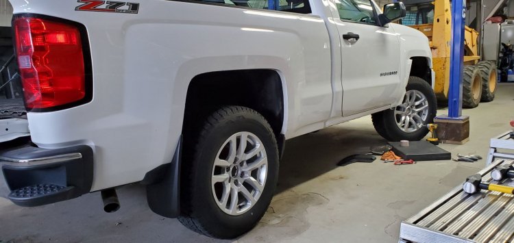

Thanks! I actually forgot about the rear bumper! Yes that was the plan, I need to start keeping an eye out for a painted one. I have a feeling I'll have to go new though. The other thing I need to change is the box cover. I put the fiberglass solid cover on that it came with, but that has to go at some point.

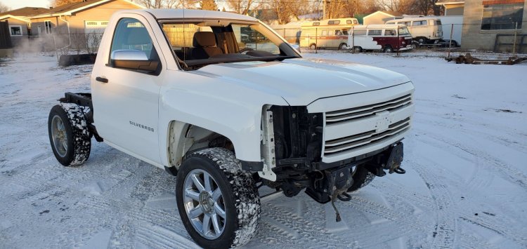

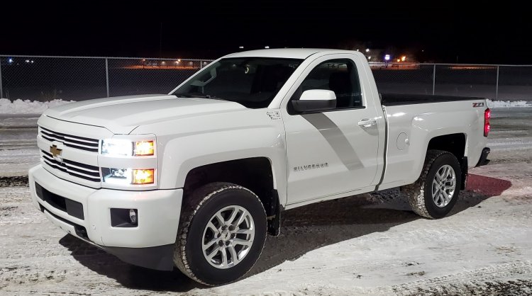

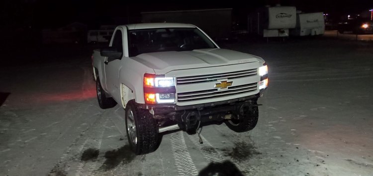

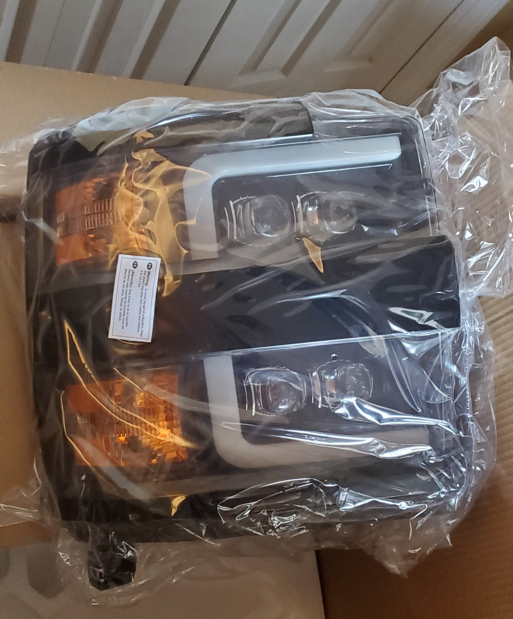

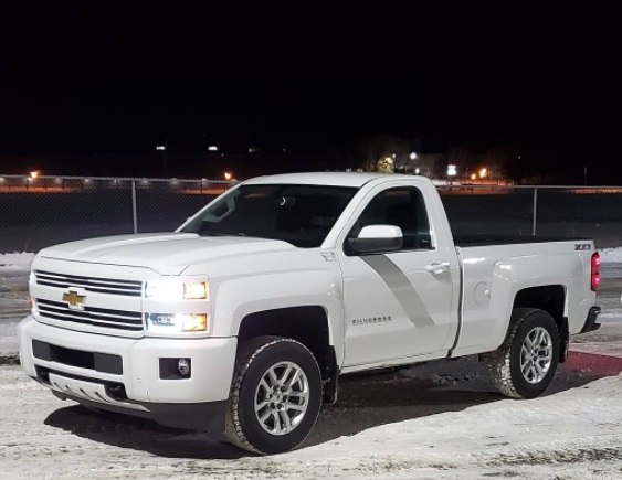

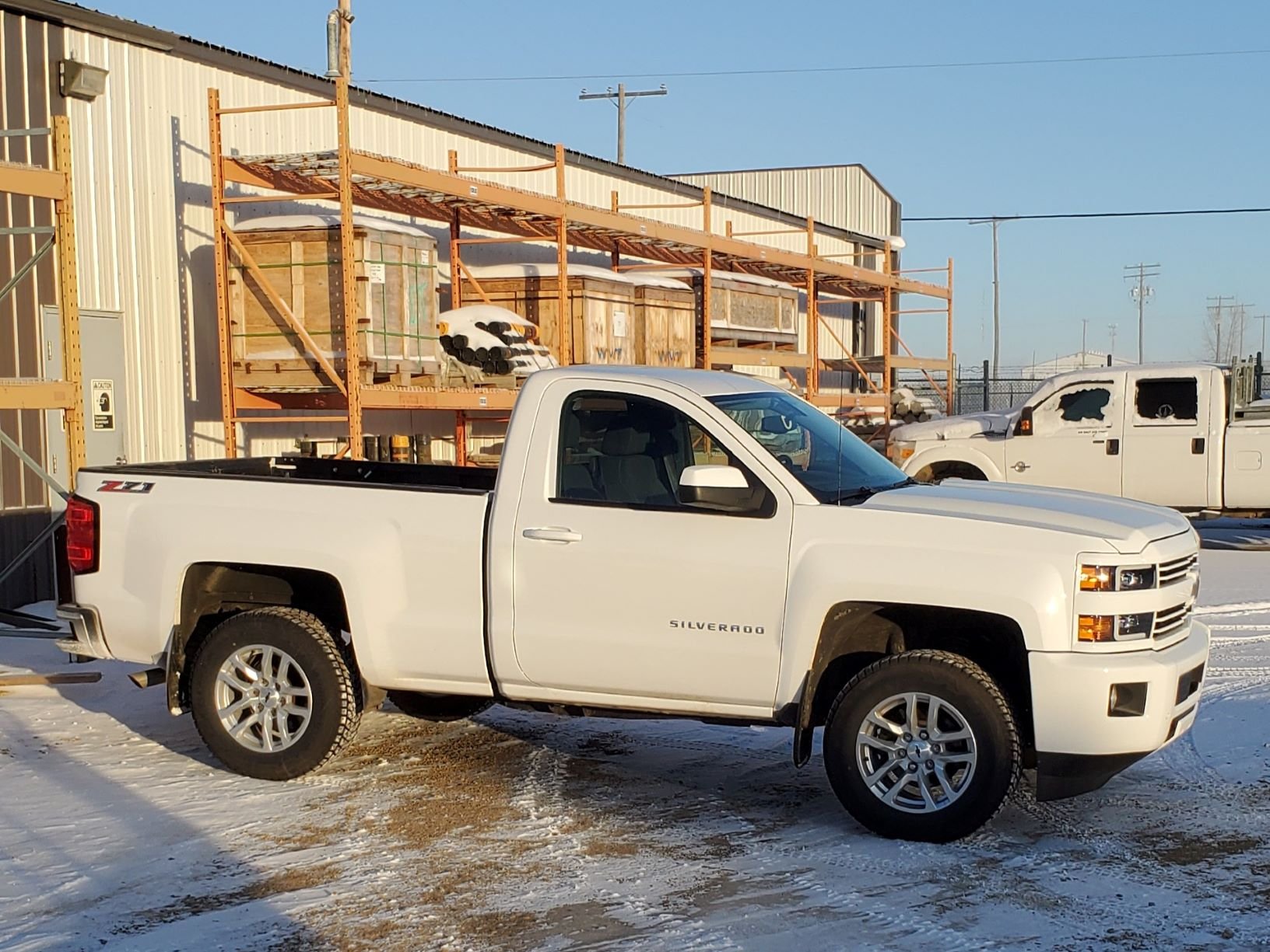

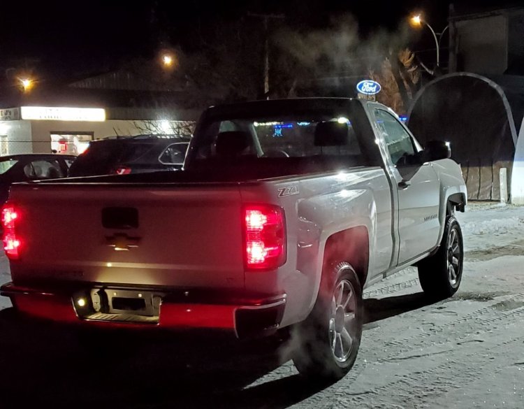

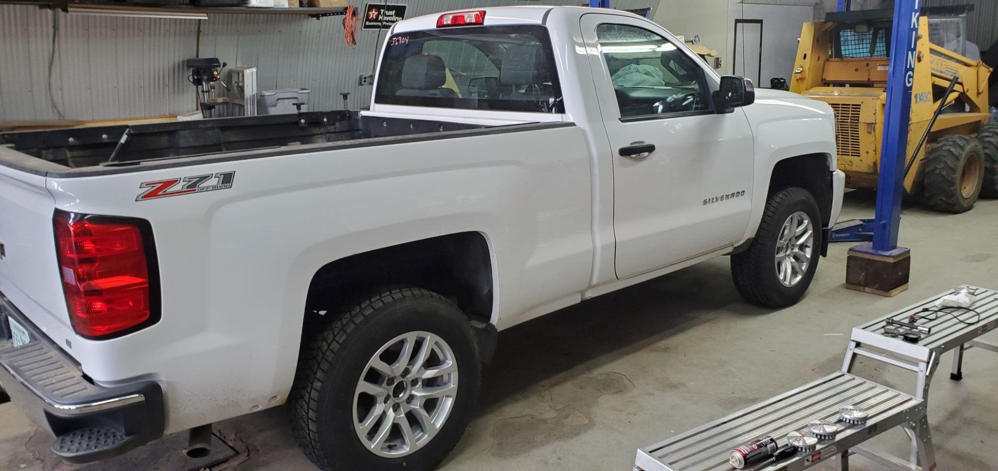

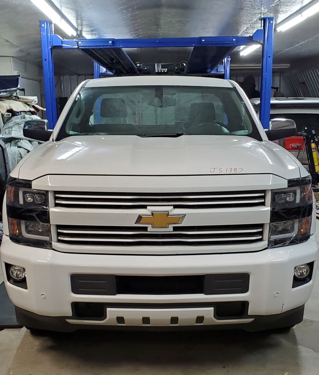

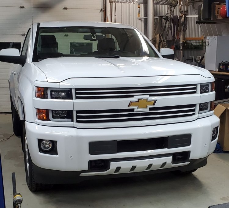

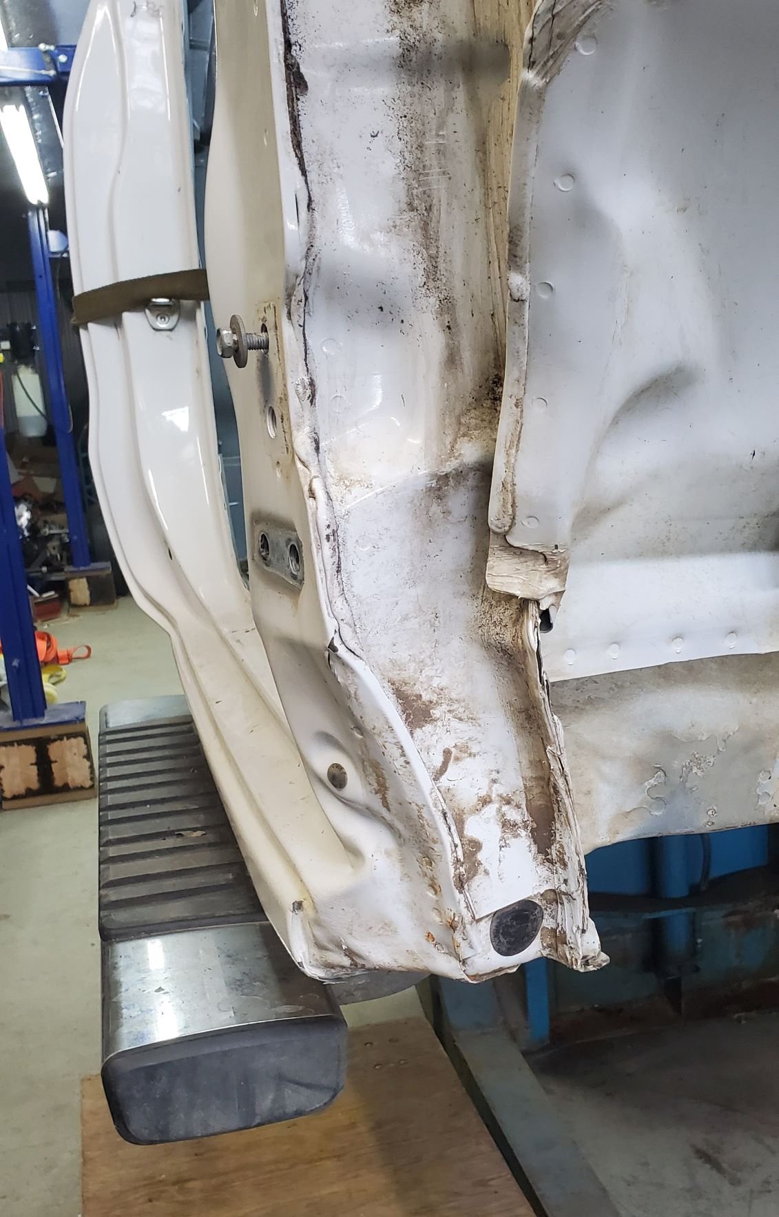

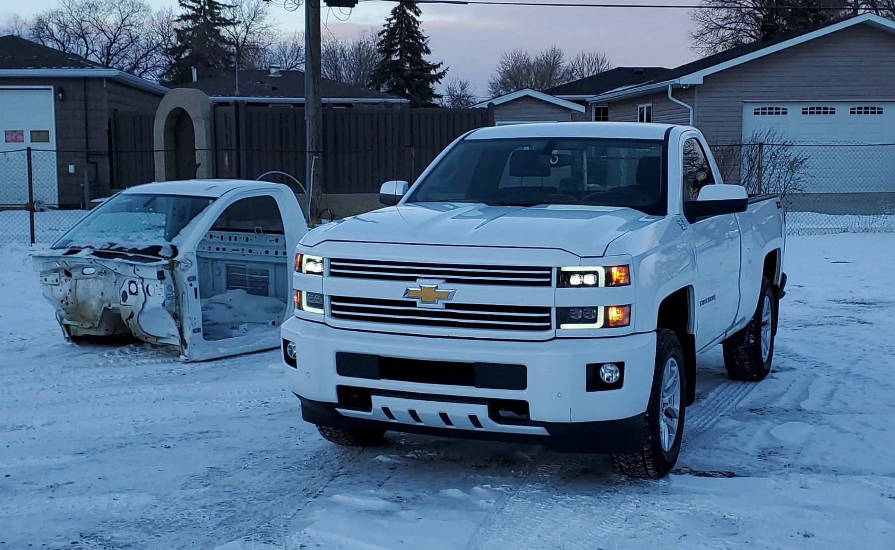

All assembled in the shop.. the lights look much better now. Still don't like them as much as OEM but light output is way better, with a clean cutoff and no blinding other drivers. Lights on Day time after some miles Beside the old cab Close up on the mangled cab.. I'm glad that repair wasn't attempted. For those that scrolled through and read it all, thanks for taking a look! I don't know if I'll do another one again, but it's cool to have a truck that I tore down and rebuilt. It had to pass 2 inspections to be road worthy again, and did so with flying colors. Anything that had damage was replaced. IMO the proper way to repair a salvage vehicle. It does have a rebuilt title now, and it's officially a 2016 model . Apparently the cab determines the year where we are. The frame is technically a 2018 part #. But built even after that. Maybe I have one of the last produced short box frames around who knows. What does the future hold? I need to replace the suspension and upgrade that 4" screen. Have been invested in Grumpy Bears 2015 Silverado suspension and want to go the route he did. Plus.. who on earth has studied it more than him? Foolish not to take advantage of that info. The truck is currently resting for the summer inside, sorry about all the winter pictures but it was built for a purpose and winter driving/fits in my small garage is it.

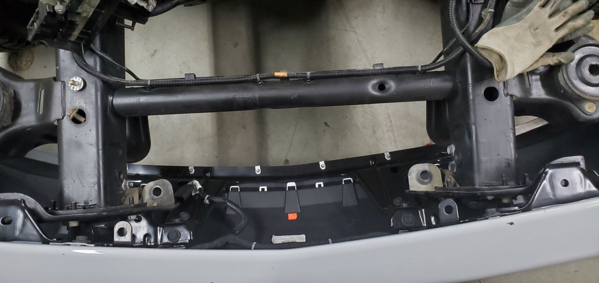

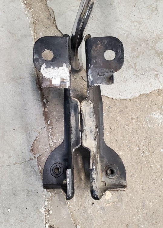

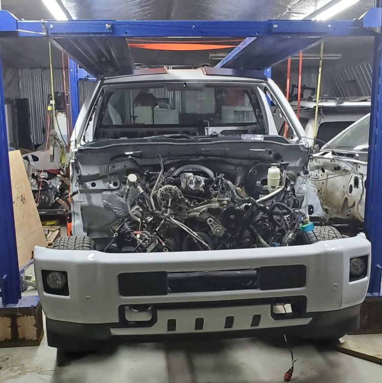

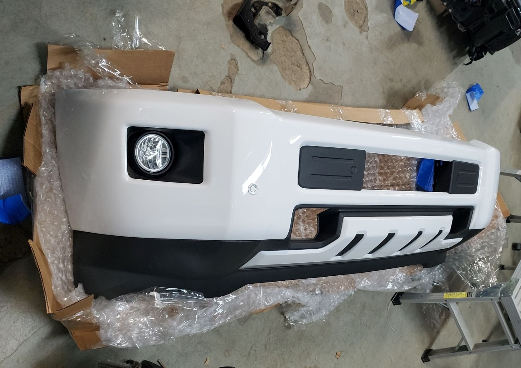

Had to set on the new front bumper, this item cost more than the whole truck. Truck was $1500 CAD by the way. Two of the bolt holes in the HD bumper matched up with the 1500 brackets. Very thankful for this! Unfortunately details are vague on the bumper installation. I had to extend tabs on the frame horn brackets for full support The other thing I did was re-drill the 1500 frame horns and move them down all way, as the HD frame is much taller. I would've like to had HD frame horn brackets to try, but I was obsessed with proper fitment on the frame and safety. That bumper had to be as strong as OEM for me to be happy. On this test fit the bumper is sitting way too high. There has to be a cab below the grille. I was still figuring that out here. Somewhere around here the truck came to life again. I was able to put the other Sheetmetal on once I knew the engine bay was good to go. The feeling you get when you drive a project out like this was pretty good. Good motivation to keep rolling. I had lots of visitors pointing out how crazy I was... lots of fuel to keep going. Box went back on Had to try out the lights, hated how they looked here. You can see how badly the truck needed paint correction here. Hey it was a $1500 write off, it didn't have a great past! Back to bumper alignment. Starting to get it figured out, that bumper was on and off probably 40 times. Starting to look like a truck Box liner kept the bed nice at least! I wanted to stick with 18" Wheel for ride quality, found some used off a 2019 wrapped in new Blizzaks. Perfect for me, won't look super cool though. Function for me sometimes wins over looks. Husky brand mud flaps to kick the junk off before parking in the garage: I hated that fake chrome, had to order mirror caps, door handles, and a new gas door lid. The awesome body shop manager who convinced me to replace frame and cab did the spray job on these.

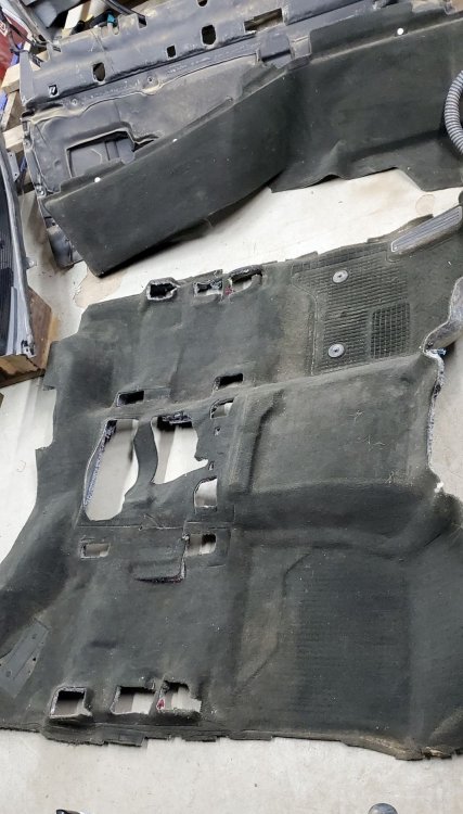

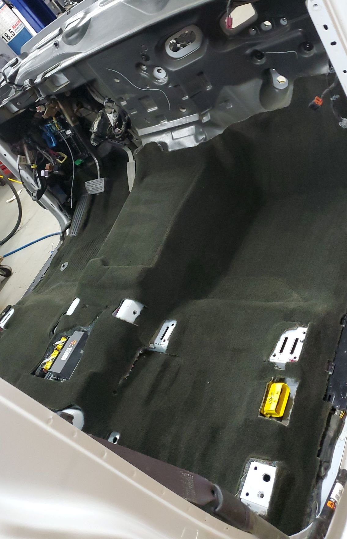

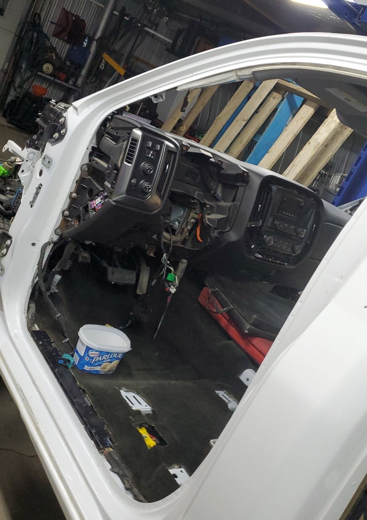

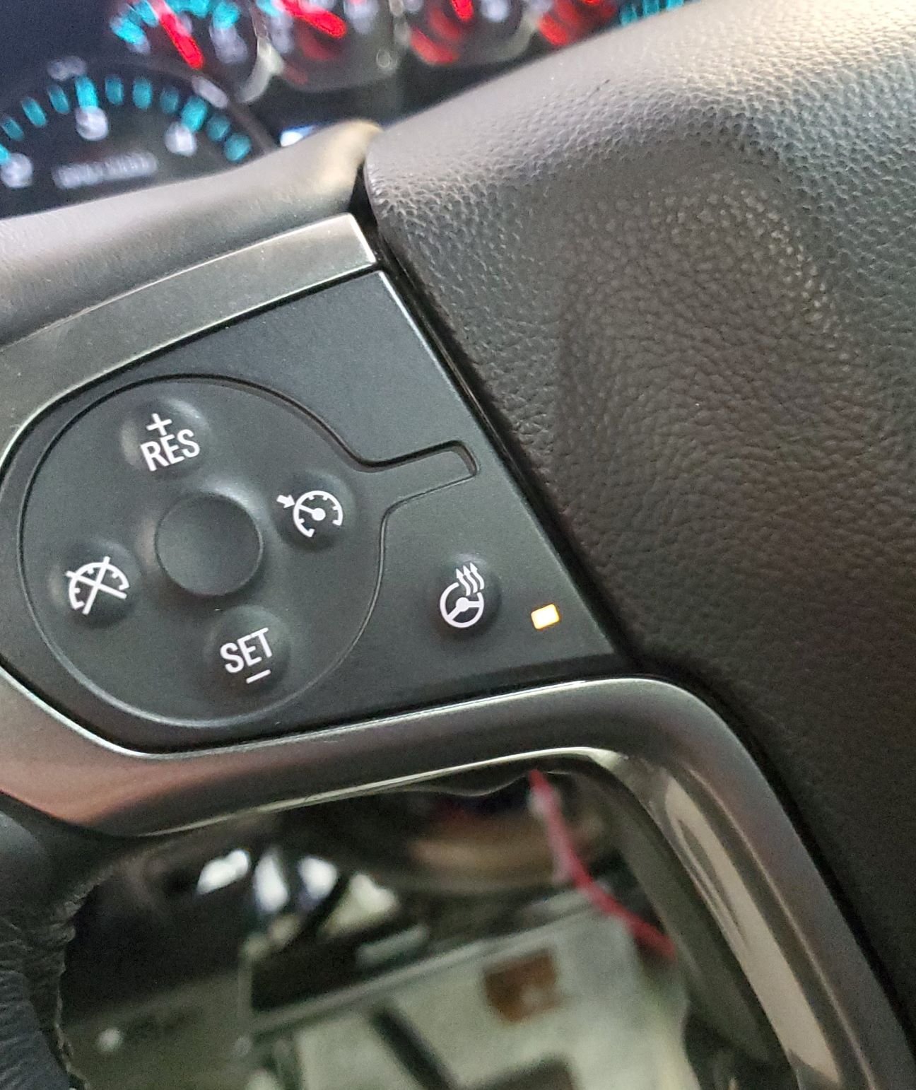

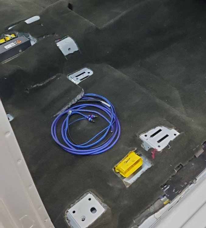

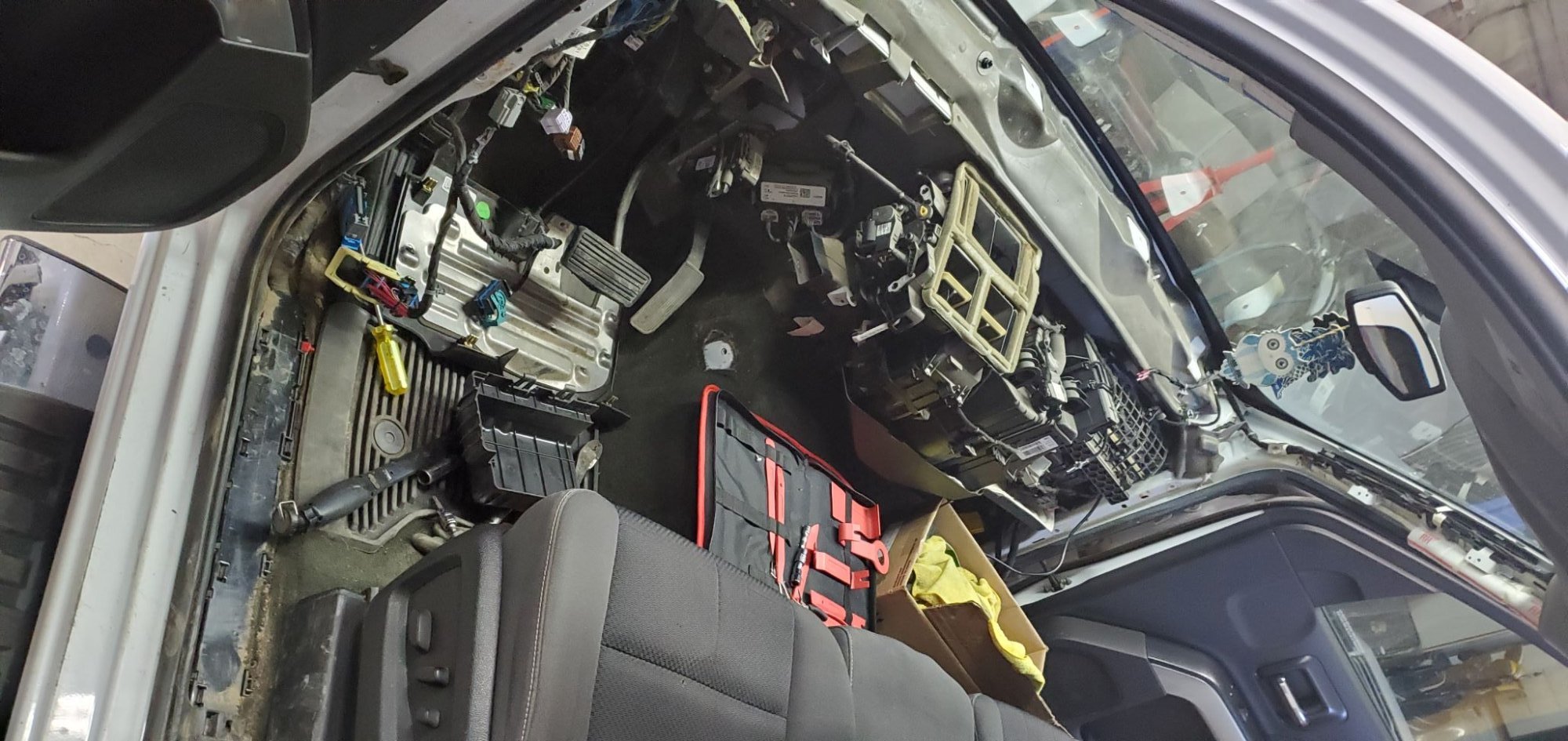

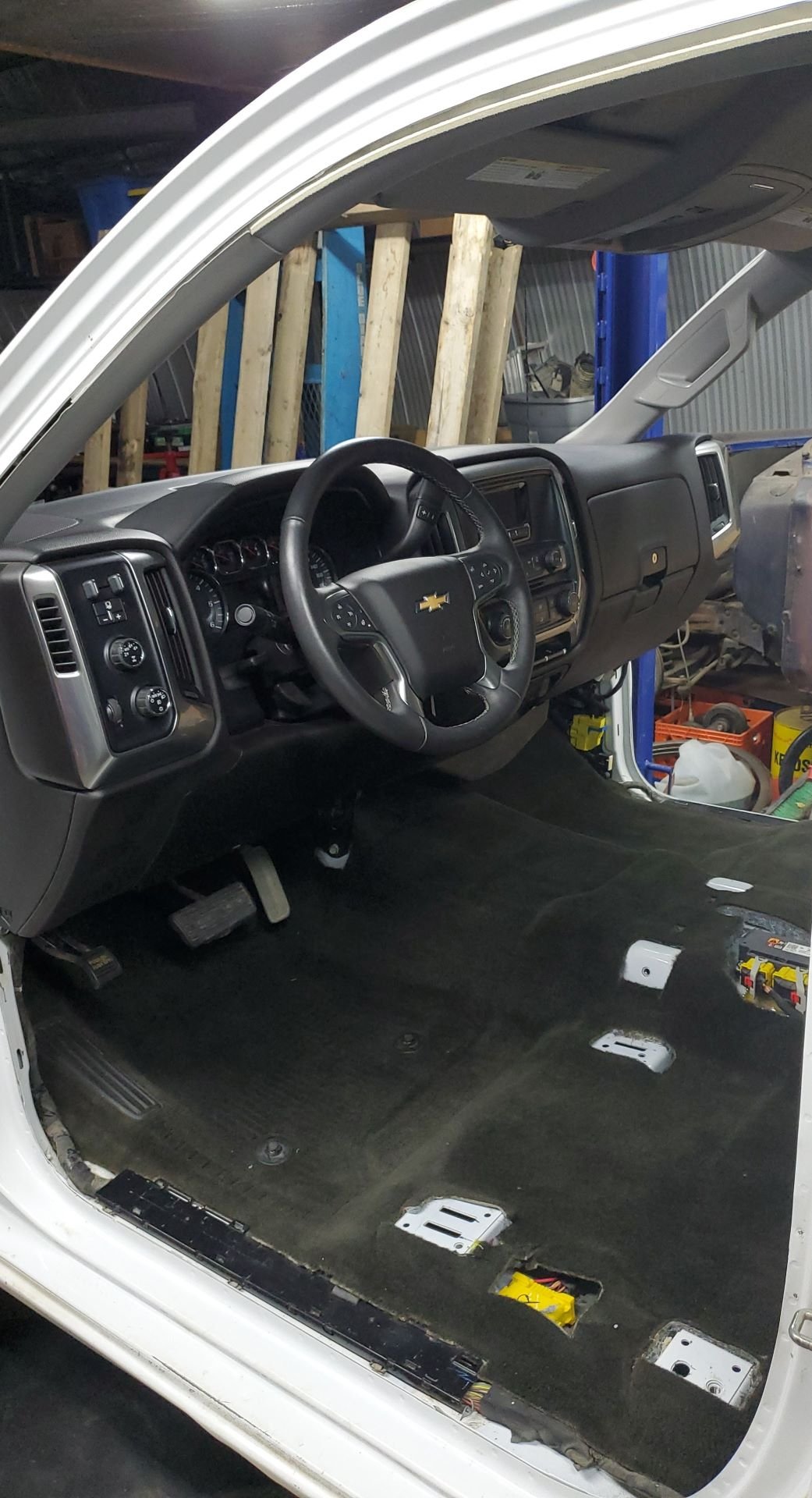

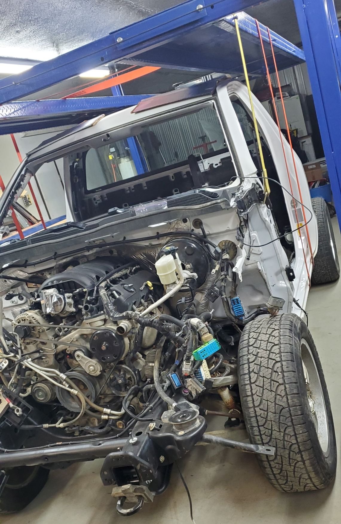

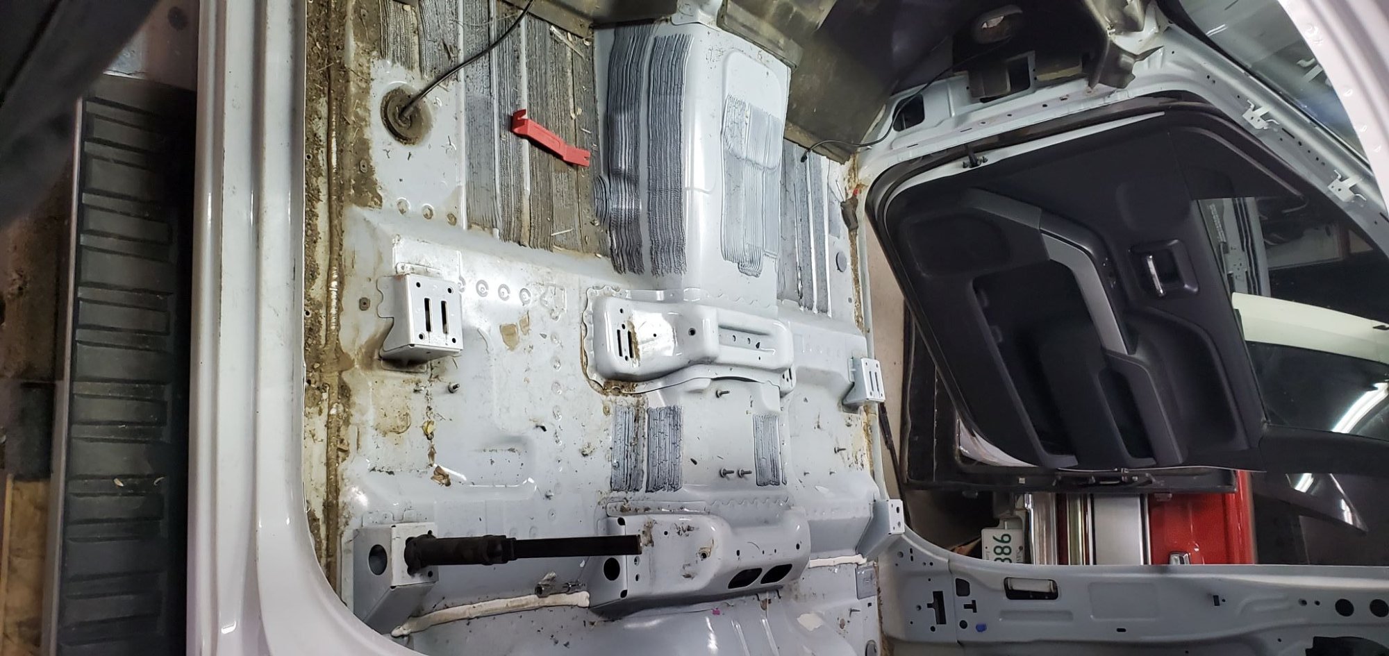

Tear down begins.. I was happy to do this. Truck sat for so many years I wanted to check/clean any rodent action. Dash out Definitely the worst part of the job. Taking a part a dirty interior carefully. Added just a bit of sound dampening.. used the 25% rule from advice from http://www.sounddeadenershowdown.com/ I was going to do a full 2 step treatment, but I had ridden in other newer trucks and was happy with the noise level. No regrets not going further, it sure is quiet. Also I plan on parking this truck for half a year. I didn't want more stuff to be damaged if rodents ever got in again, although I am in the city so it shouldn't happen. Install into the replacement cab I cleaned the carpets best I could without pressure washing, at the time I was trying to keep the project moving and making maximum progress day by day without many breaks. I was able to add amp power wire through the factory passenger side grommet for the most ultra clean short power wire run. Dash part way back in I ended up buying a salvage heated steering. This truck will be winter use only so a must have! I wanted OEM heated seats too but apparently that is next to impossible to put in easily. The wheel however was a piece of cake. Carpet got a bit dirty from me being in there but it's starting to come together. Now the cab can go on the new frame. Back to the 4 post with the lift kit

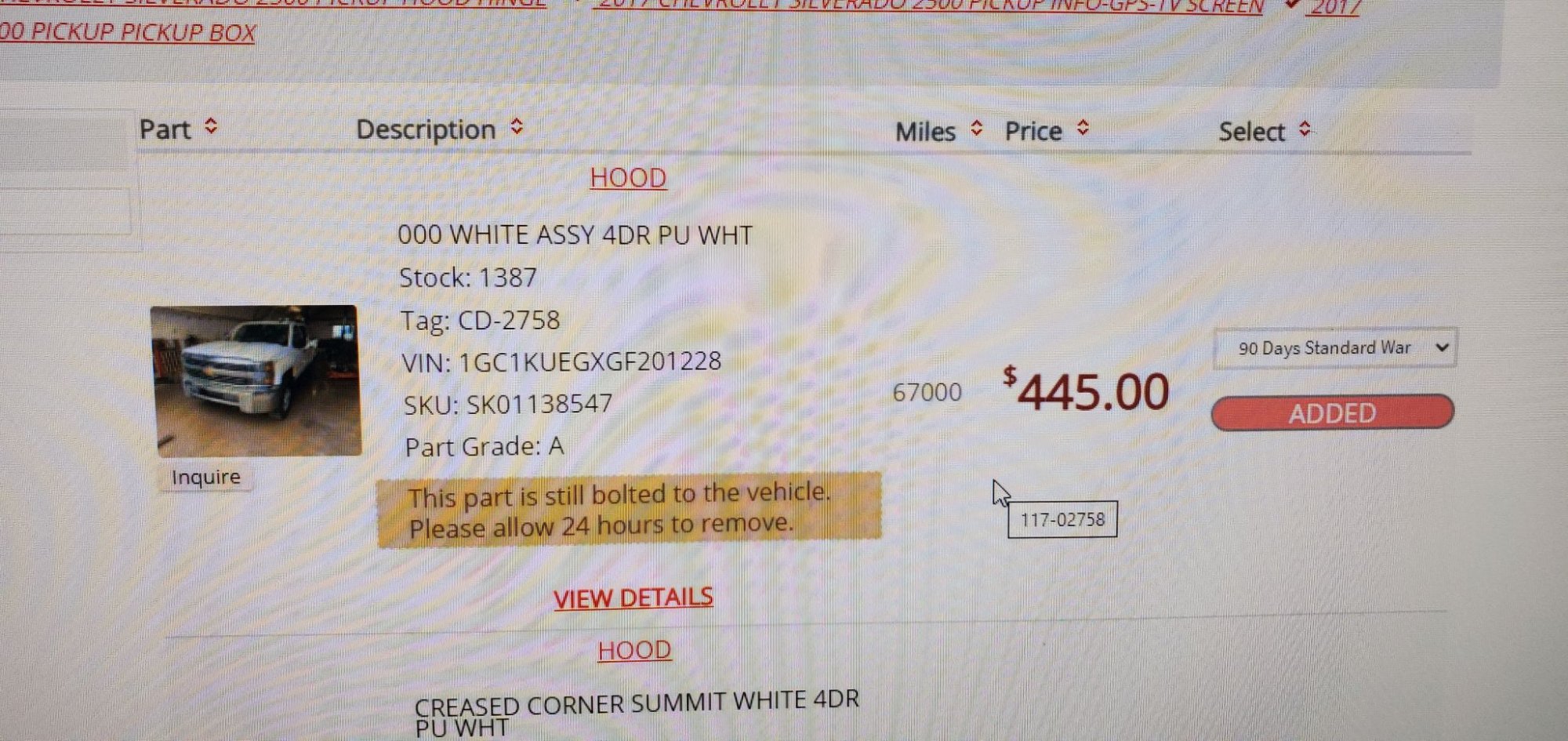

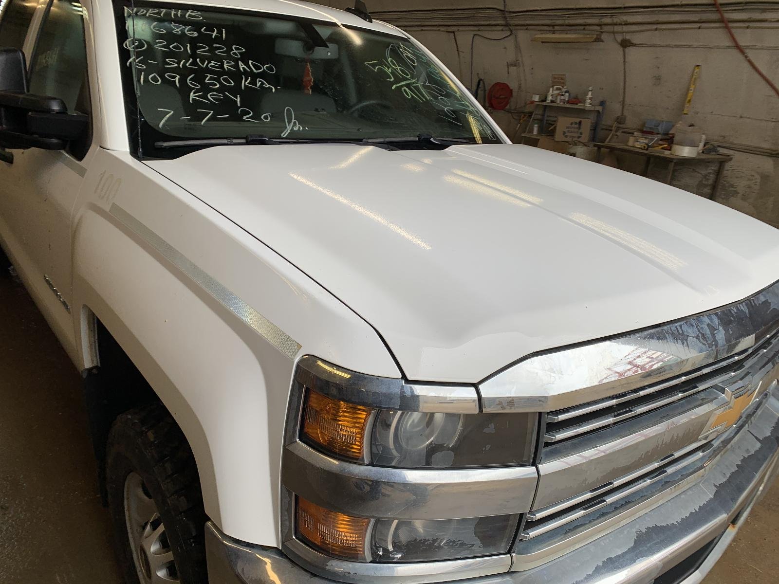

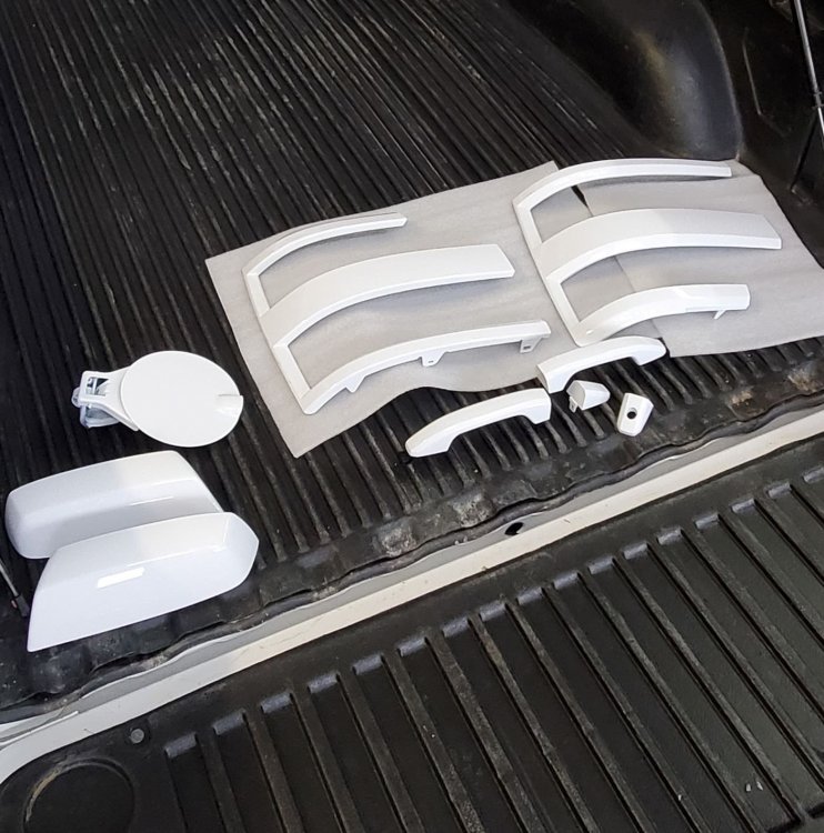

Around this time I had to decided on what front end I wanted to use. 2014 1500, 2016+ 1500 or 2016+ HD front end. It basically came down to what I could find locally for parts, and I did want to do something different. Budget was a concern, so I couldn't go with brand new stuff. Amazing how much that stuff costs in Canada anyway. White hood located I had found this picture online. It's actually a shortened HD truck. I wasn't going to have 14 wides or the Dmax scoop but it looked different from all the white half tons that I saw. so I decided to buy the hood above and continue. My not so cool hood, and right side fender from salvage. By far the most expensive part.. the HD front bumper. I was told by all salvage places if they ever did get a fully loaded painted HD bumper in, the whole front end would generally be bought by insurance for thousands. It was far too new to be a part out item. Most the the trucks coming it the bumpers were shot as well. So ebay it is... the bumper was $1417 USD with one scratch. Perfect ones were about $1600 at the time. It arrived exactly as described. The last problem was finding paintable OEM HD headlights. Impossible!! Same story with salvage, if they had anything good it would be sold to insurance. Also were at least $800 per side. I was bummed but I went with aftermarket. Lighting is important to me so I tried to buy something with quality parts. I went with AlphaRex® - NOVA-Series Jet more details on - https://www.carid.com/alpharex/nova-series-jet-black-drl-bar-projector-led-headlights-mpn-880217.html?singleid=3034430856&url=111014919 The quality didnt blow my mind, but they were about half the cost of salvage when they were on sale black Friday. They will be painted to match later. Before I got the hood I actually found a white grille just over an hour from me at salvage. It was $350 which was super cheap at the time, considering I could find NOTHING on any style front end other than the hood local. Ok so front end parts are now waiting. Onto cab swap.

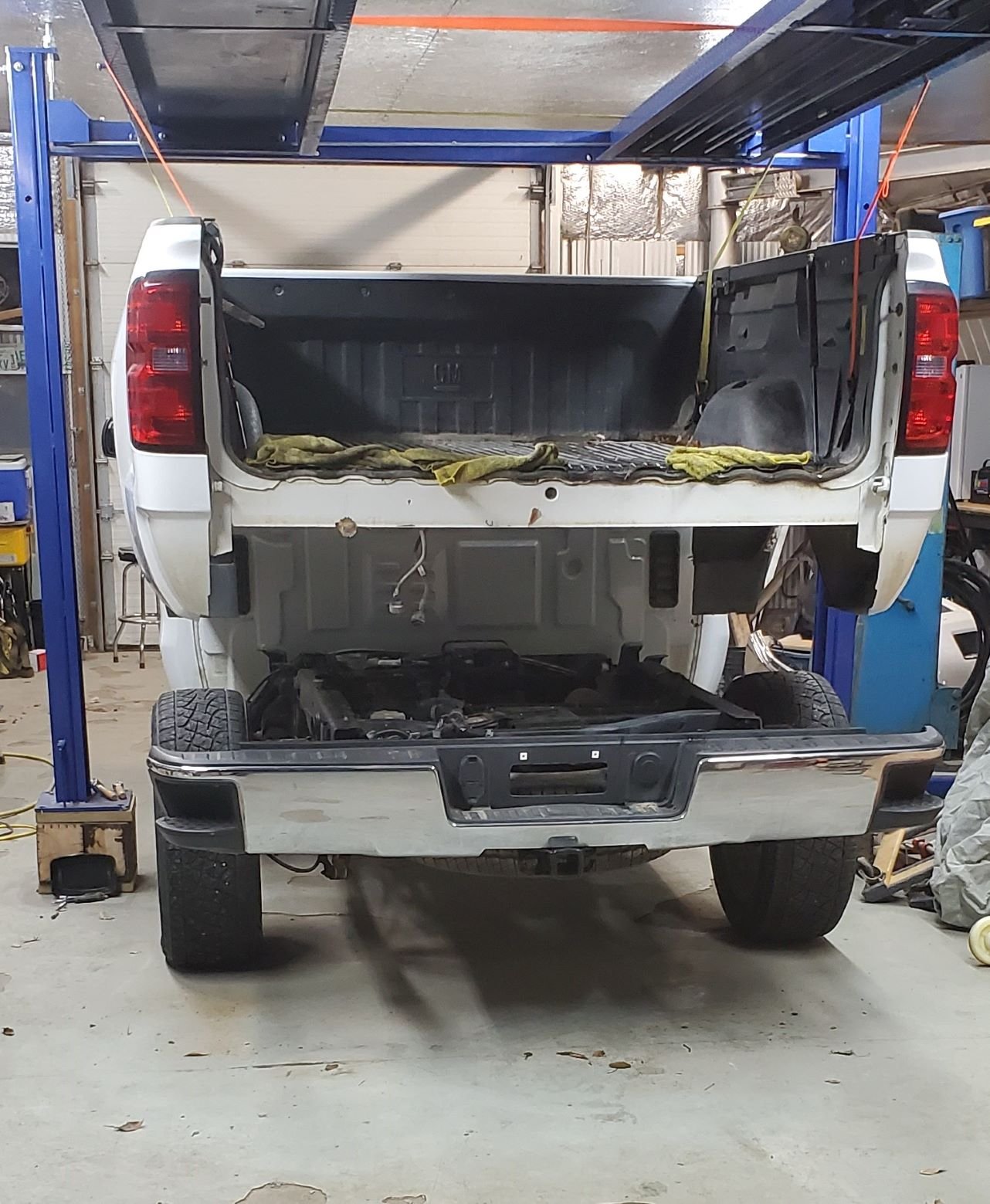

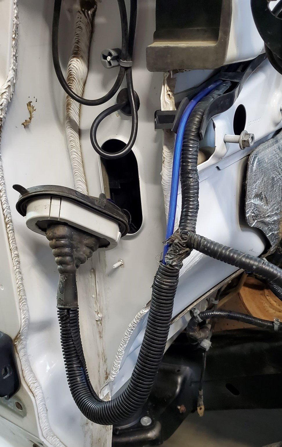

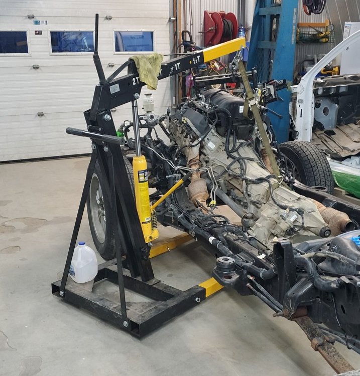

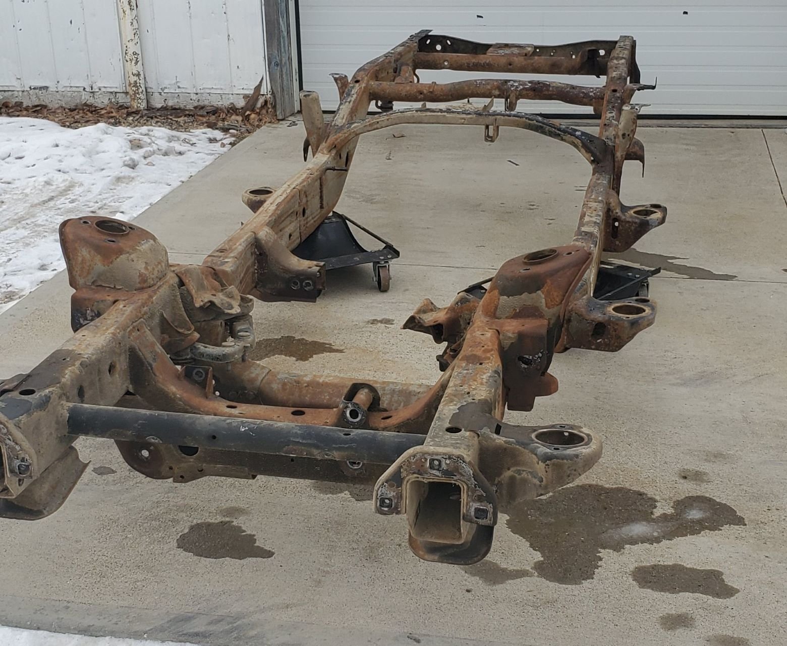

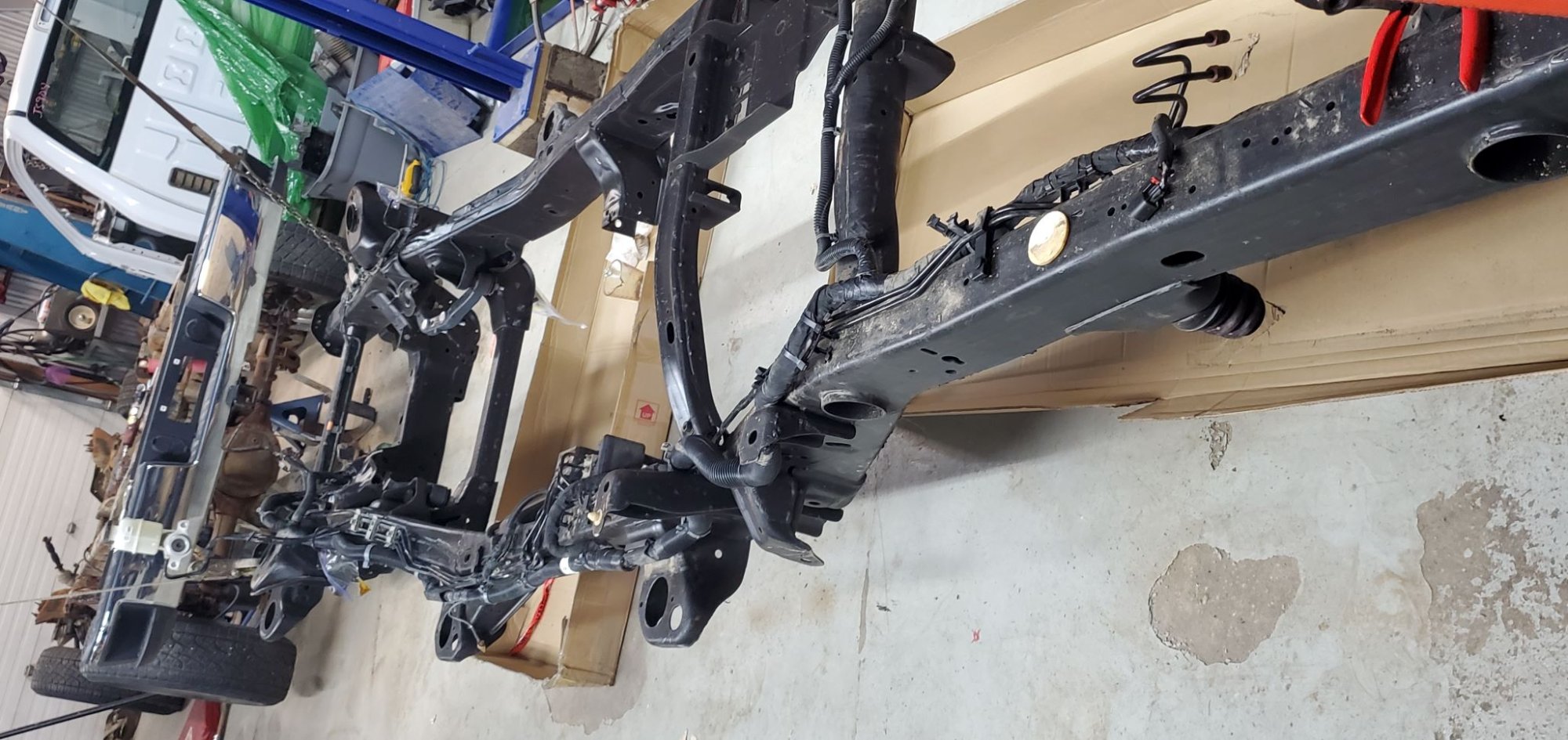

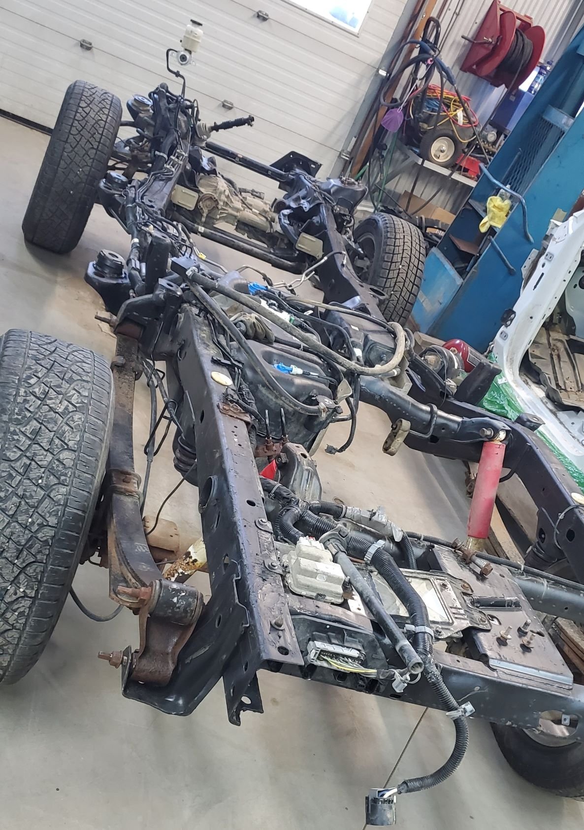

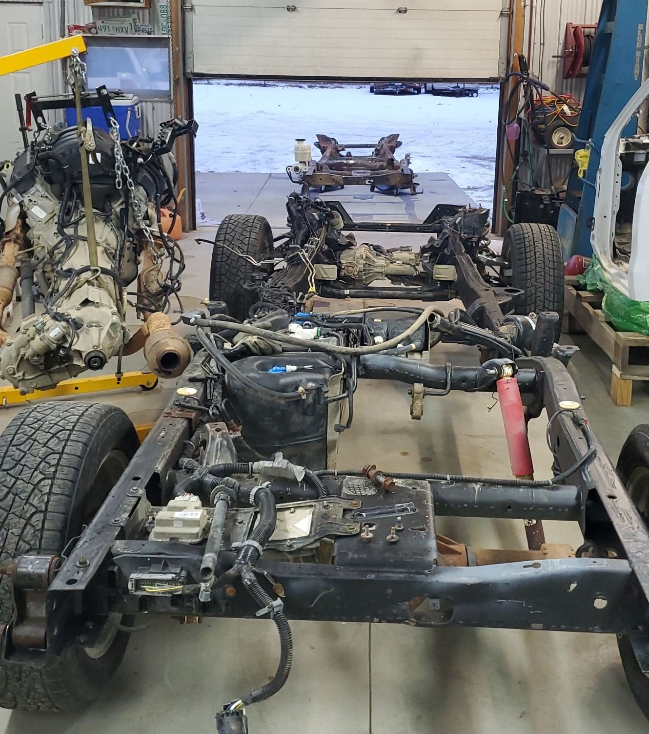

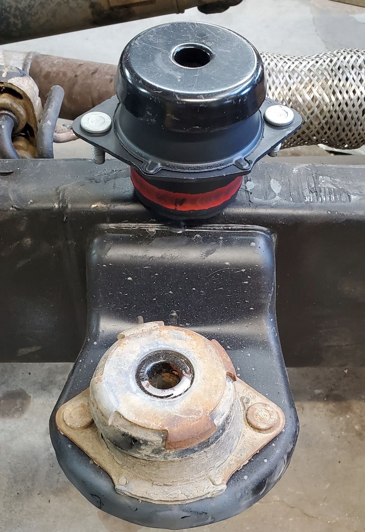

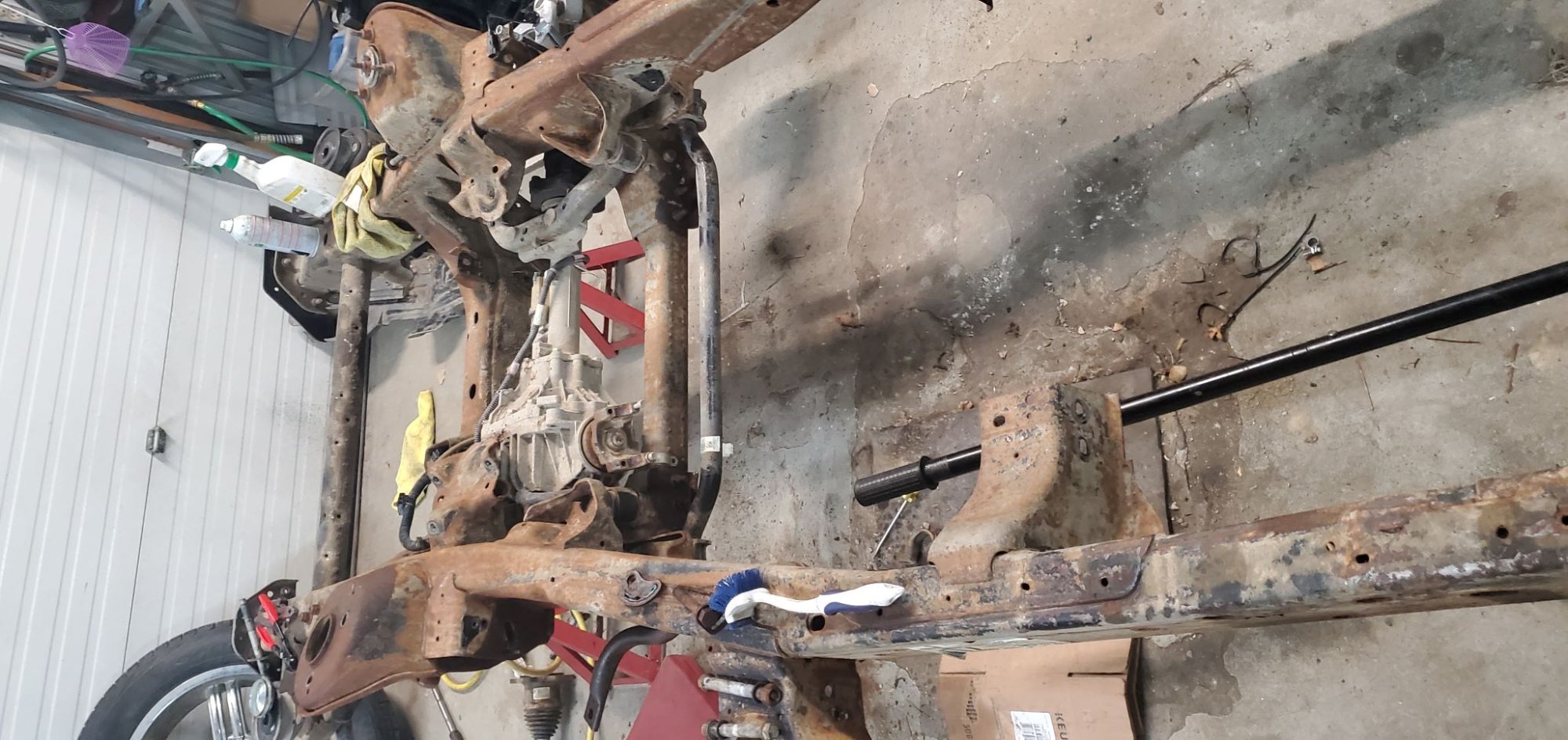

FYI the pictures were taken on my phone generally vertical, so they will be turned to fit here better. Can't wait for this ugly frame to go at this point. Now I'm learning how the assembly line assembles things The electrical, fuel and brake lines are all one large assembly that drops into place and connects everywhere. It was very to easy to remove as an assembly. Switched over to the new frame Doesn't take long and the old frame starts looking bare. The rear end and tank moved over as well. Electric power steering shown out, and I would remove the front corners from the control arms. A bit annoying to install like this. Front diff is last Out with the old.. the rust looks so bad, it was actually all just surface rust and nothing worse. The factory wax coating is not a great finish, old GM frames had better coatings IMO. Mostly assembled, still some buttoning up to do. Engine ready to go back in In goes the 5.3/ 6L80E That old frame was supposedly bent, with it stripped right down there is no way I could tell. I also noticed the cab mounts were bent, bolts VERY bent. I almost wonder if all the movement was just in these parts. I'll never know now. You can see the cab mount leaning bad.
