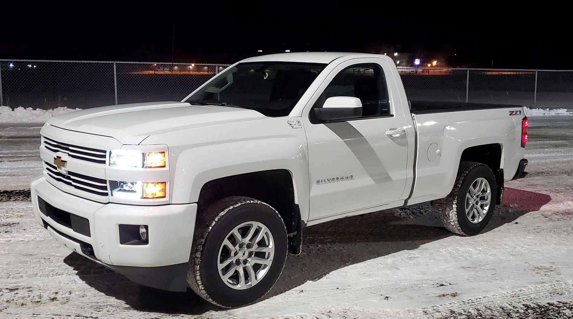

  11. All assembled in the shop.. the lights look much better now. Still don't like them as much as OEM but light output is way better, with a clean cutoff and no blinding other drivers. Lights on Day time after some miles Beside the old cab Close up on the mangled cab.. I'm glad that repair wasn't attempted. For those that scrolled through and read it all, thanks for taking a look! I don't know if I'll do another one again, but it's cool to have a truck that I tore down and rebuilt. It had to pass 2 inspections to be road worthy again, and did so with flying colors. Anything that had damage was replaced. IMO the proper way to repair a salvage vehicle. It does have a rebuilt title now, and it's officially a 2016 model . Apparently the cab determines the year where we are. The frame is technically a 2018 part #. But built even after that. Maybe I have one of the last produced short box frames around who knows. What does the future hold? I need to replace the suspension and upgrade that 4" screen. Have been invested in Grumpy Bears 2015 Silverado suspension and want to go the route he did. Plus.. who on earth has studied it more than him? Foolish not to take advantage of that info. The truck is currently resting for the summer inside, sorry about all the winter pictures but it was built for a purpose and winter driving/fits in my small garage is it.

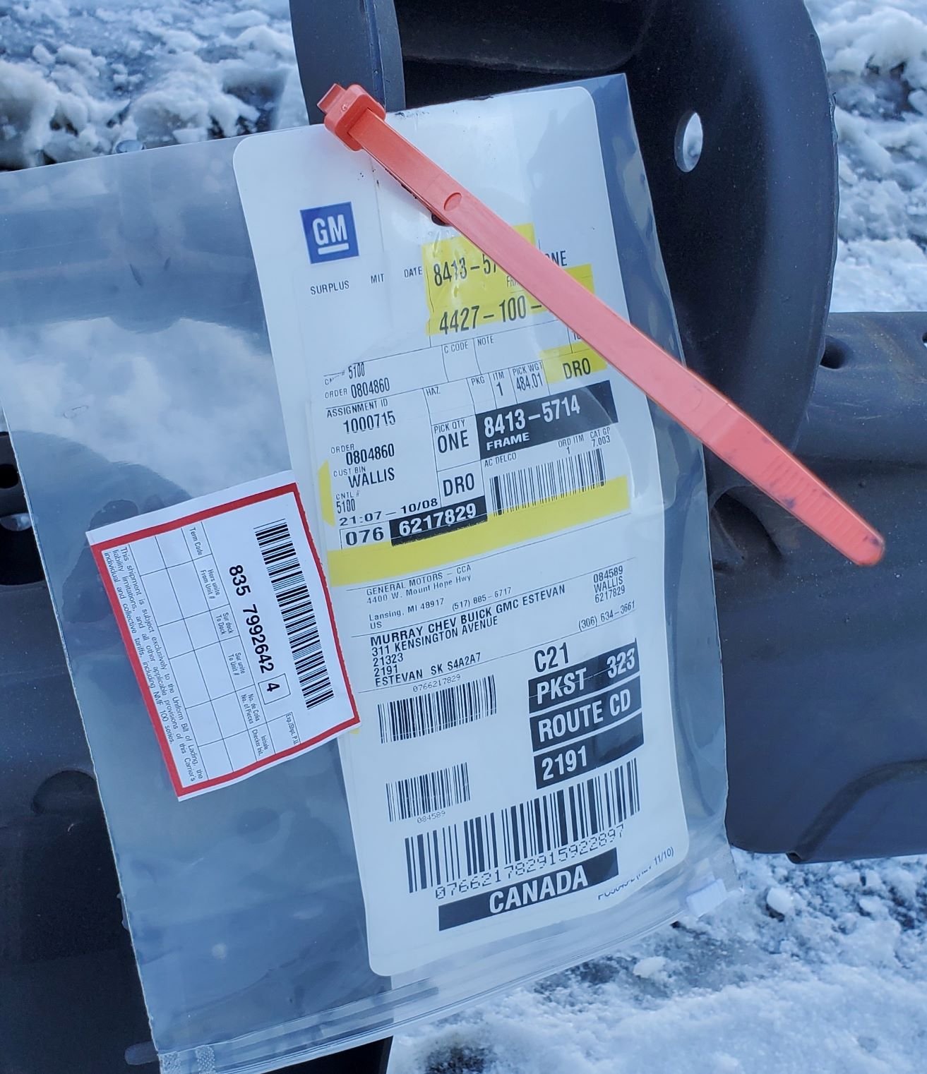

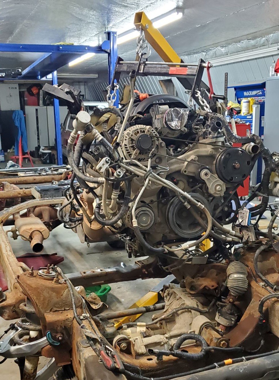

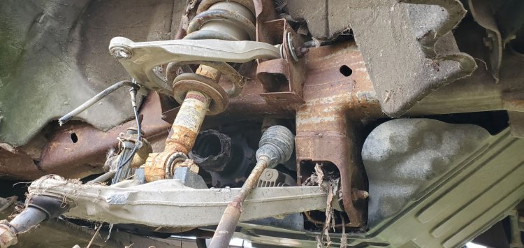

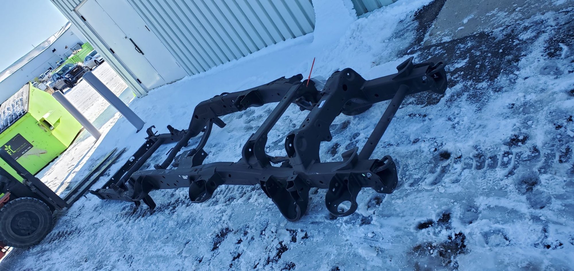

  15. FYI the pictures were taken on my phone generally vertical, so they will be turned to fit here better. Can't wait for this ugly frame to go at this point. Now I'm learning how the assembly line assembles things The electrical, fuel and brake lines are all one large assembly that drops into place and connects everywhere. It was very to easy to remove as an assembly. Switched over to the new frame Doesn't take long and the old frame starts looking bare. The rear end and tank moved over as well. Electric power steering shown out, and I would remove the front corners from the control arms. A bit annoying to install like this. Front diff is last Out with the old.. the rust looks so bad, it was actually all just surface rust and nothing worse. The factory wax coating is not a great finish, old GM frames had better coatings IMO. Mostly assembled, still some buttoning up to do. Engine ready to go back in In goes the 5.3/ 6L80E That old frame was supposedly bent, with it stripped right down there is no way I could tell. I also noticed the cab mounts were bent, bolts VERY bent. I almost wonder if all the movement was just in these parts. I'll never know now. You can see the cab mount leaning bad.
  16. The new frame inside.. suspended ready to start switching parts over. To be continued

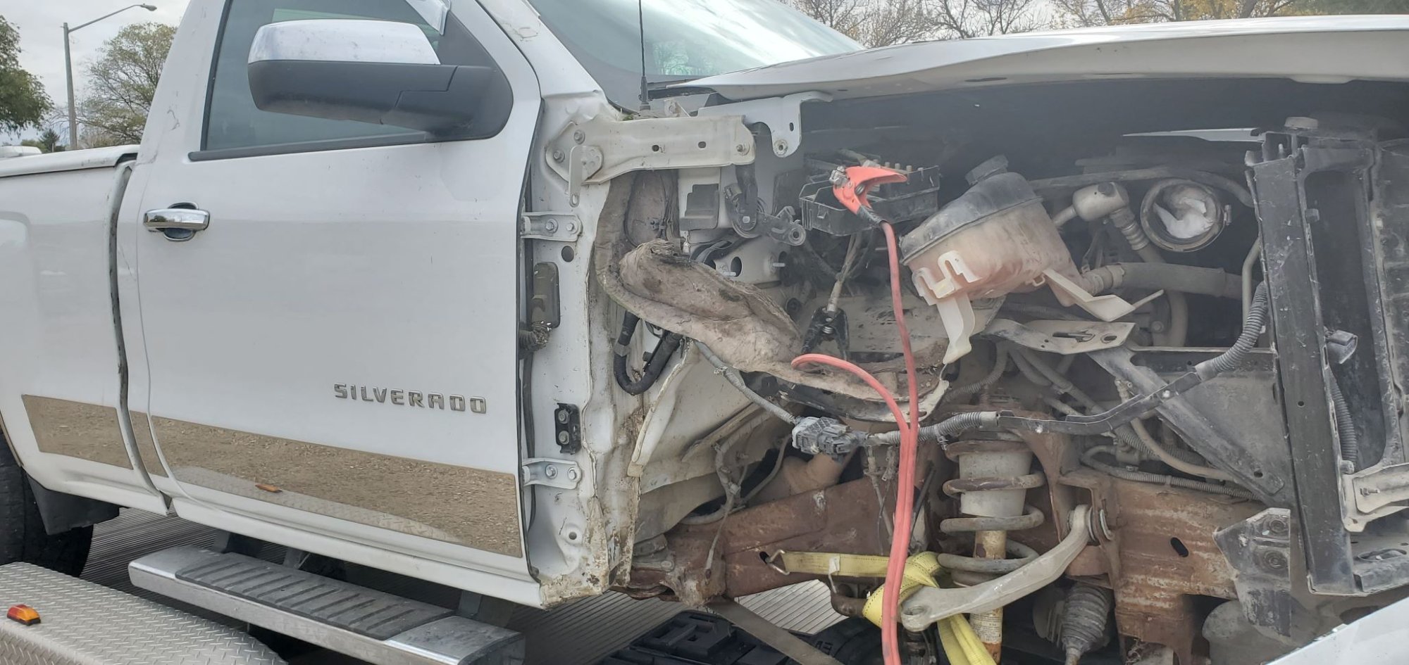

  17. Body shop/frame rack day The verdict: Frame was out a bit (no kinks, just a an inch out overall), needed a new cab mount. The cab situation was worse, and would be a costly repair as it was many seams, that wouldn't be possible to fix as good as OEM. The body man was excellent, rather than take the work he asked me how much I was willing to do. This was 6 months after the pandemic, and I was barely going in to work. All the time in the world on my hands. I had also priced out a frame from GM already. When I told him I could order a new frame, and there was a local 2016 Summit white single cab he told me if it was his truck, he would replace both if I was seeking perfection and a better end result. I agreed, I didn't like the idea of straightened parts and I like things as it left the factory. So... $900 for a cab Meanwhile the junk fake chrome had to go! Work began! Rad support comes out in one big chunk Next is the cab.. with a 4 post lift I had to get creative but it worked! Starting to get stuff spread all over Outside to wash off the filth. The surface rust on this thing from sitting in tall grass was brutal. Another reason I wanted to change the frame. The driveline getting picked out

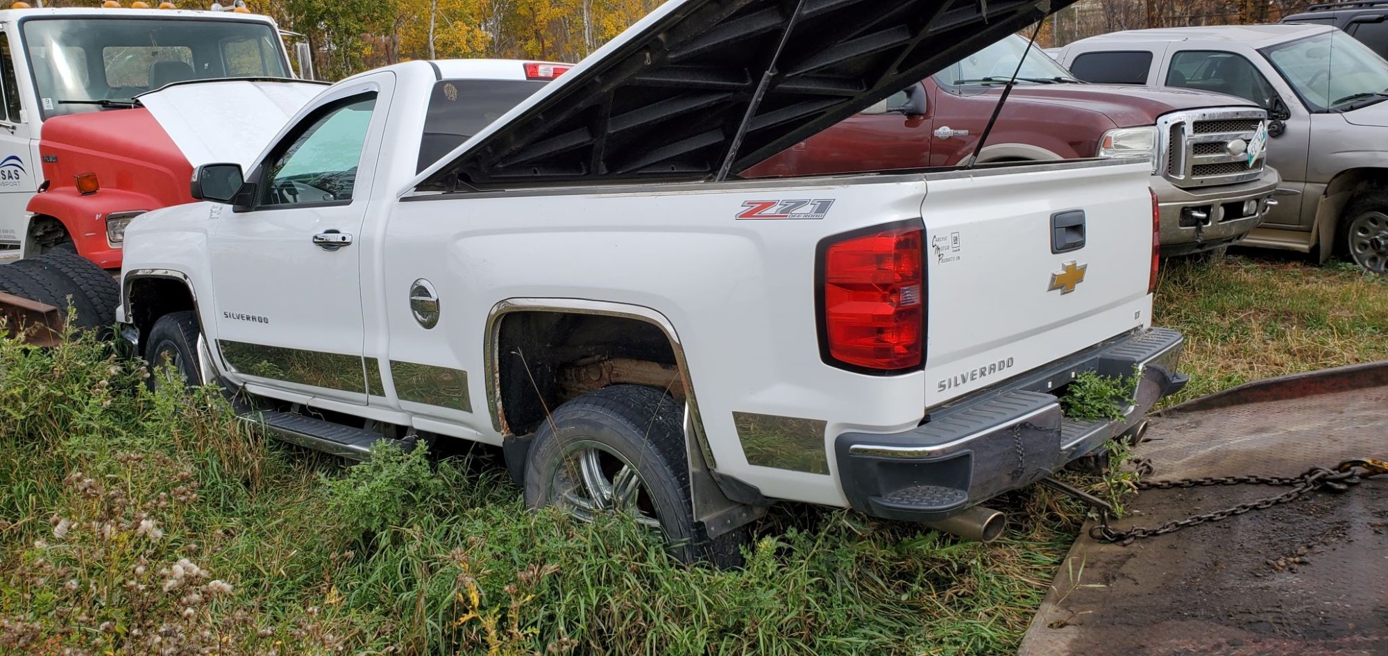

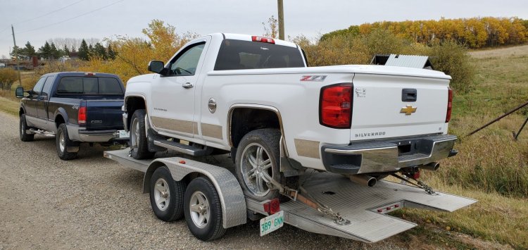

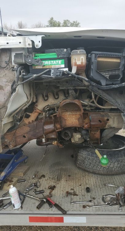

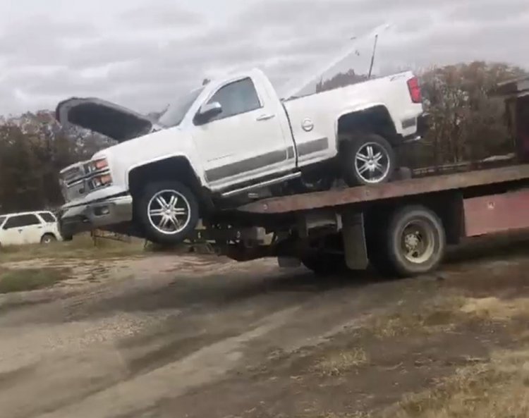

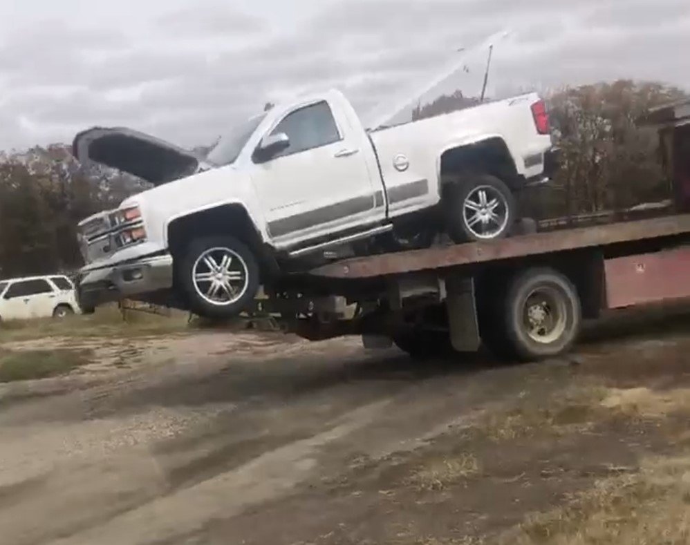

  18. July 15th 2020 I found the truck on marketplace and started inquiring. Details were vague, but the truck had been in a collision and wasn't repaired or reported?? (so he said) Weeks go buy and the information trickles in.. it has hit a pole and broke the entire front right suspension, but the engine still ran and it drove on 3 wheels . More info, it was actually crashed in the fall/winter of 2016. It has been sitting for 3-4 years. Fast forward to September 2020, the seller has decided he should let the truck go and now I get all the details, the VIN and we start figuring out a price. He was driving intoxicated and hit a pole, tried to drive the truck off the pole/had friends try pull the truck out but ended up getting caught. The truck was impounded and he was denied insurance coverage. He had plan on fixing the truck, but time was passing and it wasn't looking feasible. In order to get the truck, I would have to cover the compound fee, which he was able to talk the tow compound down on thankfully. Sept 28th I head there with my trailer to finally see the one I thought was getting away (and I likely should've left alone). The first look, the drivers side looked pretty good. But with the tall grass I couldn't see the damage real well. The tow truck driver pulled it party way onto the deck so I could look underneath: The rim, axle, upper control arm and tie rod took the bulk of the damage. I couldn't really see the cab damage and from the looks of things the cab was ok. Oh, and it fired right up with a boost like nothing!! After sitting that long with almost 4 year old fuel. 139,****** KM on the ODO. I quickly talked with the seller and we decided on $1500 plus compound fees. Away he goes? Yup he drove the deck around with it dangling like that to get lined up with my trailer (nightmare). Almost on, don't know how the aluminum trailer survived sliding it around with boards (no damage). Just about to head home. The starting KM Had to get this out of the way... Pulled the fender off and uncovered the damage to the cab... still hopeful here Ordered parts to get the truck fixed so I could back it off the trailer. Driving it around after it was off the trailer was such a great feeling! Next step was across the street into the body shop for frame measurements. Where I live in Canada it needs a body/frame inspection and a full mechanical inspection after a documented collision (which it turned out this truck had!). I'll try keep the posts coming when I have time.
  19. If you've ever been on Facebook marketplace and found something that was too good to be true, seller was extremely hard to get ahold of, and impossible to go look at... You'll enjoy this build. It all started with two facebook messenger photos of a phone .... containing the photos of the truck. It ended here: I'll try fill in the gaps in between, but it may take a few posts when I have time. As a hint, the model year of the truck changed and I got to order a brand new frame from GM. More to come soon!
