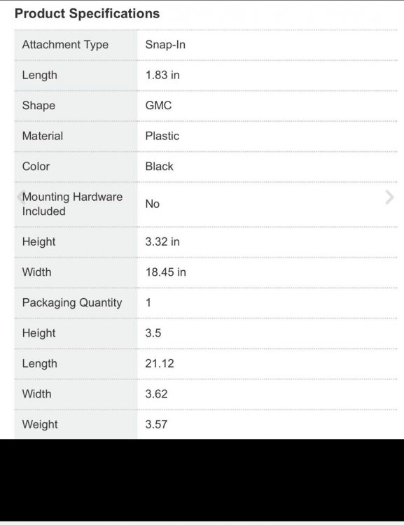

  1. If the Yukon is the same as the Sierra, then the cut off for the emblem and the change in the headlight wiring connect happened in 2019. For me, I have a 2018 Sierra and I ordered the older connectors, seals, pins and cut the old connector off the wiring harness that came with the emblem and started putting the GT 280 connectors on it. Also had to cut new slots in the grille where the old emblem was to attach the new emblem. Still working on it and a family emergency stopped me midway through but I’ll pass it on on what else needed to be done. Crossing fingers!
  2. Just sent you an email.
  3. NM. I see the reason why. I measured my ‘18 and the existing emblem comes in at 17” wide. If this emblem is 18 1/2” wide, I don’t know how that is going to fit the existing grill. I need to bring my tape in to a dealer and do some measuring.
  4. So is the reason why it might not work on an ‘18 might be the plug and not the mounting? I’ll have to measure. Then figure out the wiring.
