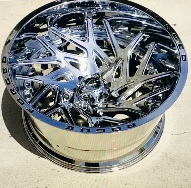

  2. Yeah...had that backwards didn't I...El Toro was closing and went to Miramar is what I meant... Guy from East Coast Gears said it is welded? I remember this one woman Marine that was CFR at Cherry Point...she was so ridiculously HOT! Everyone on the base was all over her, lol...surprised she made it, lol. Have any idea where I could get a Dana 60 & 14 Bolt...? I wonder if I could get "AnyLevelLift" to fit, lol? Trying to take this show build to the next level...I know it's a 1500 but it's actually my daughter's truck so it makes more sense....kinda, lol. The wheels are 26x16 Rogue 2-piece forged concave in total show chrome...takes 8 blanks to make them. They were going on a SEMA build for 2020 but there guy totaled his truck and SEMA never happened last year anyway. Got an incredible deal on them as they start at $12K.

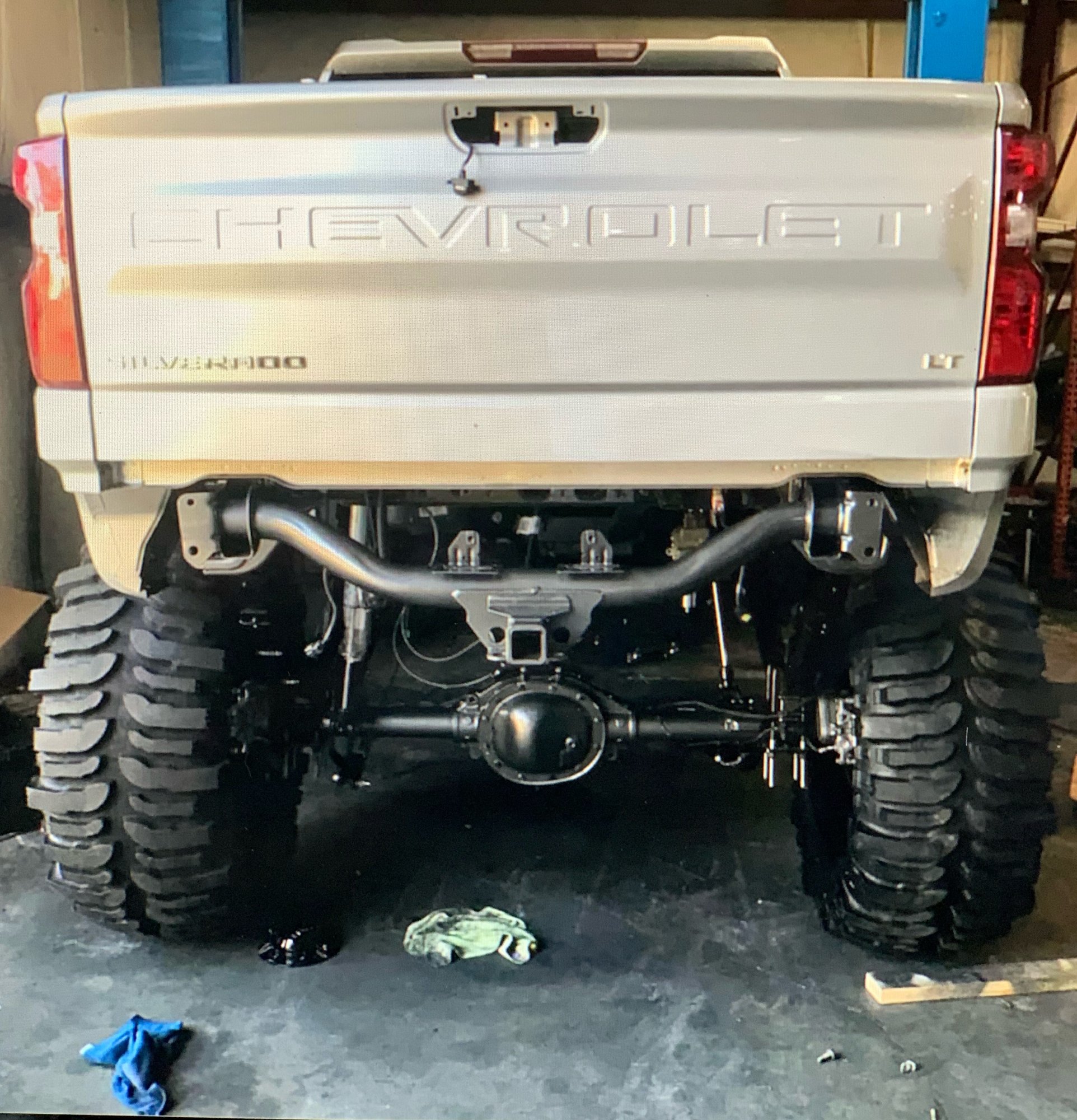

  6. Well...I know I'm gonna catch A Lot of ****** for this but it's going up on a custom 18" lift with 44X19.50R26 Interco Boggers. I know one other person doing the same thing for a SEMA build. He said he had to change the whole front assembly and was gonna check on what parts the shop used? He said he has 4:88's...not sure how he got those in the rear or where he got them? I was thinking he needed one step higher than than the 88's. I also don't think he has the 6.2L or the 10 speed but he does have the 9.76. I'm not worried about tuning it...that's a given!
  7. So my 2020 RST 6.2L has the 9.76 rear and apparently you can only get 3:73 gears for it??? I need at least 4:88s to accommodate wheels & tires. Also talked to East Coast gears and they said the front cannot be swapped because the carrier is welded! Does anyone know if this is true? They suggested I put in a Dana 60 in the front and a 14 bolt in the rear???!!! Anyone know if any of this is accurate???
