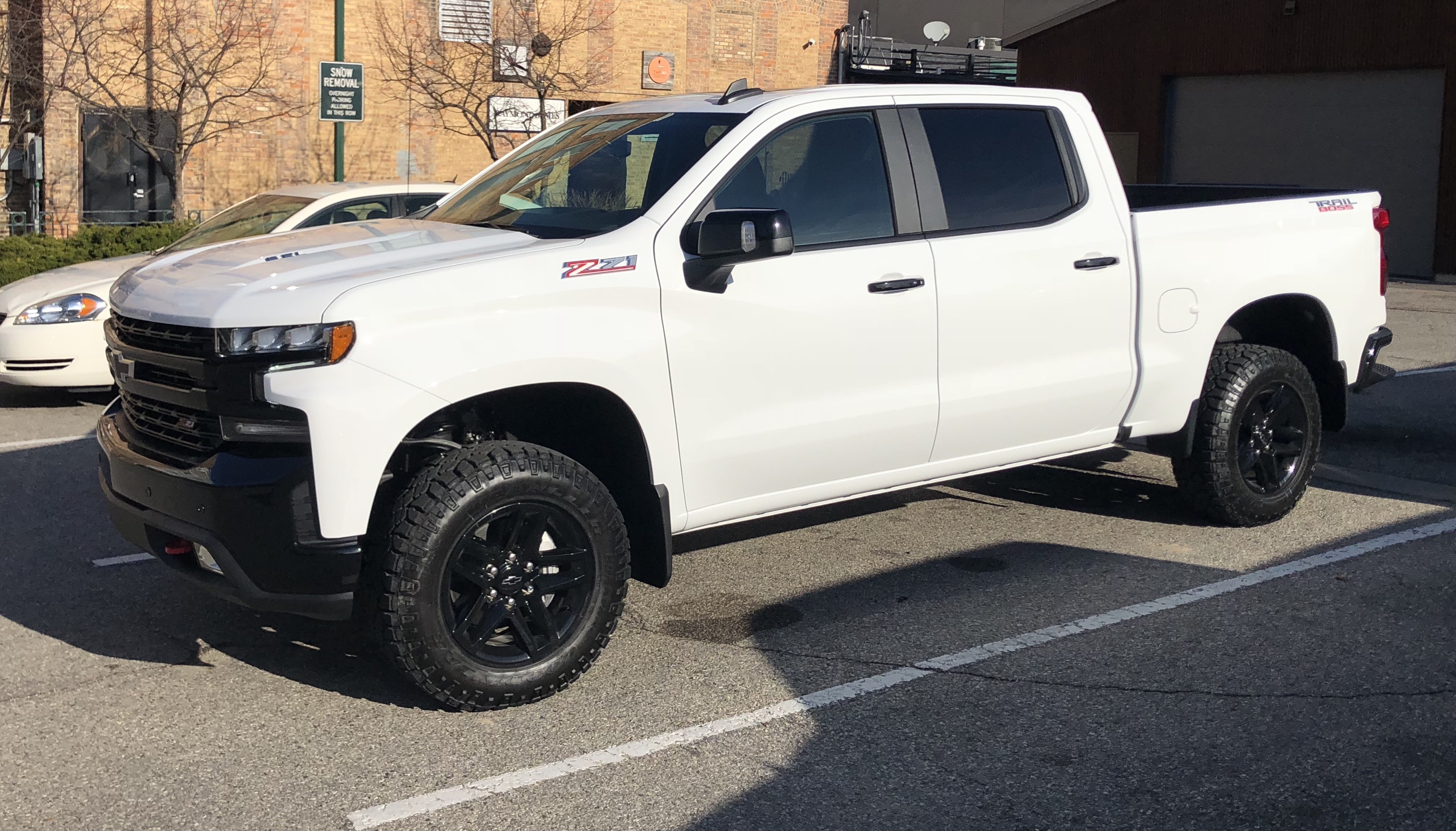

  6. Damn that looks good! Could you post up some measurements to the fender lips please? My truck stock is 39.5" front and 41" rear curious where you ended up? Thanks!

  9. I’m 39.5 front 41 rear. I have right at 2k miles and haven’t hauled anything in the truck yet
  10. Thanks for posting the pic and the update. Did everything turn out the way you expected? It looks good for sure and your upper control arms look beefy as hell
