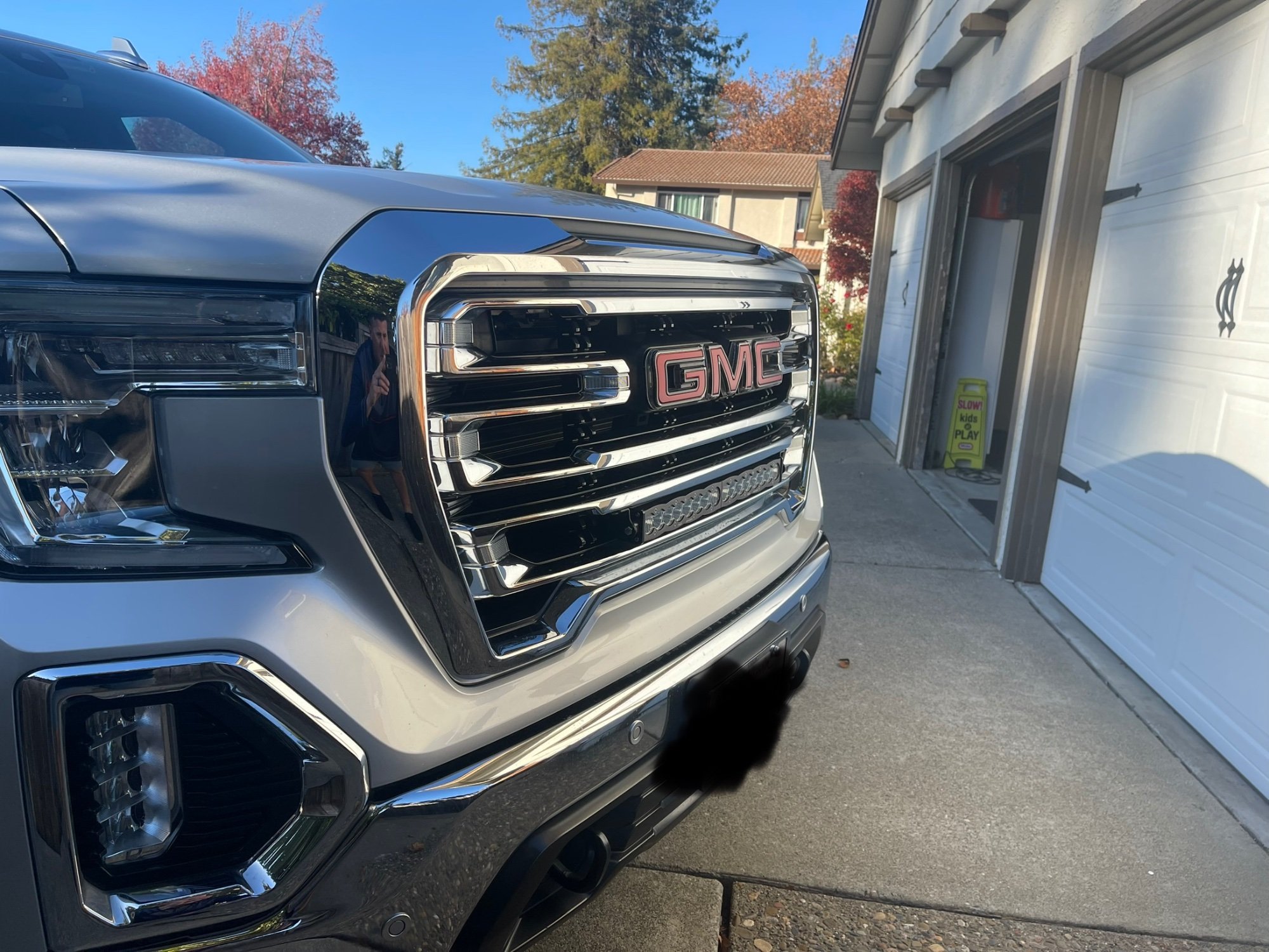

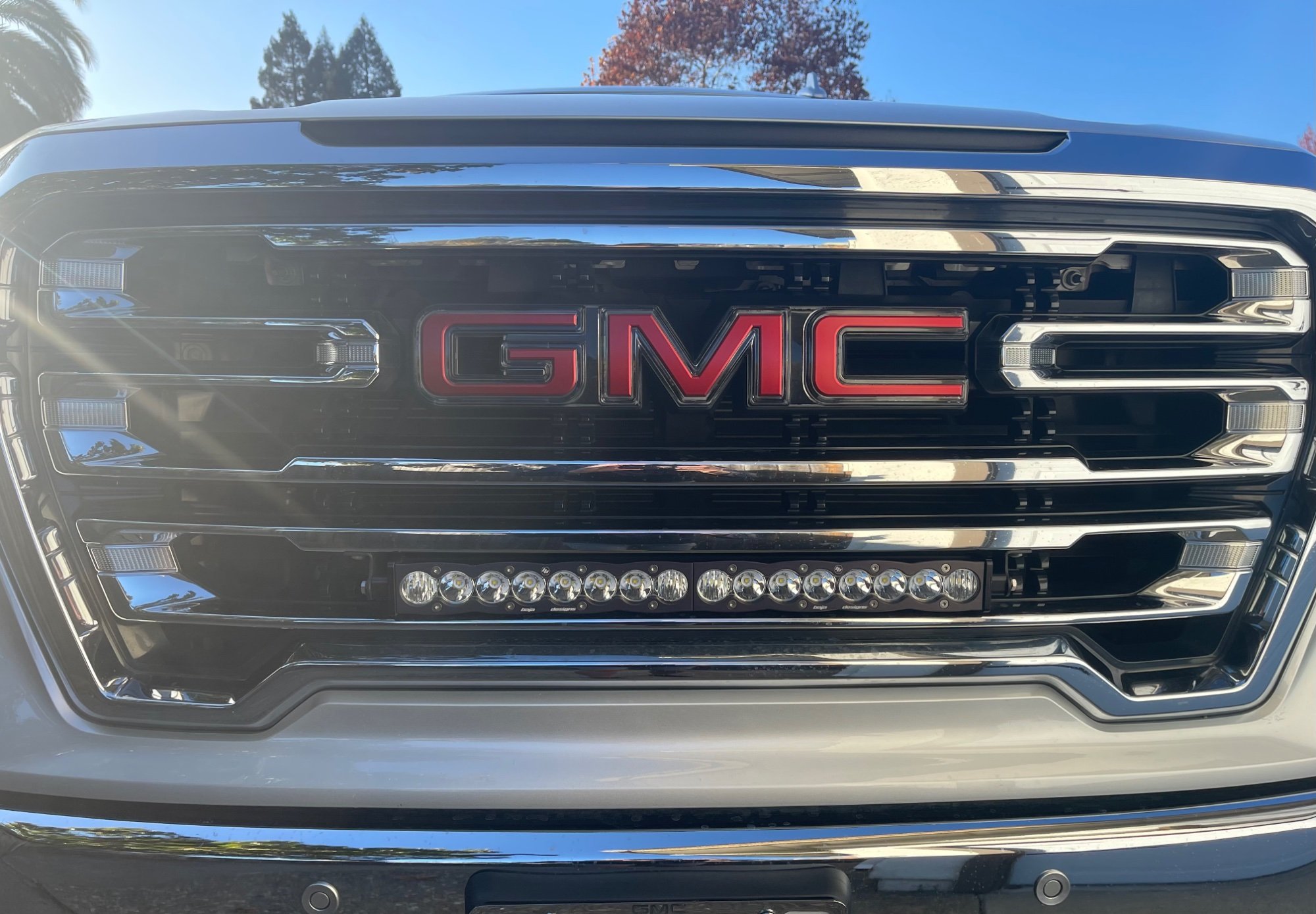

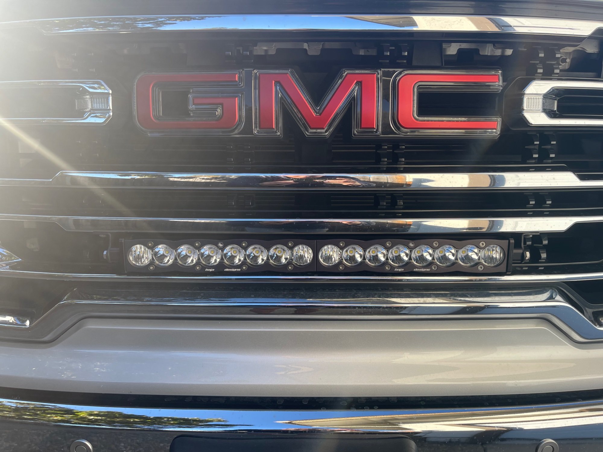

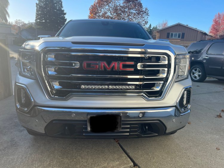

  1. That looks good RedLT nice install! I did something similar cutting (2) of the vertical grill posts to get a Baja Design S8 light bar flush to the grill without any interference to the active grill shutters. I connected the S8 to the GM Upfitter switches I installed. I ended up purchasing the vehicle specific in grill mounting brackets for the GMC Sierra and Baja Design S8 light bar that are made by Wicked Warnings. https://www.wickedwarnings.com/product/s8-grille-bracket-for-19-up-gmc-truck/ Cheers,
