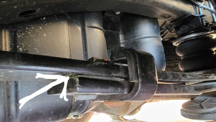

  7. I got the spring things installed and it was instantly better. I only did the forward on each spring. Come on GM!

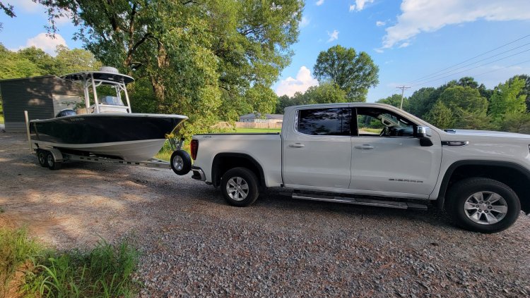

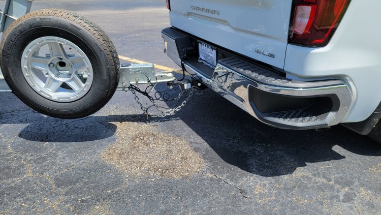

  8. I ended up getting AirLift 5000 bags installed (and level kit). With the bags completely deflated the boat dropped the rear end 2.75" which I assume is how much it was doing prior to the bags. With the bags it is no longer an issue and drives much better. I do think the design of the trailer and the boat seems like it could put a lot of weight on the tongue still. I want an adjustable receiver hitch and I found one that has a tongue weight gauge on it that I am thinking about getting.

  11. The picture was taken with a widescreen shot which could be. It was sagging but the chains still were not touching the ground with the stock configuration. I'll have to hook it back up and measure the distance for y'all. I'm thinking bags will resolve it but as far as the trailer goes, these are all the same kind of trailers I see with these kinds of boats. The axles are in the rear because I assume the majority of the weight is in the rear. I'll have to see where I can get it weighed because that would be a good thing to know. The specs show dry weight at 2,750lbs, plus the F250 XCA outboard should weight 558lb (plus the rigging), and fuel at 6lbs per gallon would put about 600lbs. That still is on under 4000lbs. Below is the only other picture I had before I went on the trip. I'll have to get new ones
  12. I have a new 2021 Sierra 1500 3.0L that did not have the max trailering package. I was disappointed in the suspension and decided to add airlift 5000 airbags. Once they were installed I noticed something very noisy when going at slow speeds and making turns or any point where one side of the rear was at higher ground than the other. I narrowed them down to the leaf springs when they slide side to side. It appears the rubber or whatever that thing is between them makes a TON of noise. I decided to try to clamo them down as hard and possible and the noise died down a lot but not completely (couldn't prevent them from moving totally) How can I fix this? I didn't notice it before the air bags so my assumption is the bags took weight off the springs and that's the issue

  14. I haven't seen that before. So it looks like it is preventing the leaf springs from compressing as much with that Roadmaster Active Suspension. However, I did already purchase the Airlift 5000 Air Bags and compression before this post. It kind of does the same thing it appears by offloading weight from the leaf springs to the axle I guess.
