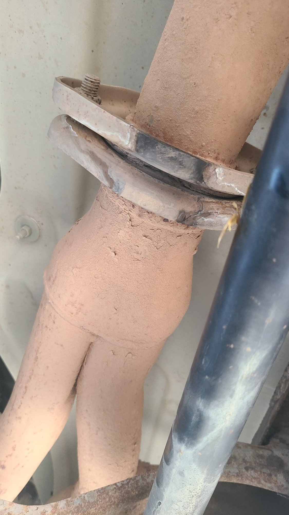

  3. Think I found my exhaust leak. Had a drip of water after I moved the truck into the driveway.
