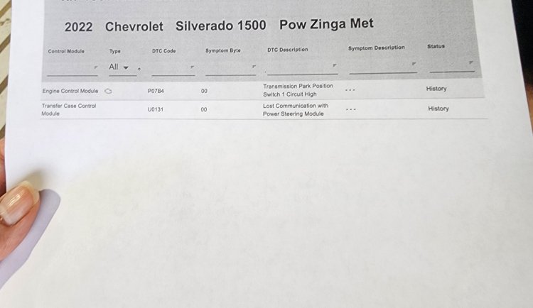

  2. 2022 1500 refresh LT Z71- 5.3 Without DFM. 45k I have one for the gurus, the problem Started about 5 or so months ago, We started getting a service Transmission message going into reverse. We Took it to the Dealer and they ran the codes, 1) P07B4 -Transmission park Position switch 1 Circuit High (ECM). 2) U0131 - Lost Communication with Power Steering Module (this is listed under the transfer Case Control module) I have been able to recreate the Service transmission message. When going into Reverse (only reverse), the errors come up if I don't pump the brakes first. If I pump the brakes 3 or 4 times and then put the truck into reverse, the errors don't come up. The service transmission message will throw the CEL, but after about 20-25 miles, the CEL goes out. Everything works fine, 4x4 High-low - power steering. One of the dealers I have taken it to said if I can live with it then drive it. I have searched on Google, there seem to be a few out there with the same issue. Some were fixed by replacing the rear brake actuator. has anyone had the same issue? looking for any advice. The dealer wants us to drop it off the truck for 3 to 5 weeks without a loaner.
