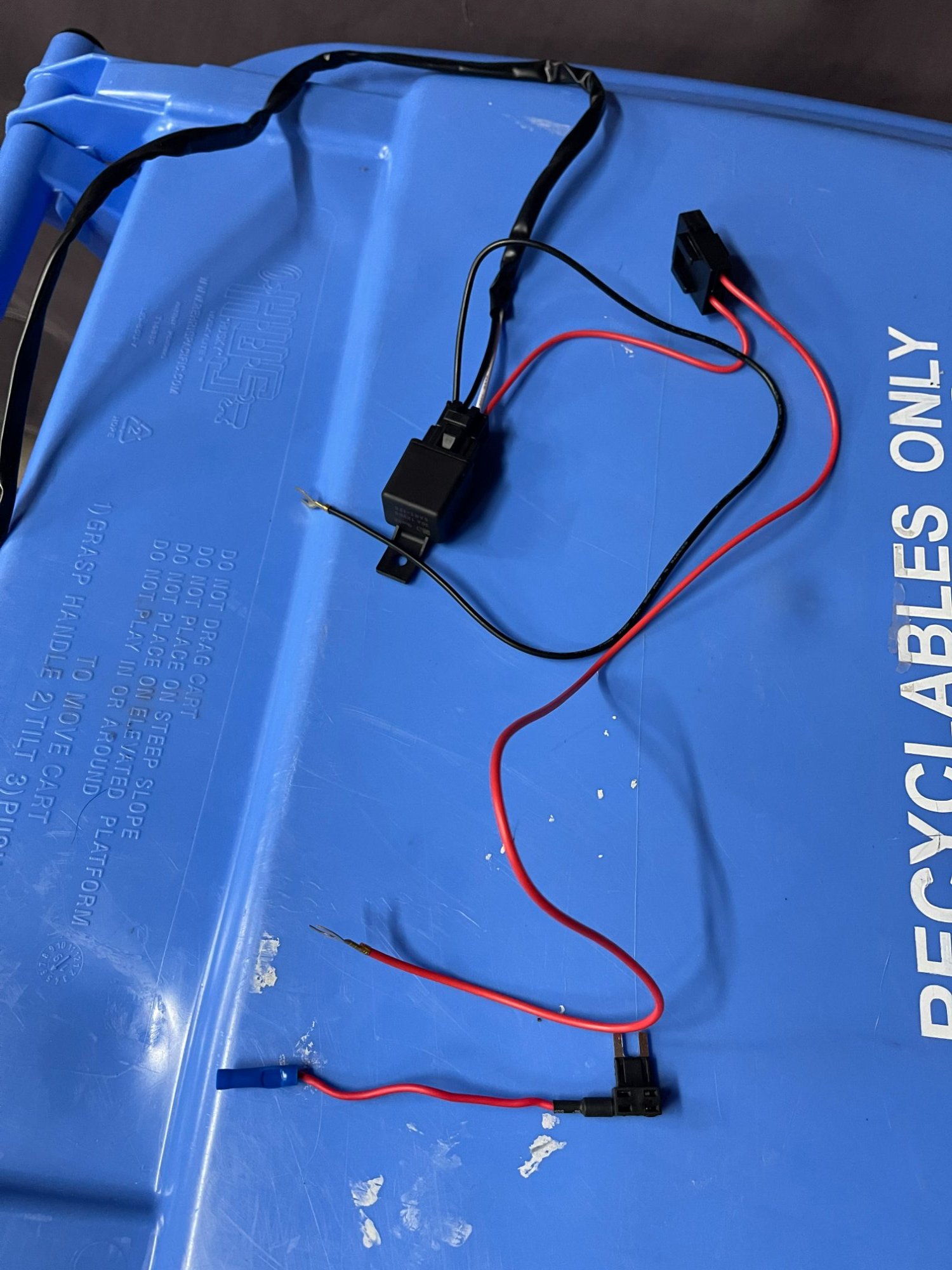

  1. I'm adding on an aftermarket fog light and not planning on using the switch. Just planning on tapping it to the parking light fuse, Fuse 42 if I recall, with a fuse tap. Just a quick sanity check on what I need to do here. 1. Black wire to metal for ground 2. Cut the end of the red wire with the clip and crimp it to the fuse tap - Is it ok if I leave the fuse holder that is attached to the harness, so essentially I'll have 2 fuses, or do I need to cut it out? Thanks!

  7. Does anyone know what the extra wiring harness is for, that is located under the passenger side headlight on a 2019 Silverado LT. The only thing I can think of is that its possibly for parking sensors? It's not connected to anything.
