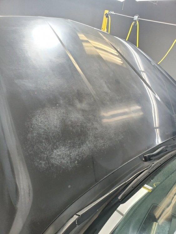

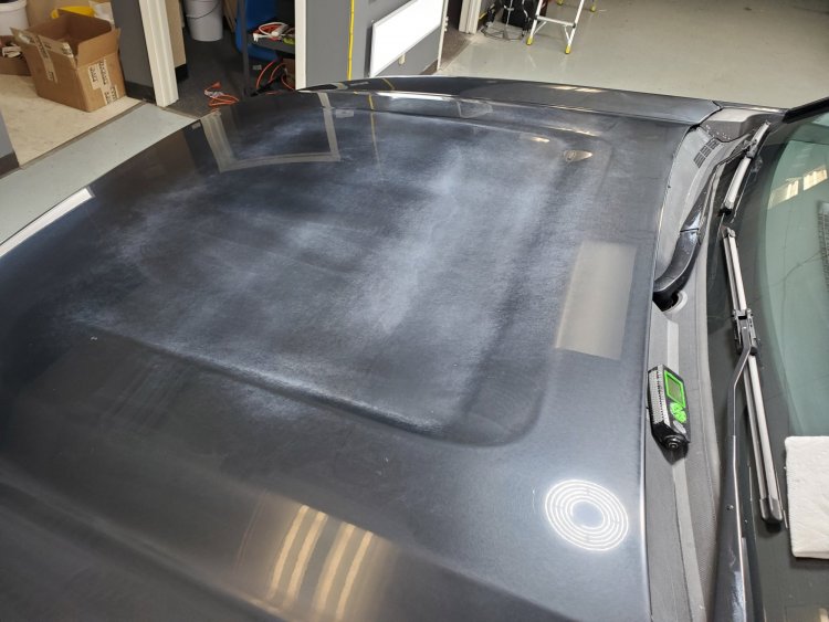

  2. We are a local detail shop in Dallas TX (https://ceramicfx.com). This is a known issue of black GM paint (Tahoe, Yukon, Suburban, Escalade etc.). Here are some pictures from our archive. The first five are from an Escalade., and the other three are from a 2015 Yukon.
