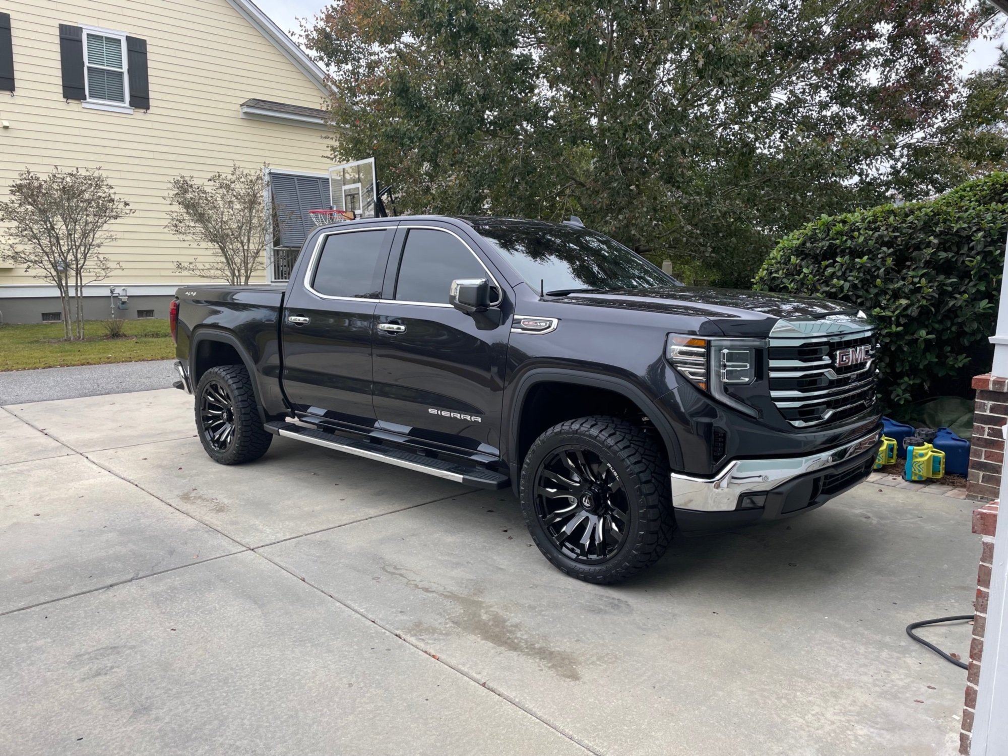

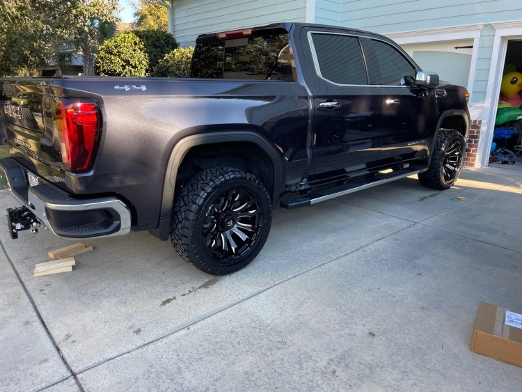

  2. PRICE $79,995 I am selling my 3 month old 2022.5 GMC 1500 SLT Titanium Rush Metallic / Black Leather Interior. Options include 6.2L, Max Trailering Package, SLT Premium Plus Package, 3 year Constar and Connected services, Power Sunroof, GMC Multipro Tailgate. Center console safe. This truck has 2k miles on and and is fully upgraded with 22x10 Fuel Blitz wheels with 35x12.50 Nitro Ridge Gabbler tires. 3" lift from Cognito Installed. All speakers upgraded to JL Audio speakers and dash with Kenwood speakers. I also, added the GM Kicker subwoofer to really complete the sound system. This is a huge upgrade from the crappy Bose speakers they put in. RetraxONE MX Tonneau Cover Fully tinted on all windows including windshield with the highest level tint. The truck is fully ceramic coated. Everything has been done to this truck and is a fully ready for its new owner. This is one of the sharpest GMC Sierra's on the road IMO. I had to buy a Ford F250 due to a bigger boat I bought the requires a 2500 otherwise I do love this truck but needed something bigger. PM me if your intersted.
