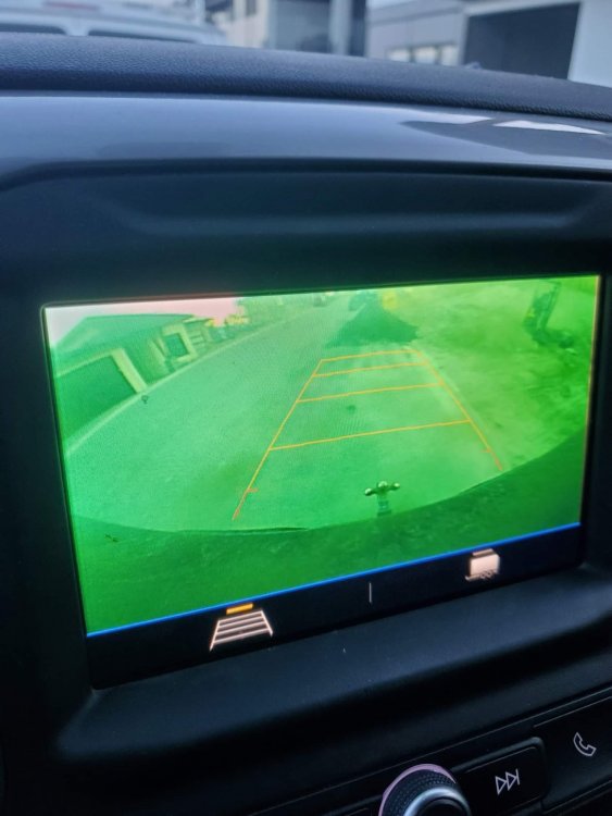

  8. I have a 2021 Silverado 1500 Custom. As soon as it starts getting cold outside (around or just below freezing) the screen on my back up camera frequently goes green. Brought it into the dealership last winter and they couldn't recreate the problem so they weren't able to do anything. Anyone else have this happening and know if there is a fix?
