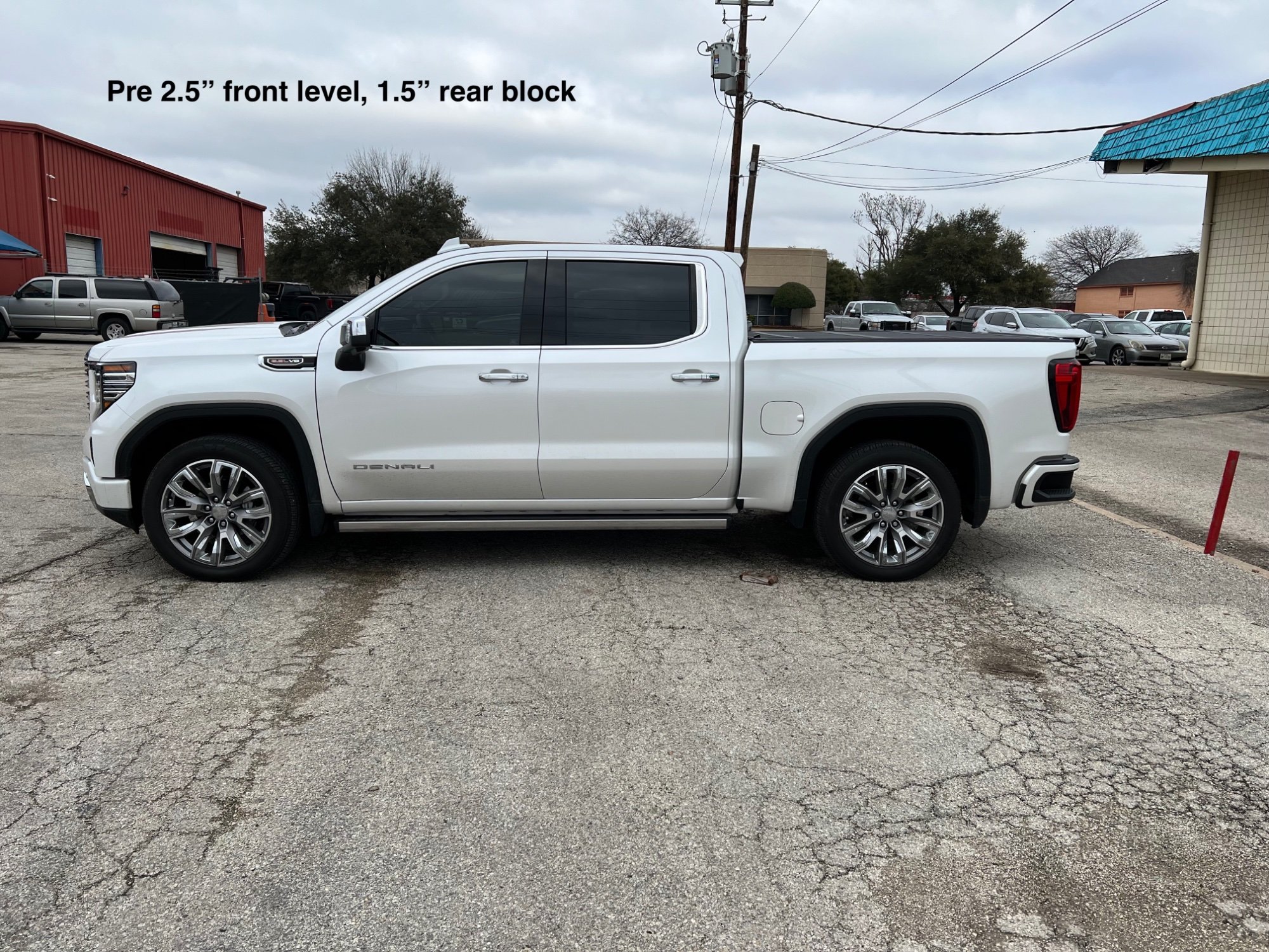

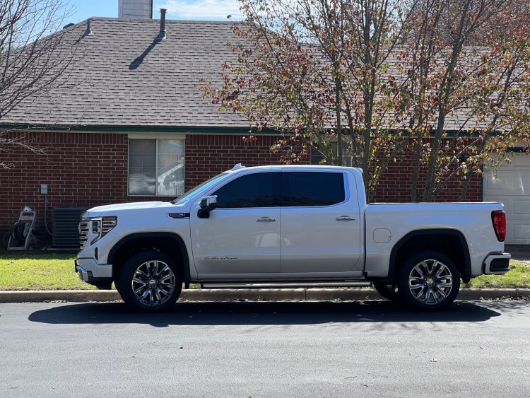

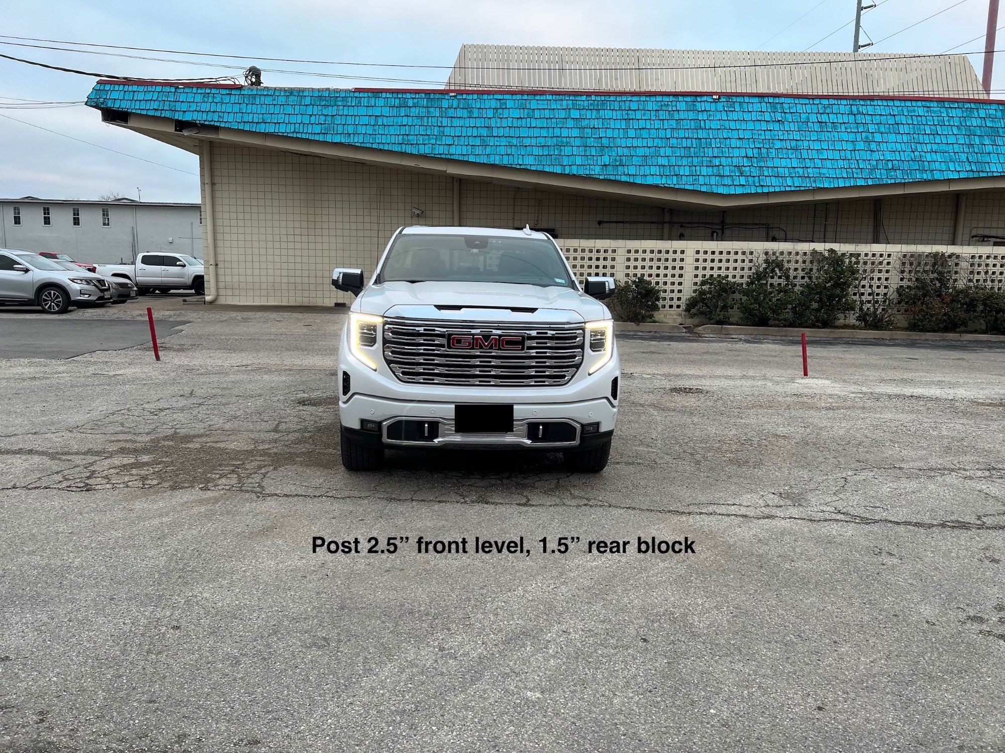

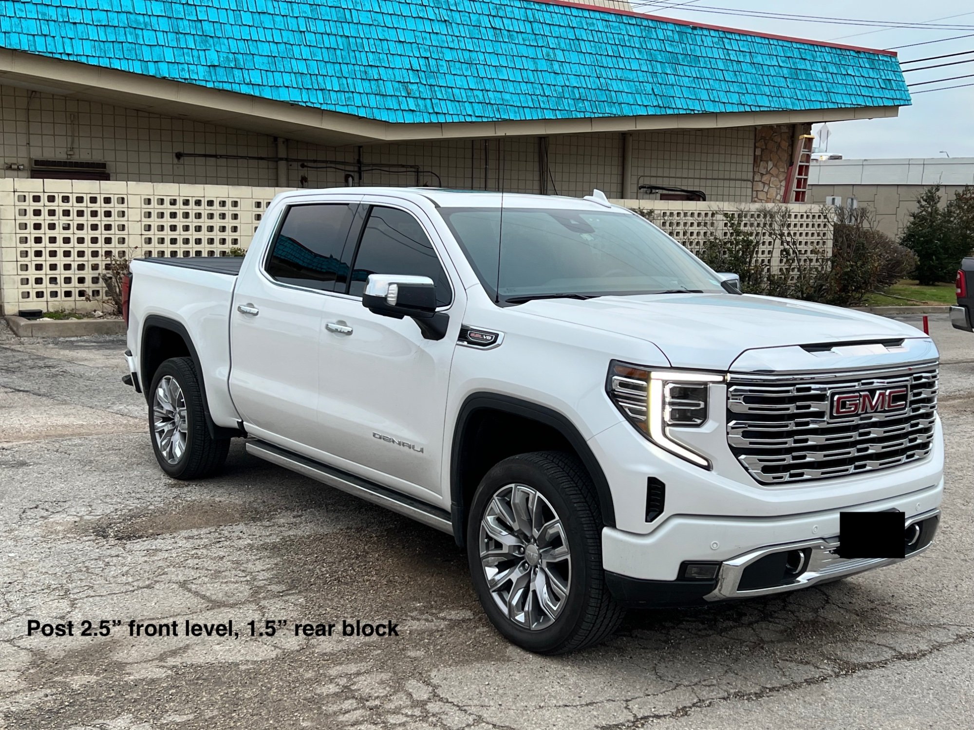

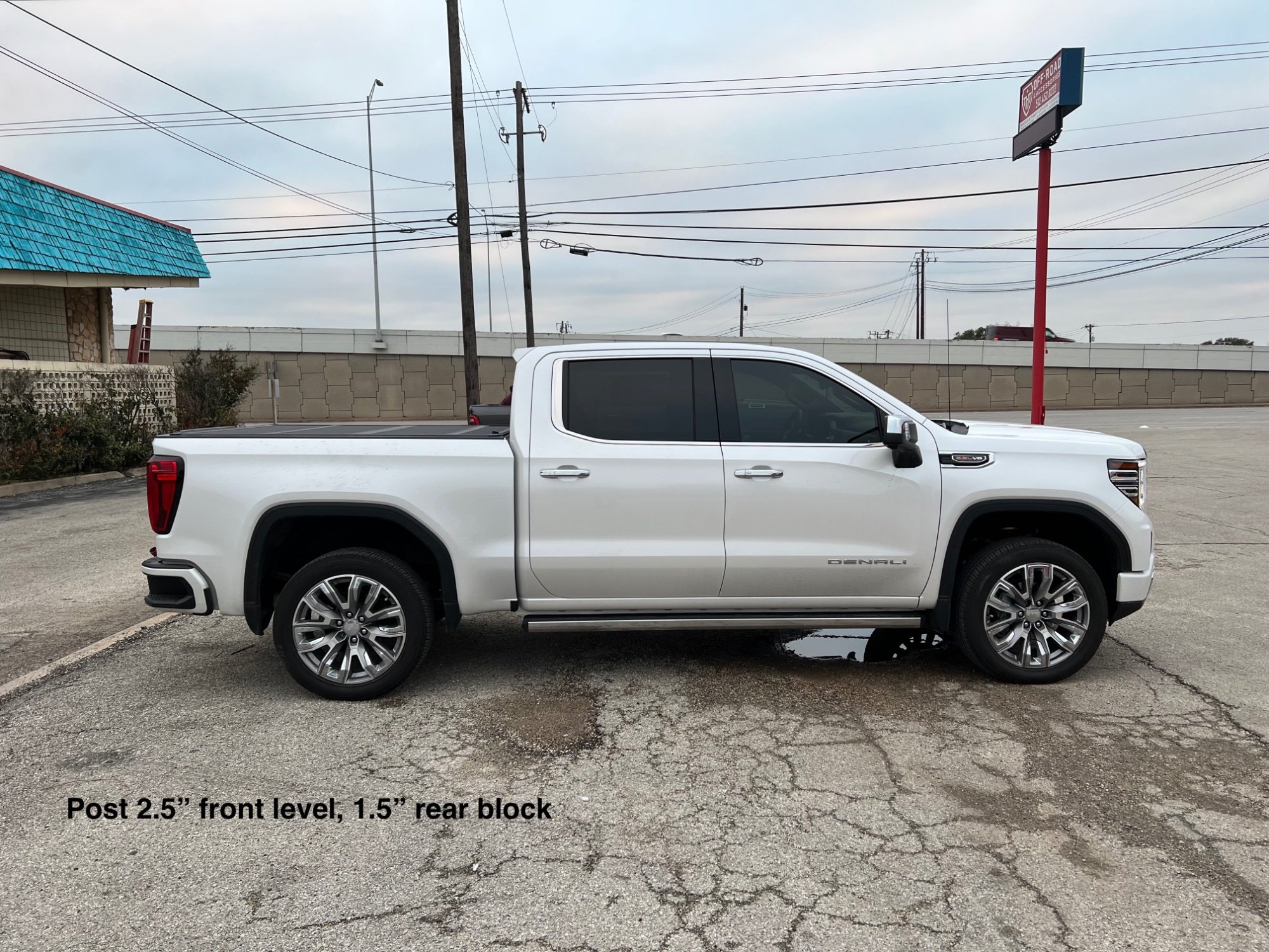

  4. I didn't find a lot of photos on this when I was doing research, but here's the before and after on my 2022 Sierra Denali 6.2L 4x4. I had a Suspension Maxx 2.5in leveling kit installed with their 1.5" kit block in the rear. The pics show it with stock tires, but I'll probably go to 285's once I wear these out. Brief thoughts on my kit after install below: Ride is about the same on the highway. Braking seems a little different, but not concerning. Might address itself after the alignment is done at the dealer. Adaptive cruise still works as it did before Height roughly matches AT4/AT4X when parked next to them. (That was my goal) Only wish I'd added another half inch to an inch in the rear to have a little bit of rake. From certain angles it looks like the front is a tiny bit higher than the back, but may just be optics. Due to restricted size of attachments, the pics will be in two or three more posts.
