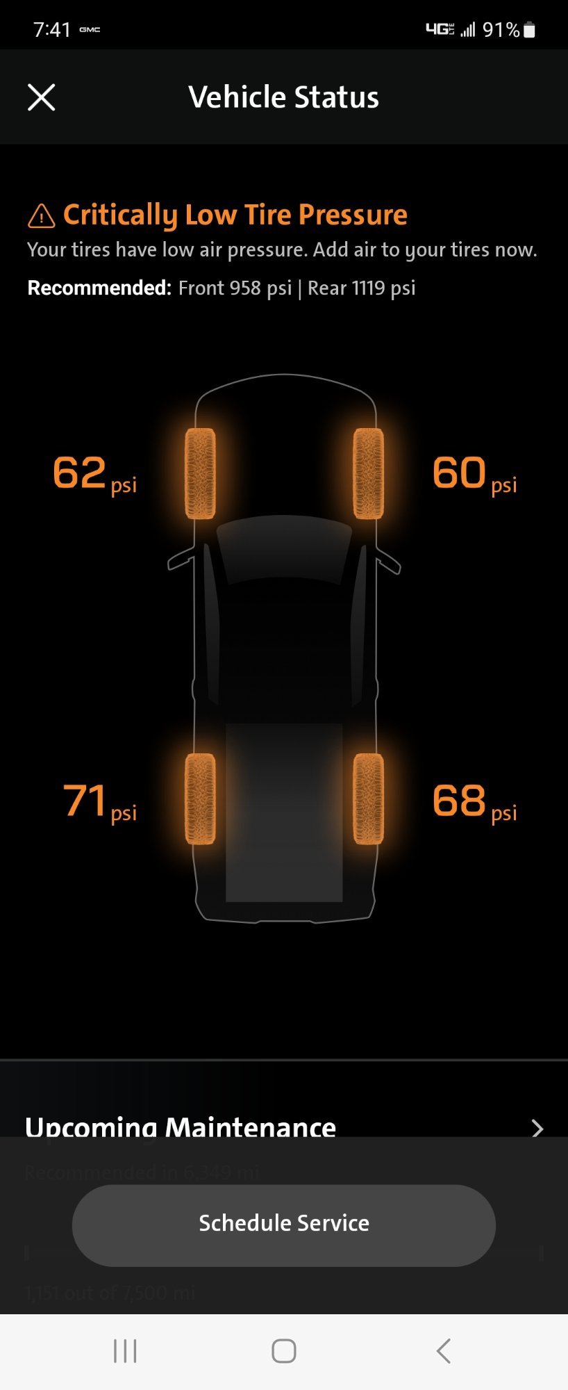

  1. This morning while driving to work in my car not my truck, I receive a notification on my phone from the myGMC app that states "Diagnostic Alert: Multiple tires on your 2024 Sierra are either flat or have low tire pressure.....". When I open the app this is what I see, notice the recommended psi!!! I don't know if the same thing is displayed on the trucks info center.
