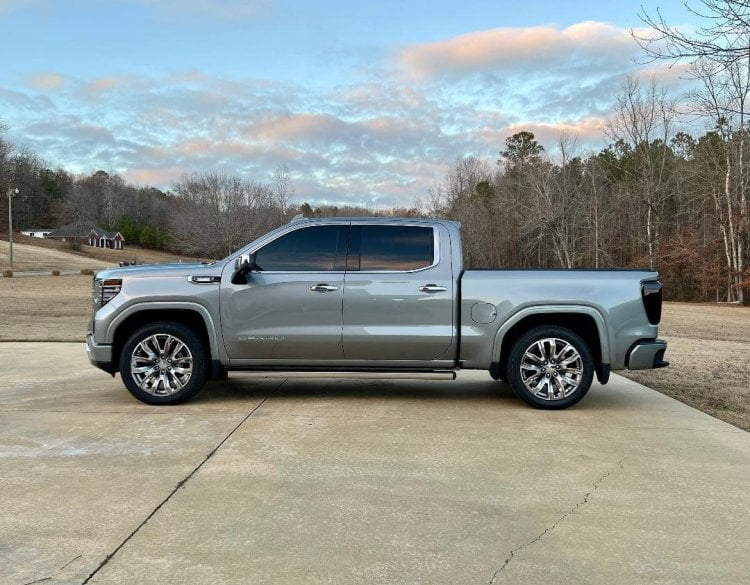

  9. Thanks, I’ve had them in for 6 days and no vibrations since:)
  10. Update 2degree shims seem to have taken the vibration away, haven’t driven the truck much but so far so good.
  11. I got up with Maxtrac yesterday and talked to JJ in tech support and was told to do a set of 2 degree leaf spring shims and that should clear up any vibration. Praying it does the job!
  12. I have a brand new Sierra Denali that I had a set of Maxtrac drop shackles put on to take the rake out but like a lot of people here I have the annoying vibration from 28-22MPH on deceleration, and have noticed the longer I drive the truck the worse it gets. Looking through the drop shackle thread below I noticed that some trucks have factory shims that can be turned to fix the issue however my truck does not have them. I like the look it gives the truck but was wondering if anybody on here has a Denali or a Sierra that did not come with factory shims that has come up with a fix besides removing the drop shackles? I will say it does not have the vibration if I put it in neutral. I will post a link to the shackles that I used. Any help will be much appreciated! Thanks! https://maxtracstore.com/2019-2023-chevy-gmc-1500-w-adaptive-ride-control-2-rear-drop-kit-maxtrac-712120mr/
  13. Sorry for the late response but yes I do have a vibration on decel from 28-22mph. My brother has a truck just like mine that is not lowered in the rear and I can just slightly tell where his is but mine is extremely noticeable compared to his truck.
  14. Got them installed and only noticed a slight vibration under deceleration between 27-22mph so far. I think I can live with that as long as it doesn't get worse with time/mileage.
  15. I had the Maxtrac 2" shackles installed on my 24 Sierra Denali yesterday and I slightly noticed the vibration/shudder on deceleration between 27-22mph, right now it's not bad enough to take them off as I like the leveled look better. Is this something that will get worse with mileage, my truck currently has 400 miles. The shop that did my install said they could do the rough country rubber bushing drop shackles but would have to figure out something to do on the adaptive ride sensor, that is the only reason for going with Maxtrac shackles as it came with a new adaptive ride bracket to keep warning lights off.
