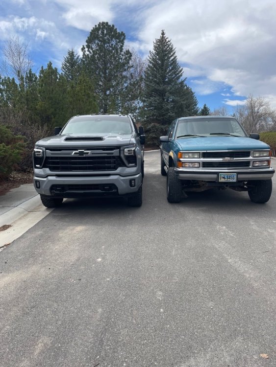

  12. My 2024 LTZ sport gasser with its older brother, 1997 Chevy 3500 CCLB with a 454.
