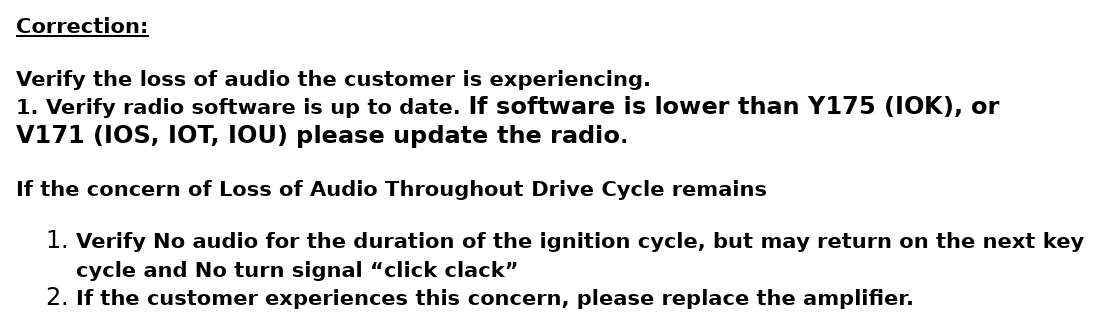

  1. Thanks for the info! You gave me the first breadcrumb to follow. LOL While searching for #PIC6602, I also found #PIT6101Q which says So, I'm going to see if I can check the software version or I might have a bad/intermittent amplifier.

  4. So, got off work, hopped into the truck, started up... no radio, no audio of any kind. Tried the "hold end call on steering wheel for ten seconds", no luck. Called dealer service department, guy said "Huh, yeah. Disconnect negative terminal of the battery for 5 minutes, should fix it." What he didn't tell me was that when you do that, and then reconnect the battery, the horn alarm starts going off. WFT?? Does this happen enough that the service department tells you to "disconnect the battery for 5 minutes", even if you don't carry tools in the truck? Got the alarm to shut off. However, my question is how often does the truck's audio (radio, phone, alerts, etc) just randomly shut off? Tried to call the wife... nope!! No audio at all. Yes, I realize the truck is still under warranty, however, the engine issues seem to take priority.
