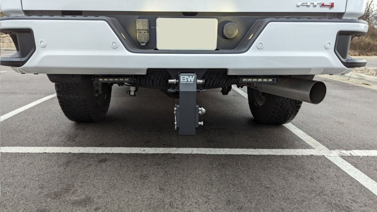

Great tip for sure! I had never thought of that before and then when I took out the tail light to look around I noticed this as well and did the same for my wires! It's certainly an improvement. My only wish was that they had a flood lense on them. While they do light up the night they are more of a throw than a spread. But either way it's a big step up from what it was stock.

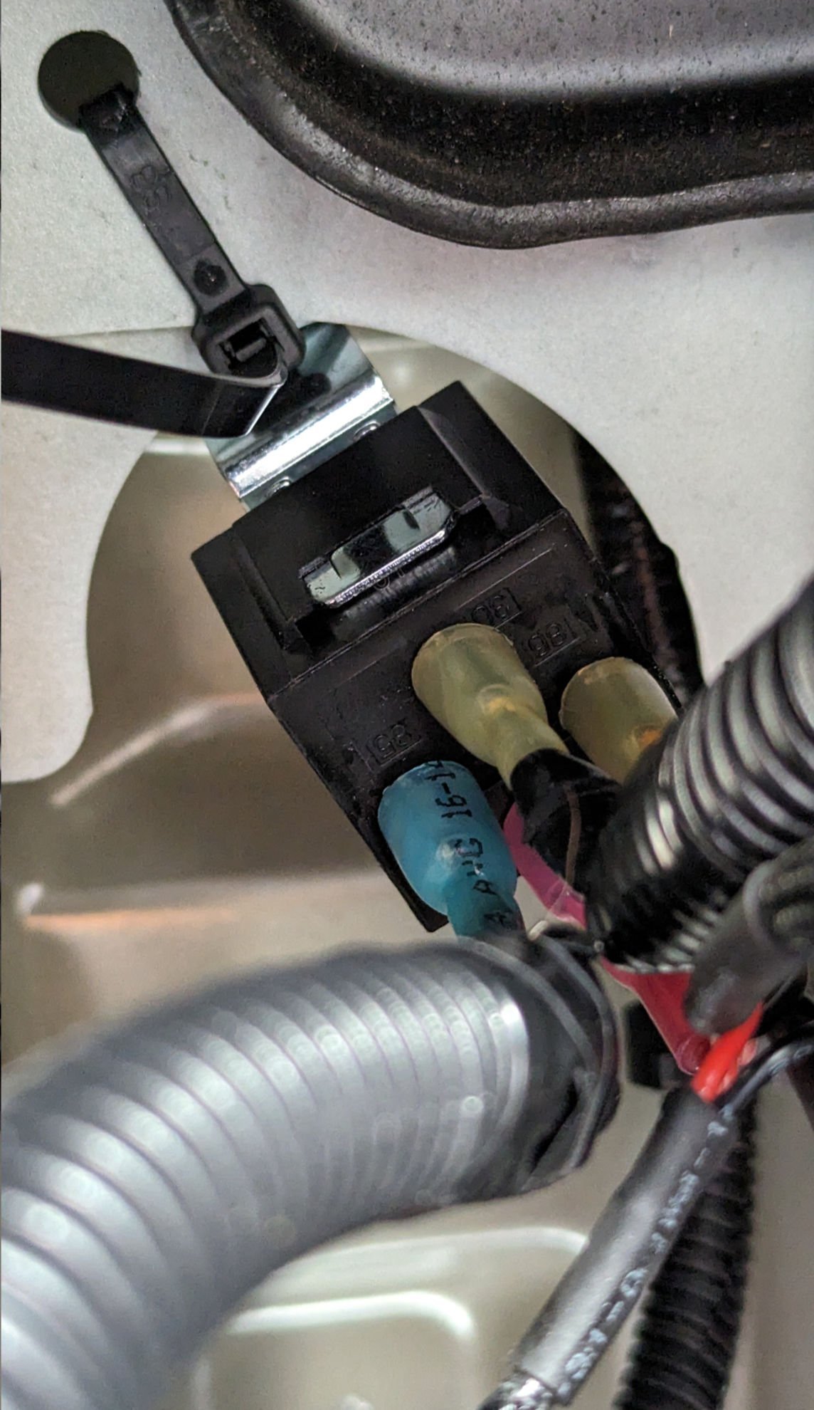

A massive thanks to both @64BAwagon and @gemarsh for guiding my slow self through this process. It toiok me entirely way to long to "get it" than it should have, but the lights are installed and work great. They are bright, but don't seem to be overly bright where it's effecting the camera at all. I made a few position adjustments this morning, so we'll see how it looks again tonight. I like the slim design as they nearly disappear until they turn on. They are going to make seeing using my mirrors much easier! My tail light was a bit different from yours @64BAwagon as I believe the 2023 AT4's are all LED's so I only had a single plug for the tail light. The plug did have a reverse light of course but I didn't see much room to splice how I wanted or to mount the relay. Instead, I went to the passenger side of the truck and where the tail light harness plugs into the truck is where I put everything. Spliced into the backup wire (light green-ish color) on the wire harness to add my backup signal wire to the relay. I soldered the wires together, used 3-to-1 adhesive heat shrink, then wrapped it with electrical tape and wire loom. I did a minor detour from your drawing, where as I put my grounds all off the relay (similar to how the factory rough country harness did). So for the lights I used their wiring plugs and wire, I just cut the wire MUCH shorter. I then connected the grounds and a 12 awg ground together on the relay and the other end of the 12 awg wire to where the spare tire cable clips to the truck. Power was ran from the driver side battery to the back of the truck. Also in wire loom and with a 10 amp inline fuse. The connectors to the relay are all marine grade and heat shrunk, with electrical tape wrapped around the wire and wire loom. Inside the connectors to the relay were filled with dielectric grease. Besides trying to understand all this, the longest parts of doing all of it was running the power back from the battery to the back of the truck and cutting the factory harness wire. I wanted to avoid this so much and keep putting my clipped up to cut it and then stopping. haha I'm happy with the results and feel I shouldn't have any issues with it at all. Thanks again guys! @Pryme I know this probably wasn't for me, but I use 3M 88 tape myself.

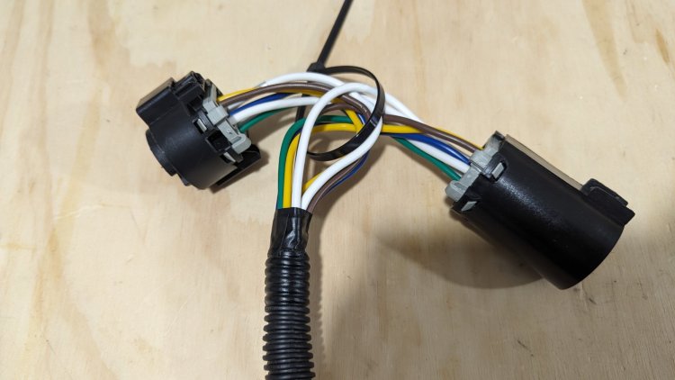

Well you and @gemarsh are both correct - the Curt adapter isn't going to work out like I had hoped. I bought it because I really didn't want to cut into any factory wires and I figured I'd have all my connections I needed right there in the adapter or the 5way T - but neither were the case. After posting the info above about the relay, I went back out and grabbed a test light and nope... I don't have power back there as expected. Even putting with the truck running and in reverse I'm not getting anything from the center pin (reverse light). Because no trailer is connected - just like @gemarsh mentioned. And then it hit me, that makes sense, as I just bought a power adapter for my travel trailer camper for this very reason. The factory 7 way doesn't provide the correct power, and after I bought one of these I had lights and cameras working on my trailer again. So I'm returning the Curt T adapter (good thing I haven't cut into it yet). @64BAwagon that drawing very much helps. I'm a very slow monkey and pictures help out a bunch. haha Seriously, this really does help! So I'm thinking I'll mount the relay under the hood, run the power source to the battery and ground somewhere in the engine compartment. From there I'm wondering, would you think I'd be fine running ground and power from the relay all the way back to the lights? This way I could re-use the wire it came with and use their factory plugs on the light themselves. I also have 16 AWG flexible stranded wire I would run from Post 85 to maybe somewhere in the engine compartment (if possible?) or run it all the way back and sadly tap into the factory reverse light on one of the tail lights. I was planning on soldering and heat shrinking any cuts or connections a 3 to 1 adhesive heat shrink, but I also have plenty of solder heat shrink combo butt connectors I could use. To make connections to the relay, I plan on using marine heat shrink spade and ring connectors.

I apologize, but I think I might be more confused now. The above is a picture of the harness that came with the lights. The wires to the left are battery positive and negative. The two sets of wires to the right are connections for the lights themselves, and the bundle of wires in the middle is the switch. Below is the Curt T harness. The wires going down are the 5 way connector. How would you suggest hooking this up?
Thanks @gemarsh, when you say use the 7 way tee and then start to mention connections to the relay, that's the wires coming off the 5way lead from the 7way T yes? @64BAwagon what do you mean this will tie up the 7way? Will I now be able to use it for my trailer?
