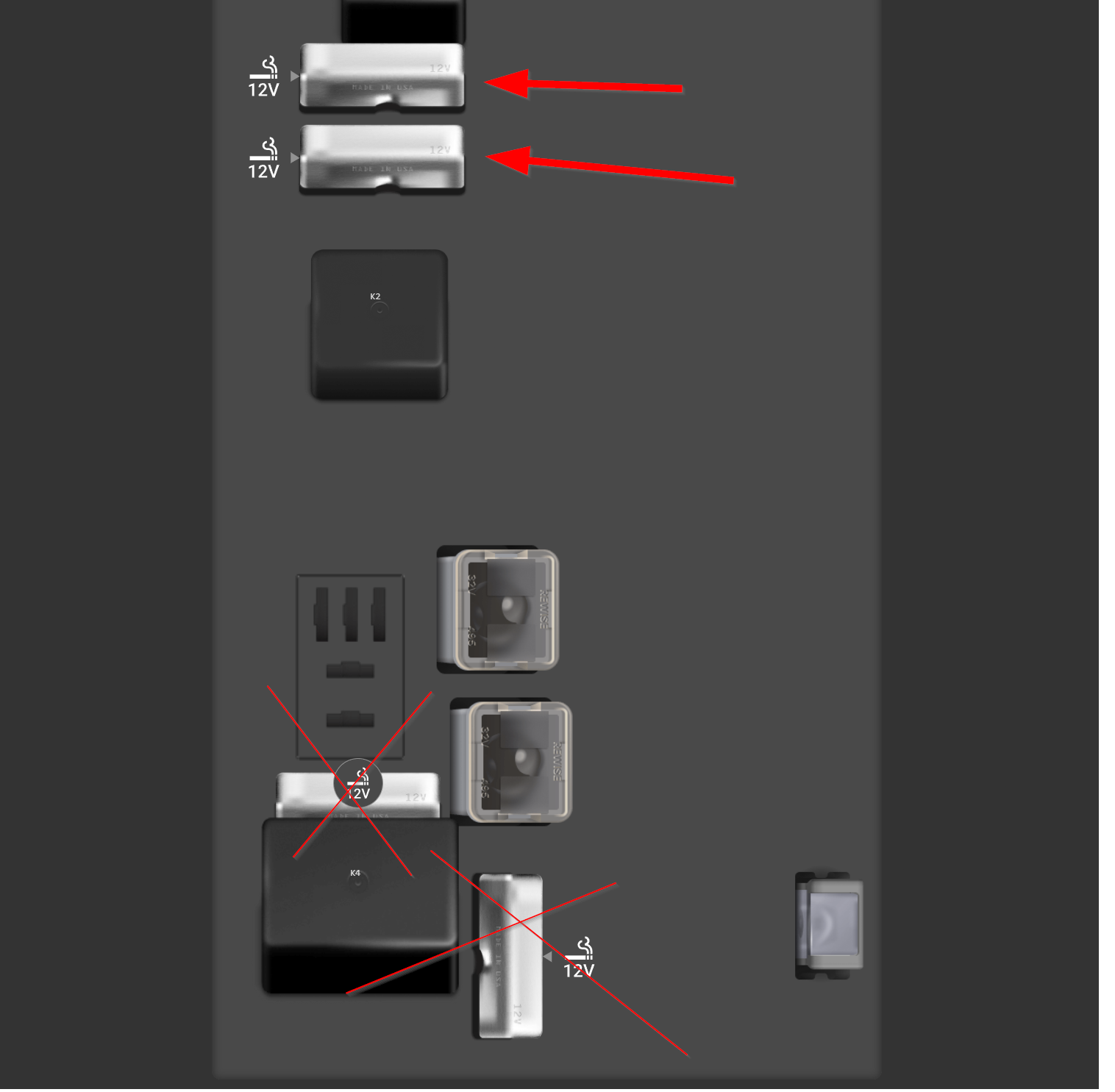

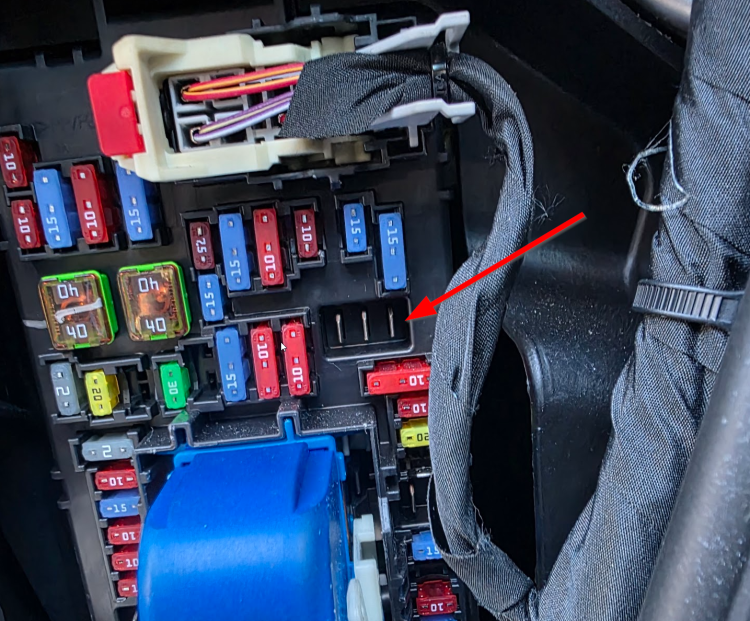

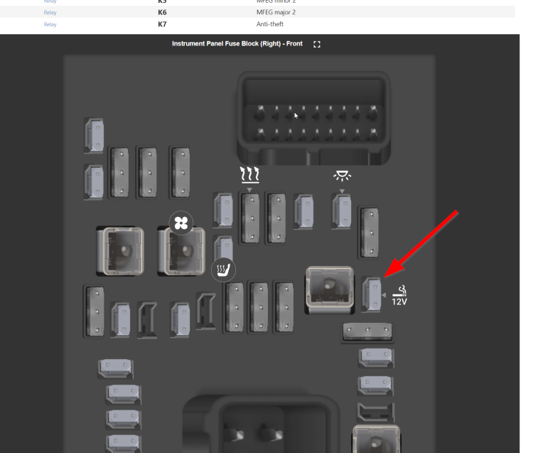

  2. Yep, I have. You hit the nail on the head of what I'm struggling with here. I guess I didn't consider it was a 2 prong fuse that shifted position. It's absent in my first image though so I need to try and source that part, but I also don't know which cigarette lighter it's referring to as there's 2 of them. One on the front dash, and one in the rear. What does RAP power stand for ? EDIT: Retained Accessory Power, got it. Does that mean "On" when in Accessory mode? Trying to find the amperage and a model number of the fuse I need but struggling.
  3. I'm trying to install this: https://boostautoparts.com/products/2019-newer-gm-charging?options=&year=2019&make=GMC&model=Sierra 1500 And before I went ahead and made permanent mods to the trip pieces (drill holes) I decided to try charging my phone before I put it back together and it wouldn't work. Further troubleshooting and neither of my accessory/cigarette lighters function, front or back. All other USB outlets seem to function just fine. This particular device plugs into the accessory/cigarette lighter wiring hardness in back, underneath the two cup holders. Anyway, tried a meter and couldn't get any voltage at either so went hunting for the fuse(s). Found this site (https://www.startmycar.com/us/gmc/sierra/info/fusebox/2019/gen-g5) which seems to explain it well and seems to match my manual but for the life of me, nothing I try works. The manual and the website seem to indicate that F28 could be it, but what I have (passenger side/front/front) doesn't match what I find when I open it up. It's close, but not the same, but still empty. If I flip this around and look at the other side, there's 4 more that seem to match the diagram at least. I don't have fuses/breakers in the bottom 2 slots there which seem to might be for 2021+, but the top 2 I pulled out, tested continuity, and they are fine. Close up shot of them: Am I even in the right ball park here? Anyone else able to check their truck to see if I'm supposed to have the bottom 2 slots filled up? I tried moving the breakers from the top 2 to the bottom 2 and it didn't change anything I could notice. If I'm supposed to have something in F28 in my first picture, it's 3 prongs and doesn't look like what's in my manual.
