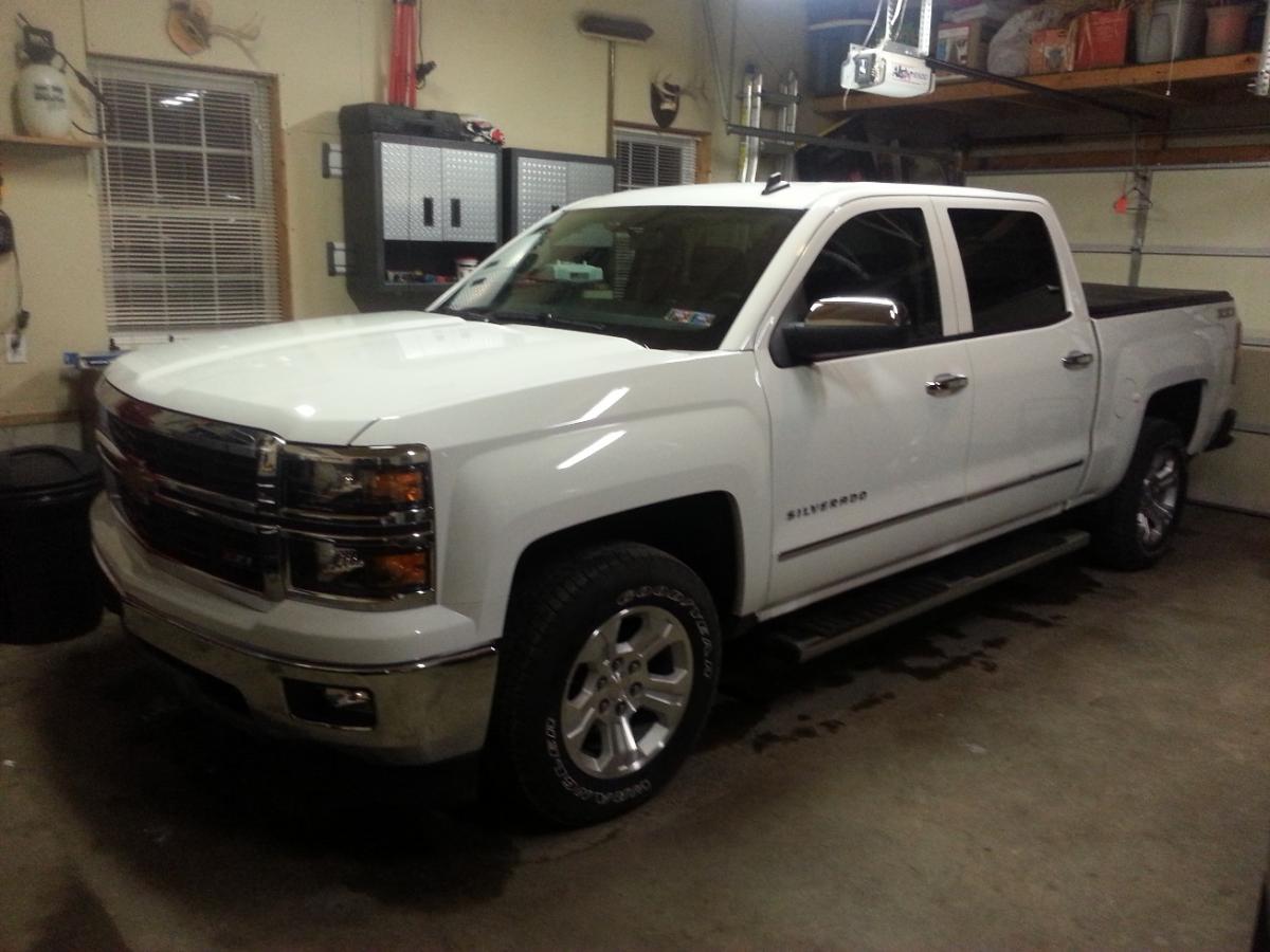

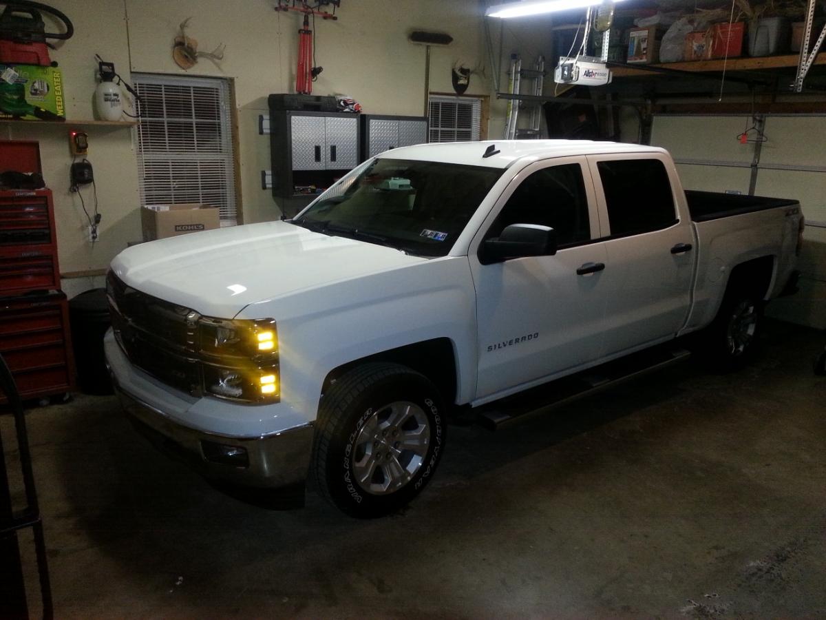

  8. thewhitestalion, well you convinced me ,,,,,,,,well sort of,,,,, to stay with the black window moldings. I think adding the chrome would be too much, probably the same reason you removed yours. Here are pics of my new Silverado, day I brought it home 3 weeks ago and today. I think accessorizing is complete. Well, maybe ...LOL.....WIndow tint is next. 20% over the back window and 35% on front doors....
