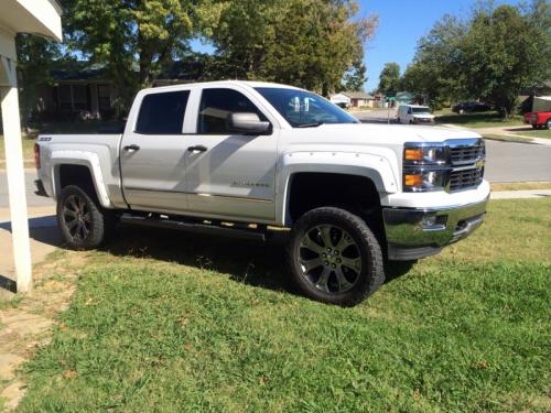

  1. I am back . I posted some videos and links on youtube involving my truck and its shaking and vibrating a couple months back . I had some luck with limiting my shaking on the highway. did a lot of tire balancing and re balancing at a couple different tire shops!! had the driveshaft replaced too . I just got tired of trying to get it completely fixed. I just drive slower and turn the music up louder. so anyways I have been noticing my truck seems to be vibrating worse when idling so when I took it in for an oil change I asked if they could perform the 3mm shim to see if that helps . I even pulled up a link that I found that shows the instructions on how to perform the procedure but they just don't do anything about it. I neeed the dang TSB code everybody is talking about . I wish that truck would just catch on fire sometimes . any help please and thanks!!

  4. Ok just to update on my vibration problems. I decided to take matters into my own hands . I lifted the back of my truck up to see the back tires spinning. low and behold the back left wheel/ tire is wobbling . Not much but it looks like this could be the problem . I pulled the wheel and tire off and had it checked at a tire shop and it seems to be fine . But when I mount it to the truck it wobbles . The problem seems to be with the adapter that is mounted to the trucks factory lug bolts . It seems to be defective . My wheels are chevy 22" wheels . I am going to request some wheels that do not require adapters . I will have an update in a week when I get my truck into service

  11. Well as I was researching the vibration issue some more I decided to make a quick video of my idle vibration . If someone who has a smooth riding truck could create one to show it is not just engine related that would be cool! So here is my truck idle with some vibration .
