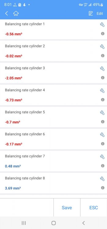

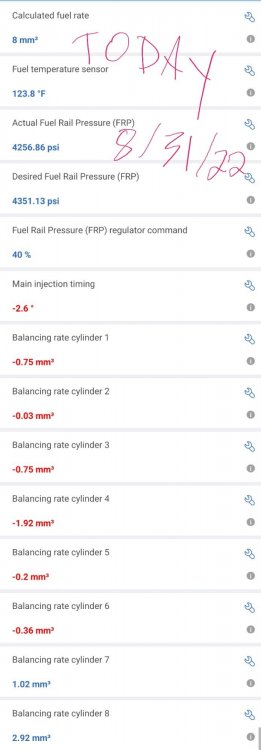

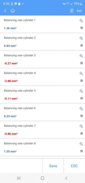

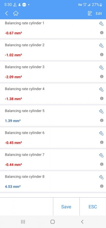

  1. Hey guys so I asked on Facebook and I didn't really get very far so I figured I'd bring it up here. 120,000 mi completely stock. Here's what's going on. so with the converter locked and I believe in 5th gear around 1500 RPM I randomly get what feels like a misfire when applying light throttle until the turbo spools up. I bought this truck from an auction all the glow plugs were bad replaced all those. The truck had some dead battery issues right before it went to auction so I looked at the stored codes but ended up clearing them because a lot of them were communication codes which would be related to a dead battery. All filter replaced, all fluids (except trans and xfer) replaced. I meant to write down the actual codes but one of them was for EGR and the other ones was for glow plugs. I've replaced the glow plugs everything is completely fine as far as that goes. the filter head does like to lose a little bit of prime overnight so if I just fire it up first thing in the morning it'll run a bit rough if I put about two pumps onto the primer it runs completely smooth after start. I have conflicting data from different scan tools some of them are showing the EGR experiencing large error % as far as deviation. My all tell is showing small amount of error (2% at idle) but not enough to trigger a code. Doesn't feel like 605 torque if I'm honest. Pretty sure my 8.1 could out pull it at this point. Here are the fuel numbers Attached is some OBD live data First few are some screen shots. The one with the date is the most recent. Here is a link to the EGR doing it thing last week while I drove around town. Big drive south (AK to AZ) supposed to start tomorrow night. But I don't want it to brake down in the middle of nowhere.
